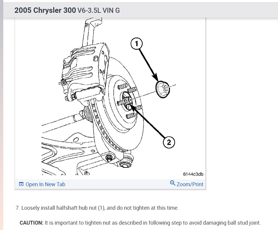

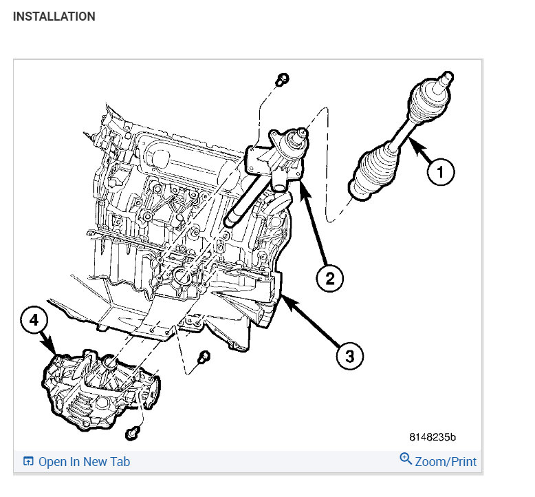

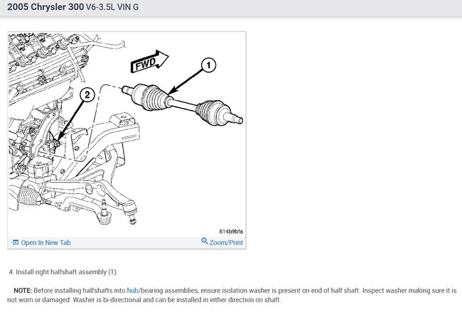

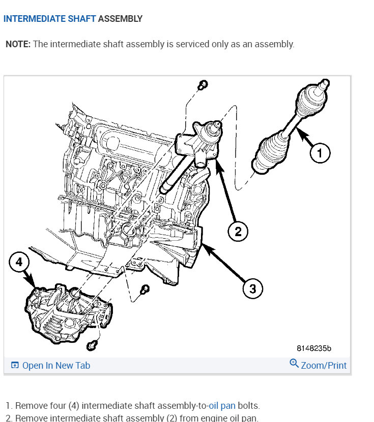

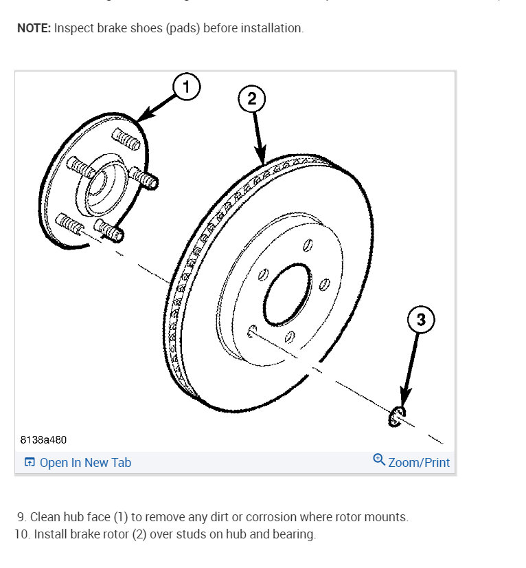

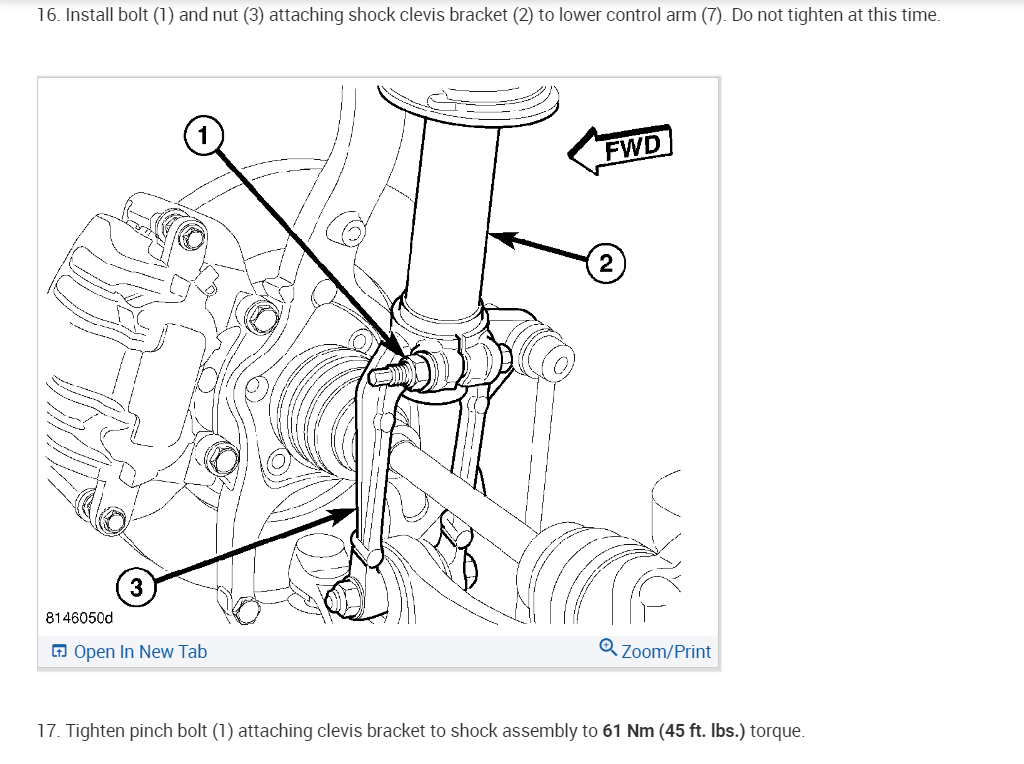

Cv joint axles Car vibration when I accelerate?
2005 CHRYSLER 300
120,000 MILES • 3.5L • 6 CYL • 2WD • AUTOMATIC
GORDON2588
Oct 12, 2022 at 5:52 AM
  • 55,433 POSTS

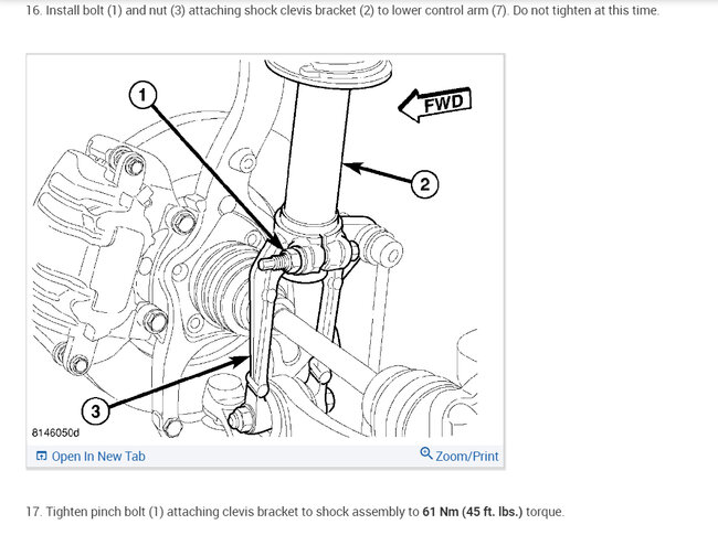

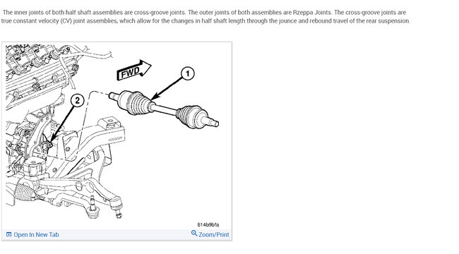

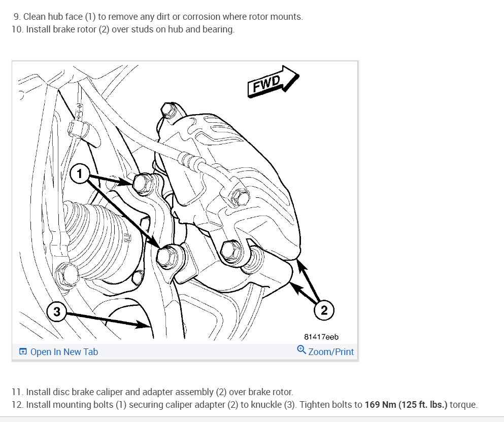

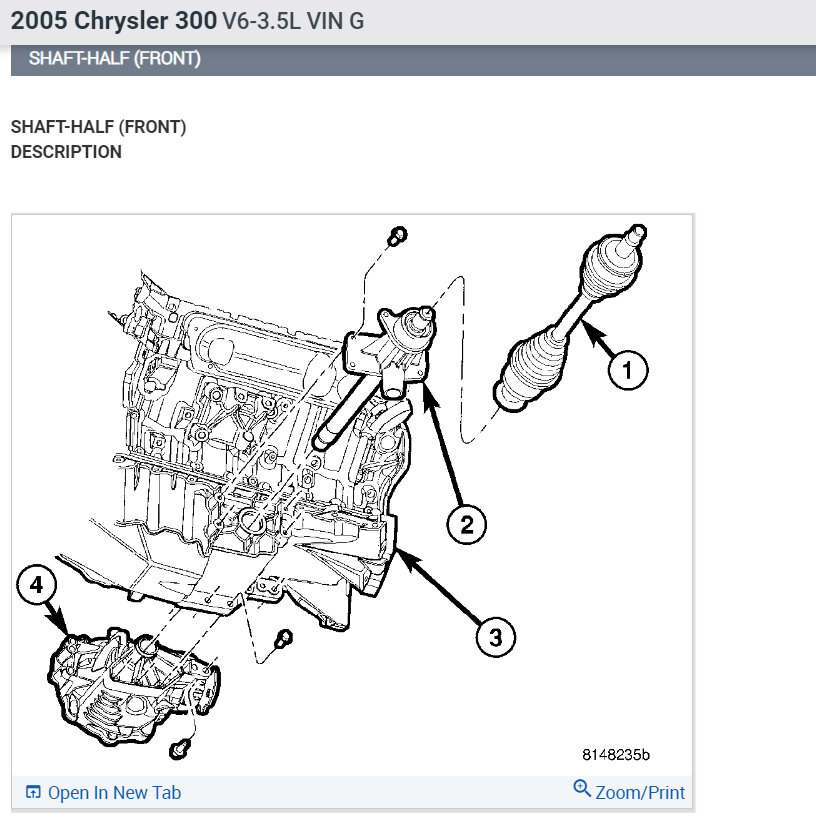

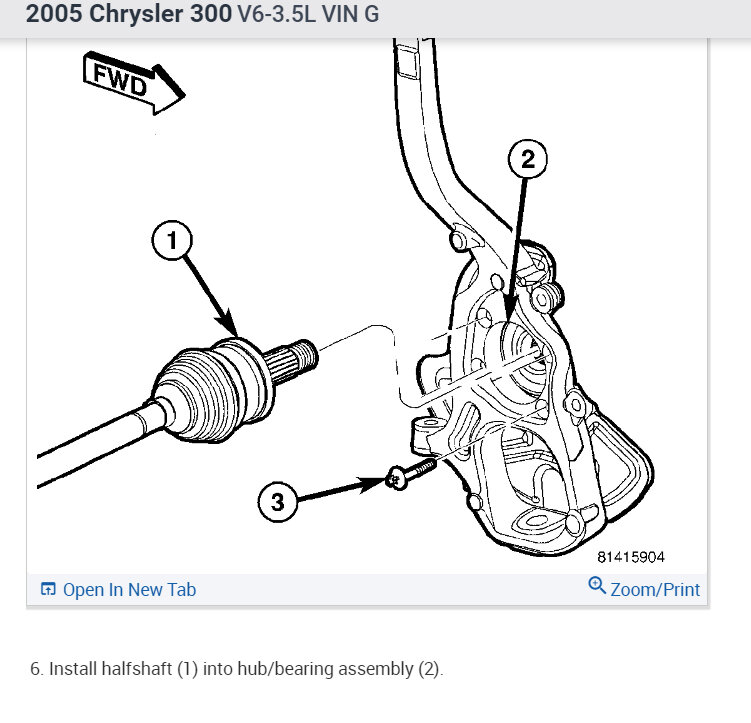

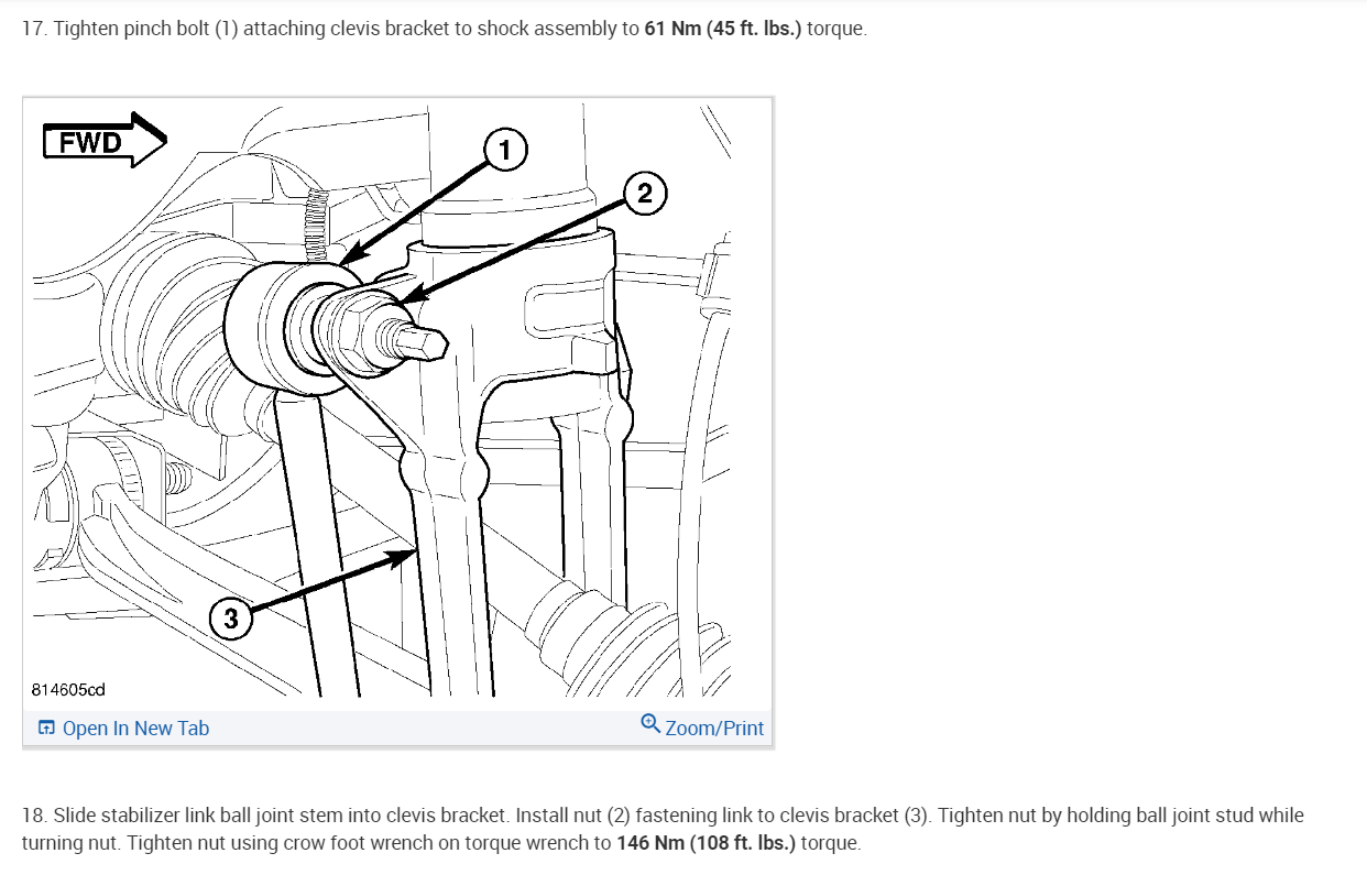

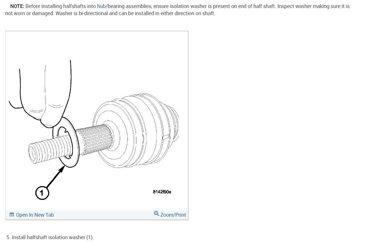

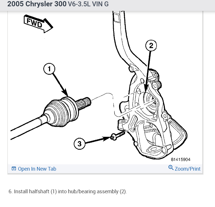

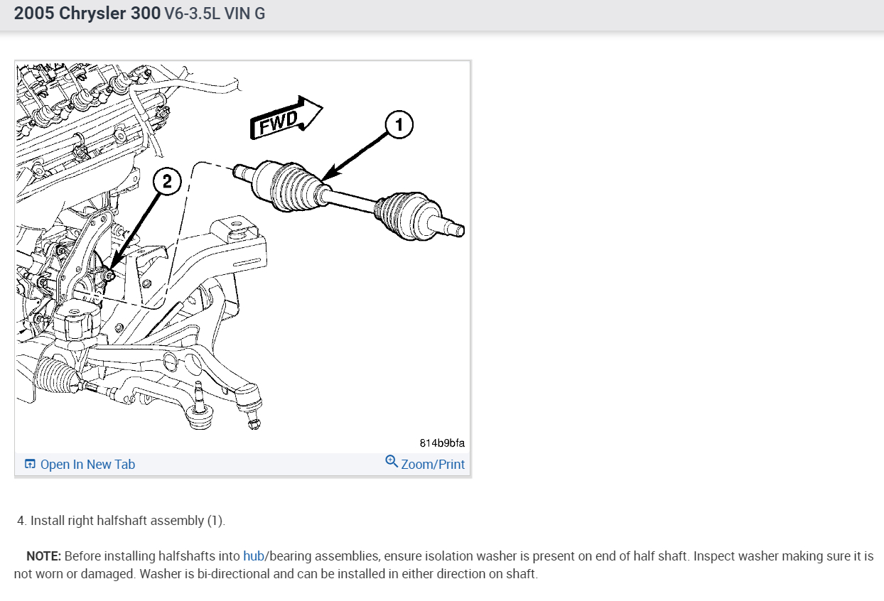

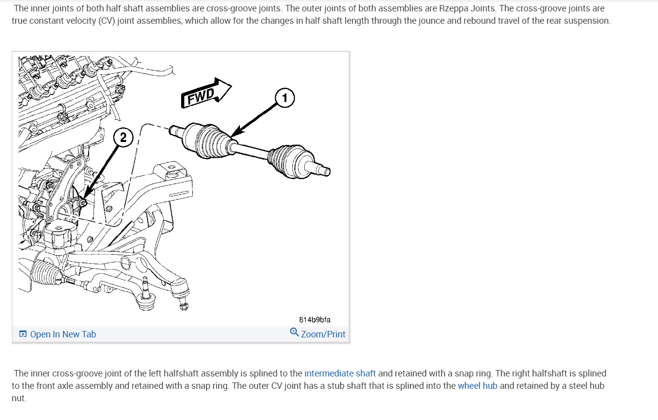

Yep, this is common when the CV axles need to be replaced.
Here is a guide to help walk you through the job with instructions in the images below:
https://www.2carpros.com/articles/replace-cv-axle
Check out the images (below). Please let us know if you need anything else to get the problem fixed.
