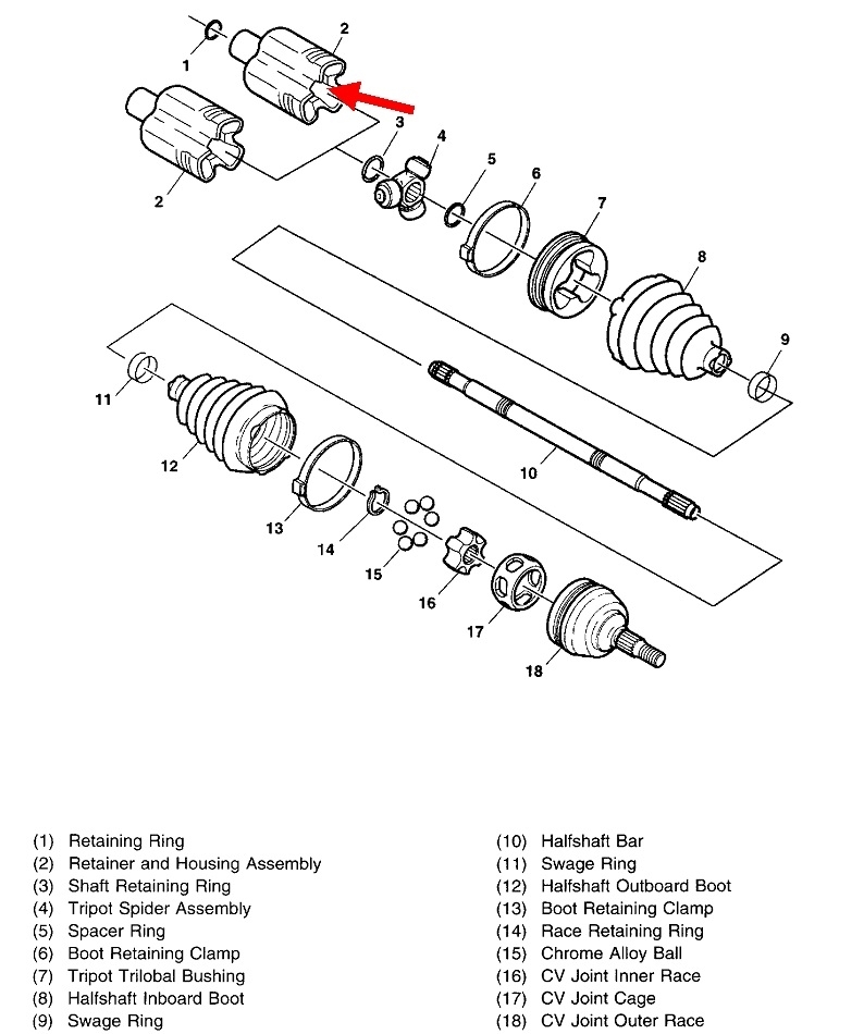

This drawing shows the exploded view of the half shaft. Items 1 through 9 are the inner joint. They don't show the spring I mentioned. My red arrow is pointing to where it is.

Well, I guess the morrow will tell the tale then. Thank you very much for your assistance and the picture, diagram.
