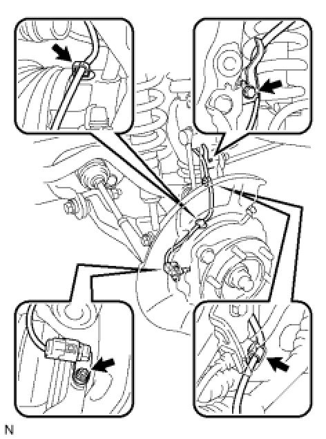

4. SEPARATE FRONT SPEED SENSOR
pic1
(a)Remove the bolt and separate the front speed sensor.
(b)Disengage the 2 clamps.
(c)Remove the bolt and separate the speed sensor wire harness from the steering knuckle.

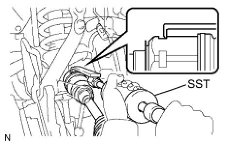

5. SEPARATE TIE ROD END SUB-ASSEMBLY
(a)Remove the cotter pin and nut.
(b)Using SST, separate the tie rod end from the steering knuckle.
pic 2
SST : 09628-62011

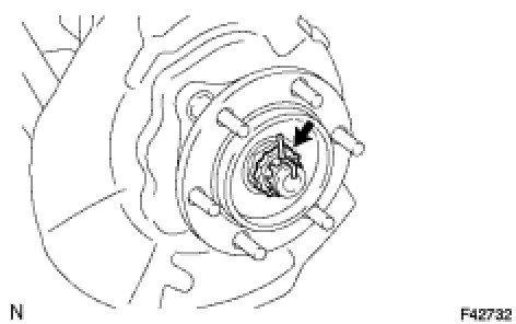

6. REMOVE FRONT AXLE HUB NUT
pic 3
(a)Using a screwdriver and a hammer, remove the front axle hub grease cap.
(b)Remove the cotter pin and adjusting cap.

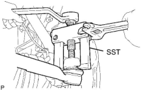

pic 4
(c)Remove the front axle hub nut.

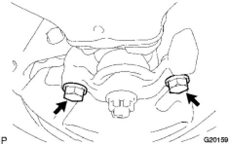

7. SEPARATE FRONT SUSPENSION LOWER ARM
pic 5
(a)Remove the 2 bolts and separate the front lower ball joint attachment front from the steering knuckle.

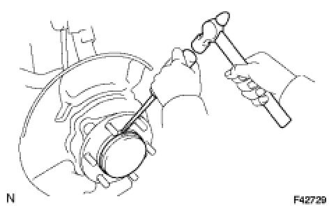

8. REMOVE FRONT DRIVE SHAFT
pic 6
(a)Using SST, remove the front drive shaft.
SST : 09520-01010
SST : 09520-24010
09520-32040
NOTICE:
Be careful not to damage the oil seal.
