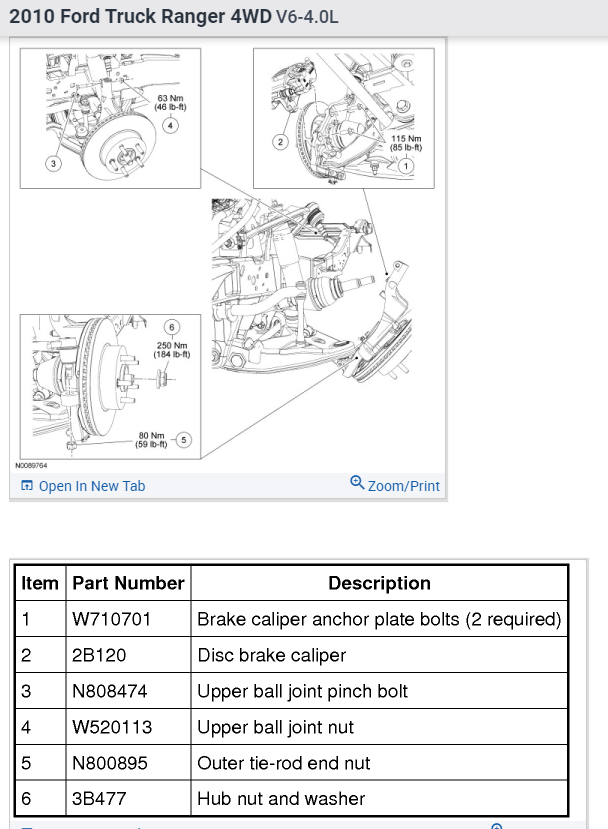

Out of four wheel drive passanger side cv disengage but drivers side wont.

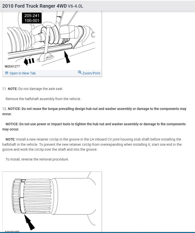

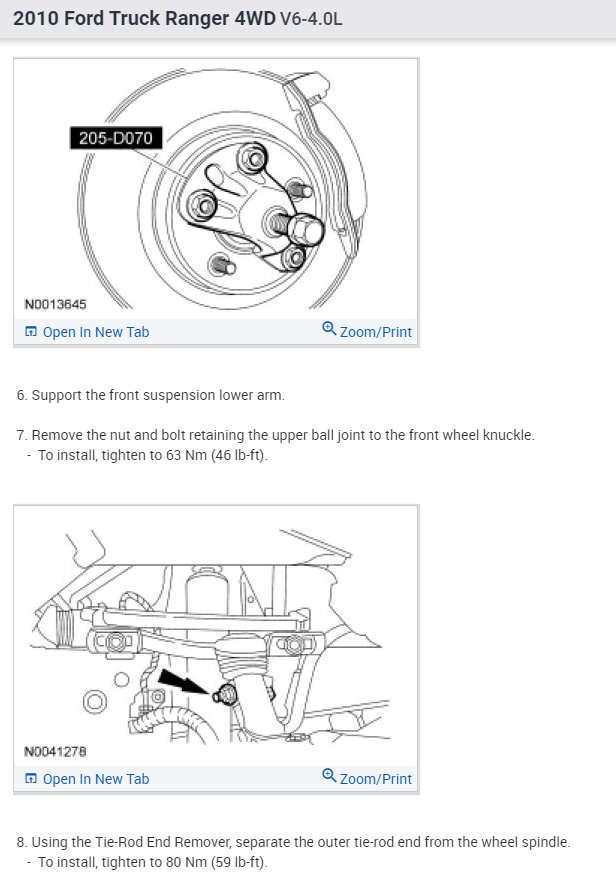

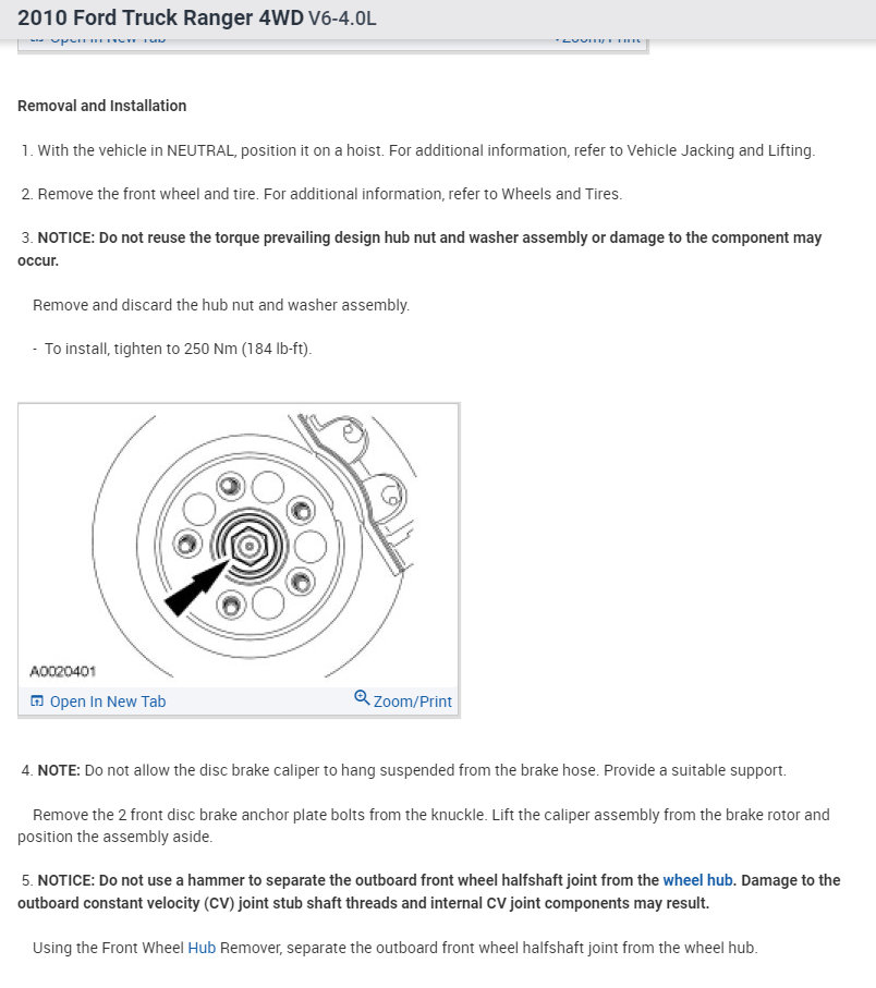

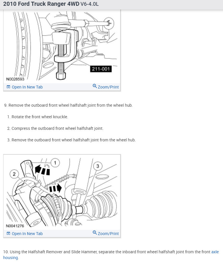

After you remove the hub there is nothing keeps the CV axle in place. It will simply pull out of the housing.
Here is a helpful video, it is on a F150 but the setup is similar to your vehicle:
https://youtu.be/PNSWxzqrRK0
https://www.2carpros.com/articles/how-a-cv-joint-works

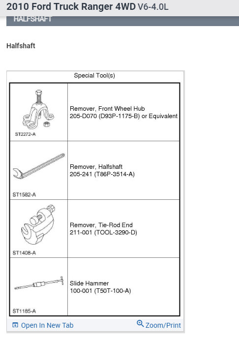

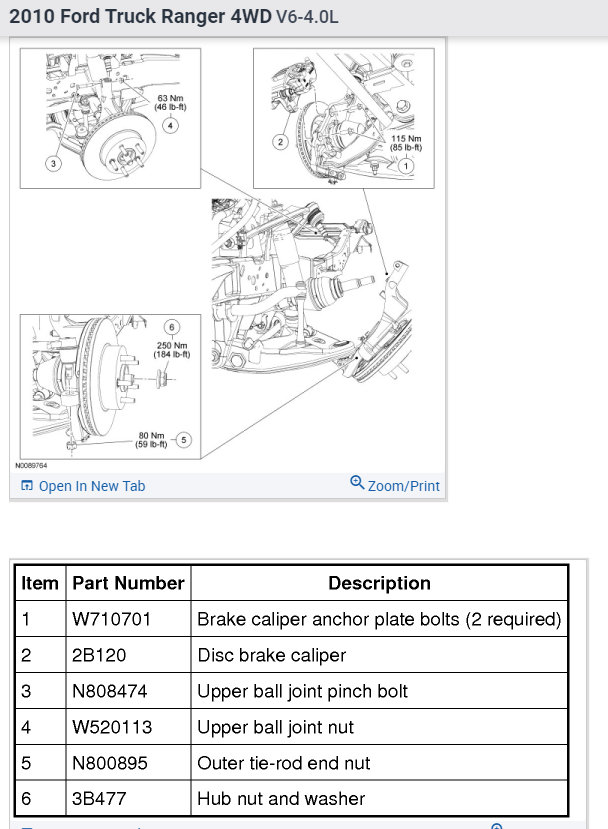

I have attached the replacement procedure just in case there was step might have gotten missed.
