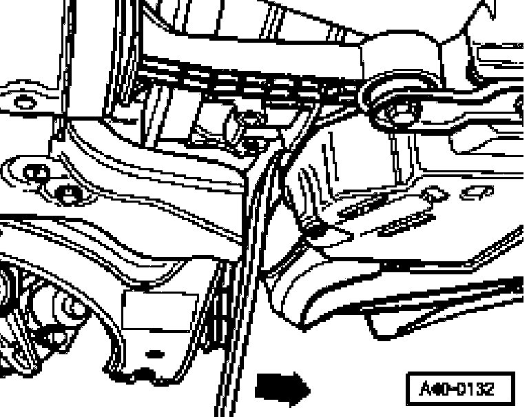

The axle assembly needs pried from the transmission. There is a clip that helps hold it in, but you can't remove it because it is inside.
I assume your vehicle doesn't have the flanged mount. If you look at the last pic, I circled the clip that is helping hold it in. When you reinstall it, make sure that the axle is fully installed otherwise, the vehicle won't move and you won't have park.

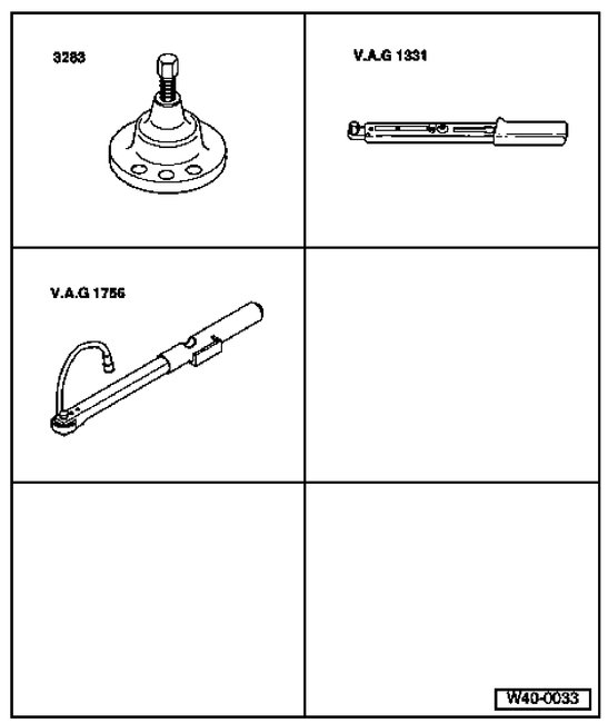

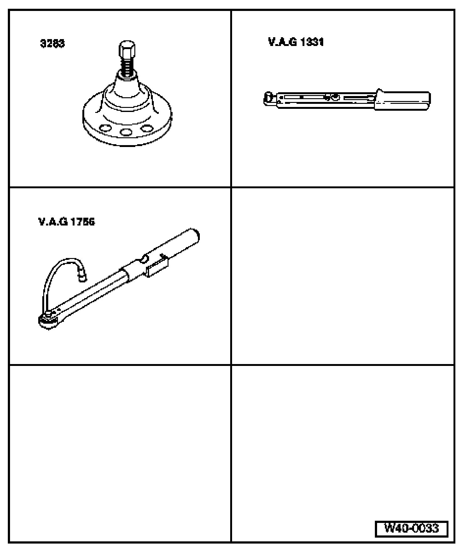

Special tools and equipment
^ 3283 Hub puller
^ VAG 1331 Torque wrench
- VAG 1756 Angle measuring wrench

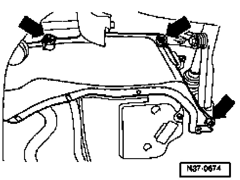

pic 2
- Remove noise insulation panel -arrows-.

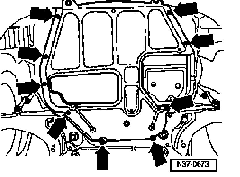

pic 3

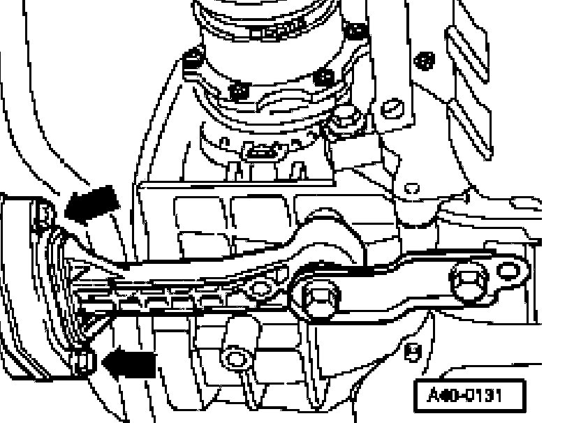

- Remove left-side noise insulation -arrows-.
Vehicles with TDI engine
- Remove intake air duct between charge air cooler and turbocharger.
Continued for all vehicles
- Remove right-side noise insulation.

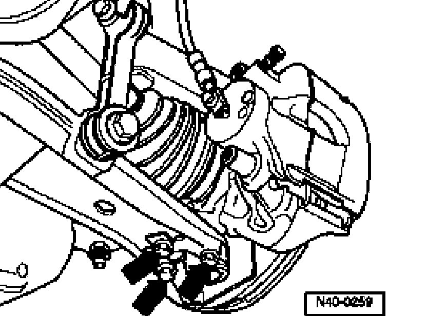

- Mark installation position of ball joint bolts on control arm.

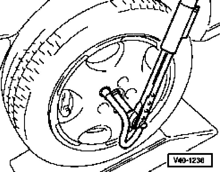

pic 4
- Remove bolts -arrows-.

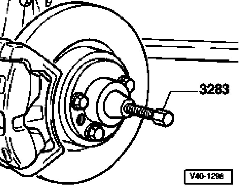

pic 5
- Press drive axle out.
Note:
^ When pressing the drive axle out make sure that sufficient clearance is available.
^ Do not allow axle shaft to hang by inner CV or triple-rotor joint to avoid damaging bearing surfaces. Tie drive axle to stabilizer bar or other suspension component if it is to remain attached to axle flange.
^ Do not flex inner CV or triple-rotor joint more than 25 ° from its original angle.
- Remove drive axle.

- Push engine/transmission assembly forward (i.e. using lever).
Now the triple roller joint drive axle can be removed
(The arrow in the illustration points forward)

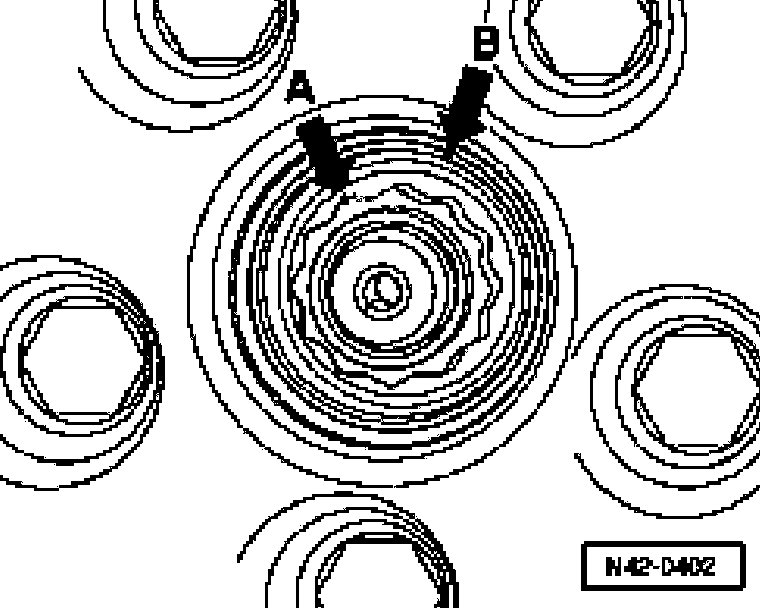

- Mark point on nut with line -arrow A-.
- Mark a 2nd. line (arrow B) on the edge of the wheel hub above next point.
- Turn 12-point nut further until both lines align.

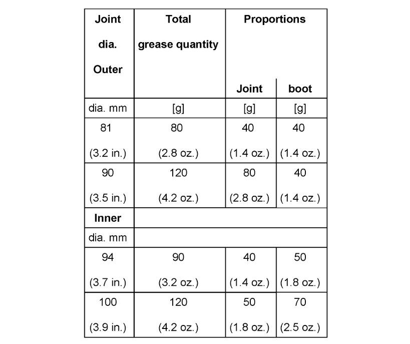

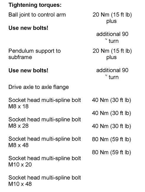

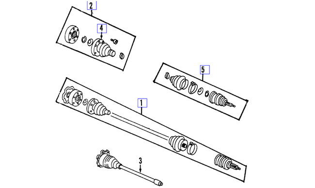

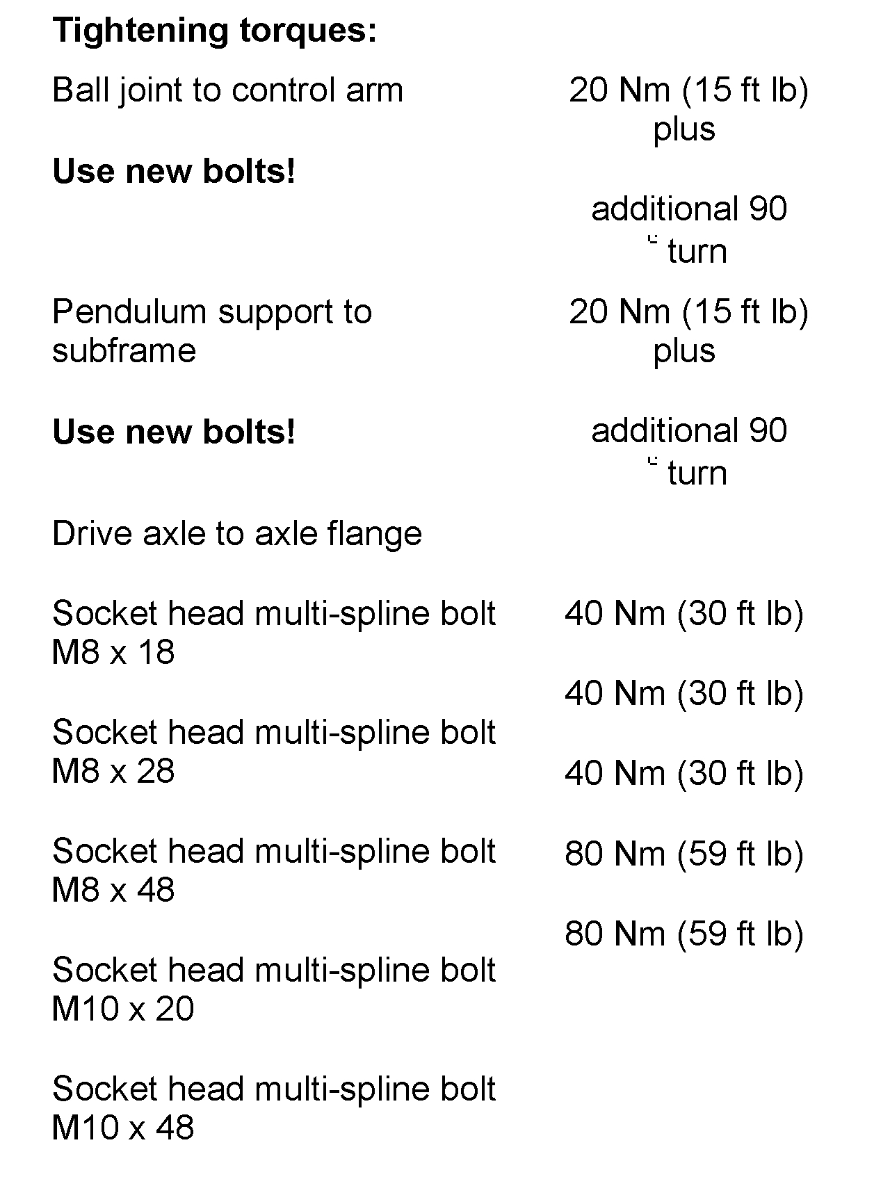

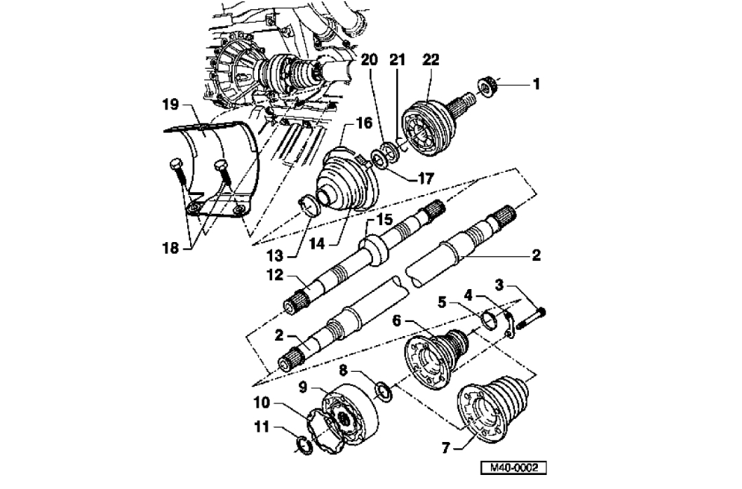

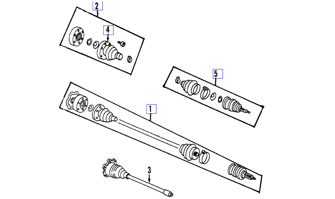

It has bolts holding the axle onto the transmission output shaft remove the bolts and the axle will part from the transmission and then remove axle shaft. I'm attaching exploded view of the front axle and specs below. let us know if this is helpful or if you need more information.
^ M 8 x 48: 40 Nm (30 ft. lbs.)
^ M 10 x 48: 80 Nm (59 ft. lbs.)
