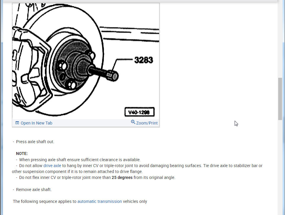

CV axles, lower ball joints, and inner and outer tie rods removal and reinstall new
2001 VOLKSWAGEN JETTA
110,219 MILES • 1.8L • 4 CYL • TURBO • 2WD • AUTOMATIC
MOUSE357
  • 58 POSTS
The easiest way to remove and reinstall my CV axles, lower ball joints, and inner and outer tie rods. All new parts. Also is there anyway to get the lower ball joints to release without having to remove the control arm?? Not replacing the control arm. If anyone could please help me... Thank you for your time.

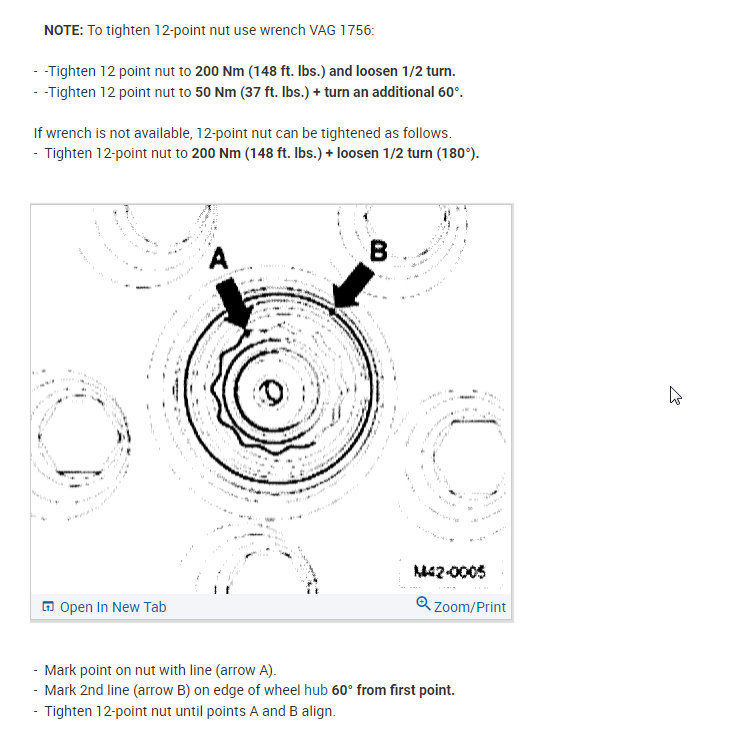

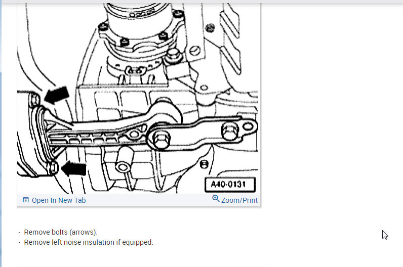

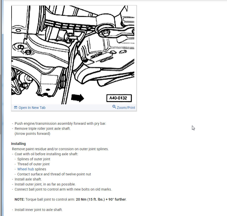

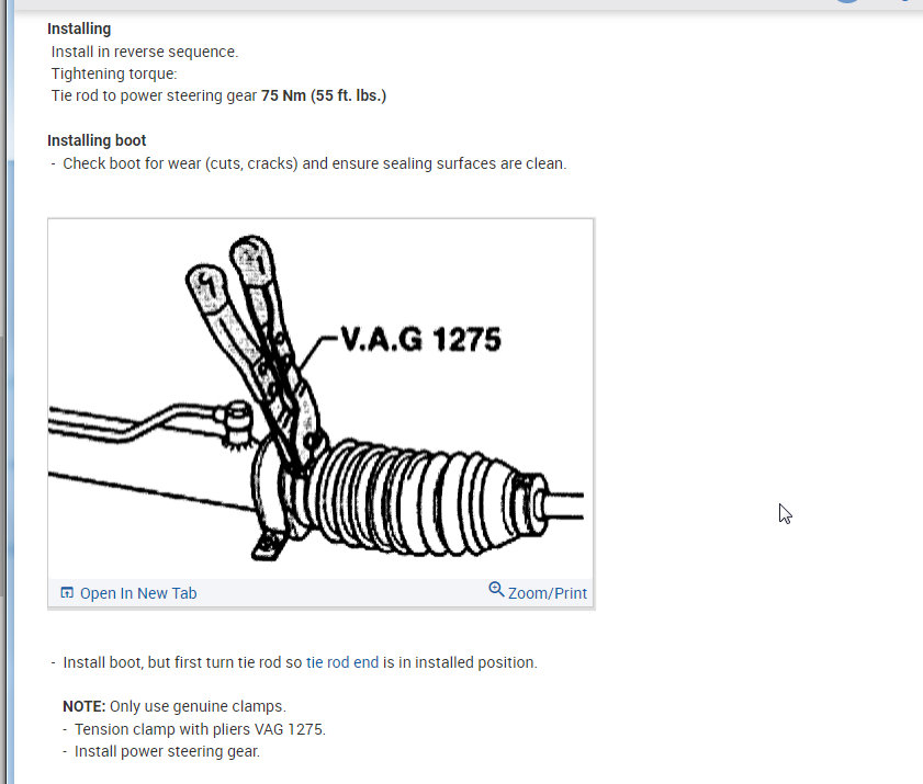

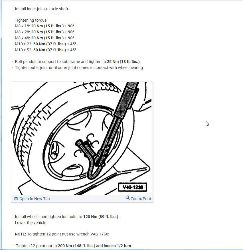

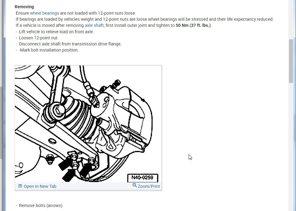

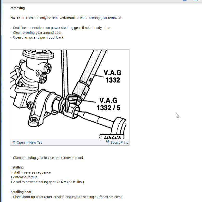

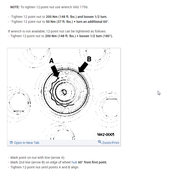

Maybe getting some pictures will help with this but I attached the info from the manual below on how to replace the axle and tie rods.
Here is a guide that will help with this as well:
https://www.2carpros.com/articles/replace-cv-axle
Let us know if you can get some pictures of what you are dealing with and that will help with this.
