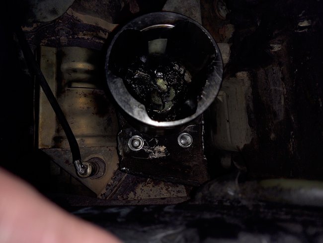

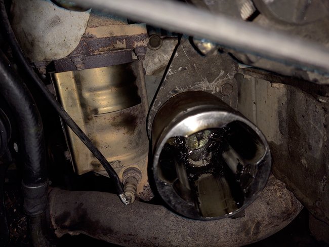

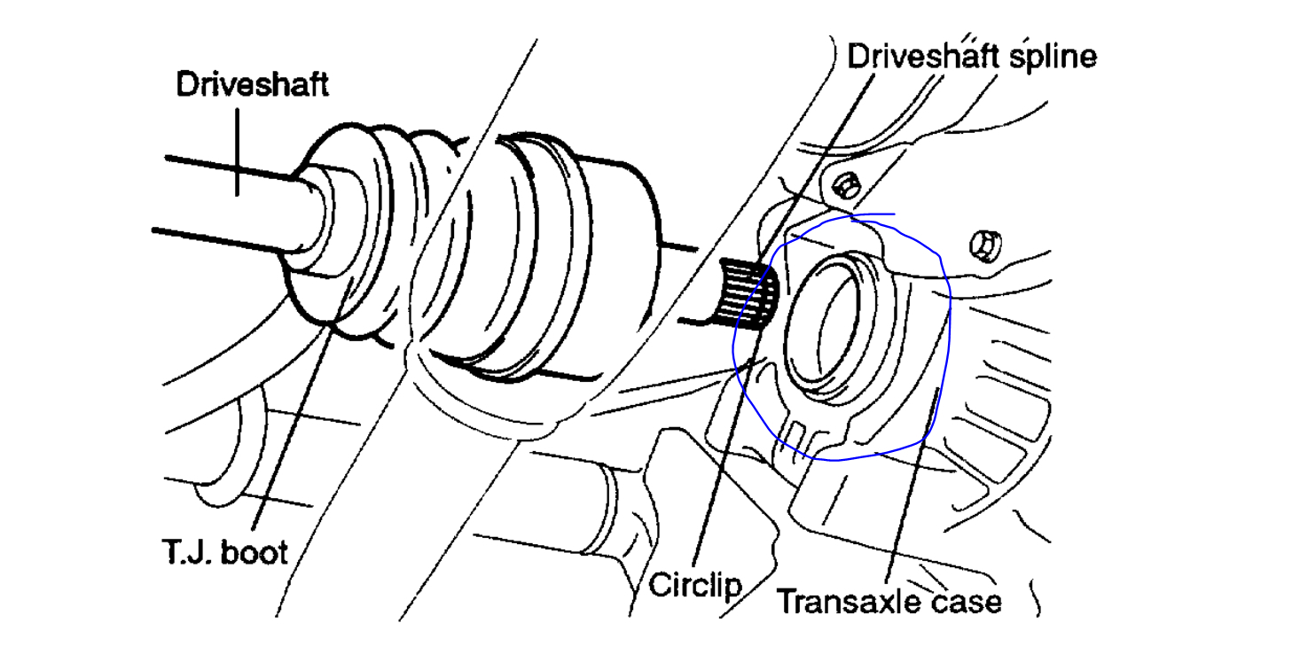

The front passenger side CV axle won't come out of the transmission. There is a bracket around it that looks almost like a brace between the motor and the transmission. It isn't thick enough to have any bearings, just a plate, but could that be why?

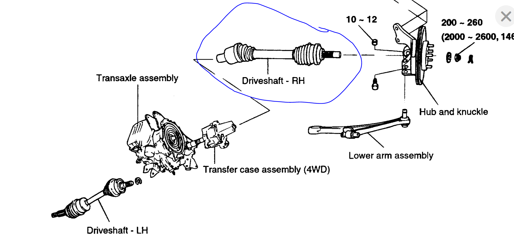

So I tried to send a picture, but the one you sent is not a match. I have the vehicle on stands, drivers side replaced already. It is an all wheel drive not 4x4 does that help? 3.5l 6 cylinder. I removed the entire axle from the second boot out to the tire (all that's left is the metal connected to the shaft going into the transmission).

Here

Thank you for the pictures.
The inner snap ring on the inner joint is being stubborn.
You need to pry, which I see you have, between the axle and the transmission. You may need a bigger pry bar.

Tried bigger bar. Also tried driving wedges between axle and housing. Nothing worked.

Do you have access to an air hammer? Sometimes the shock of an air hammer will release the clip.
You will need a portable compressor and an air hammer with a punch in the end.

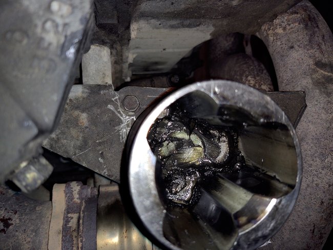

So I got it out finally, the new one slides in easy but doesn't catch on the clip so it slides right back off.
Nov 26, 2020 at 10:55 AM
Okay, then the C clip will have to be replaced.
If it does not lock onto the clip, the axle will keep coming out causing the car not to move.
It most likely got damaged from the removal.

I tried the dealer and after a lot of back and forth with them trying to decide which clip I was referring to (I even texted pictures of the transaxle) they finally claimed they knew which clip I needed and that it was only sold in a kit which is $400.00 and unavailable to them.. I was told aftermarket was my only avenue. Hence why I asked if you knew the number. Also, should that seal on the transaxle press in tight or does it just stay in place once the axle is fixed in place with the clip? It fits nicely over the CV axle, but no super tight if the axle is removed and I just place it on the transaxle housing by itself.
Nov 29, 2020 at 1:07 PM
The seal is a press fit into the transaxle assembly itself.
It should fit tight over the axle shaft itself.
As far as the part number, I could not find it and neither did the dealer. It must be part of the output shaft of the transaxle.
I would visit a transmission shop and explain the issue to them and tell them what you need. They remove and install the axles all the time and may have the clips there for you to replace.
