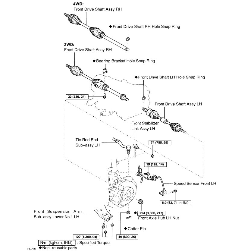

In your excellent video, it appears the shaft is for an AWD vehicle. My shaft is longer on the input side as I have a FWD vehicle.
I looked up the part number you mentioned, but the website is not functioning properly.
Question: Is the shaft you installed for an AWD or FWD vehicle?
Many thanks!

It was the passenger's side axle. I don't think it has AWD, but you never know, here is the video in question:
https://youtu.be/F7CsYAG4w3M?si=PGakc5ZrDZCqXvDJ
Here is the part number for the FWD right side axle.
1 - Axle Assy 434100E020 $1276.99 OEM
Check out the images (below). Let us know if you need anything else.
