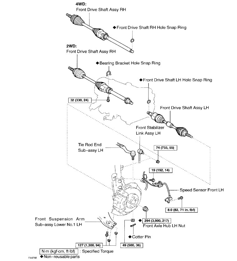

In your excellent video, it appears the shaft is for an AWD vehicle. My shaft is longer on the input side as I have a FWD vehicle.
I looked up the part number you mentioned, but the website is not functioning properly.
Question: Is the shaft you installed for an AWD or FWD vehicle?
Many thanks!
James

Hi James,
I'm not 100% certain which video you watched. Let me know what side you are replacing, and I'll get you the directions specific to your vehicle.
Also, in most cases, if you are working on the front of the vehicle, the process is basically the same, but I would feel more comfortable providing the directions.
joe
Jul 25, 2024 at 2:14 PM
  • 55,399 POSTS
It was the passenger's side axle. I don't think it has AWD, but you never know, here is the video in question:
https://youtu.be/F7CsYAG4w3M?si=PGakc5ZrDZCqXvDJ
Here is the part number for the FWD right side axle.
1 - Axle Assy 434100E020 $1276.99 OEM
Check out the images (below). Let us know if you need anything else.
