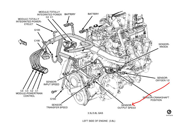

I replaced both front CV axles and my speedometer does not work. Transmission shift through all gears. I did have to reseat the driver's side axle. First attempt wheels did not move.

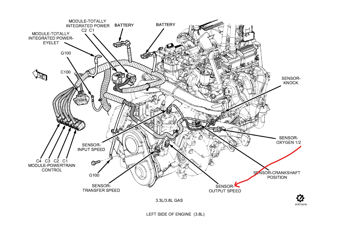

You may have bumped the VSS and disconnected the wiring connector when doing the job, here is the location so you can check it out in the images below. The sensor is near the drivers side axle. Check out the images (below). Please let us know what happens.
Oct 12, 2022 at 4:02 AM
ROBERTBJONES
text states the VSS is near the passenger side axle, but the diagram, red arrow, points to the output speed sensor on the driver side. I need clarification.
Oct 12, 2022 at 6:23 AM
  • 55,224 POSTS
My bad it is corrected, it is on the drivers side.

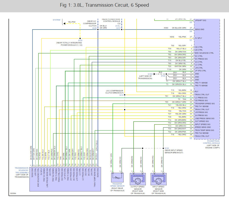

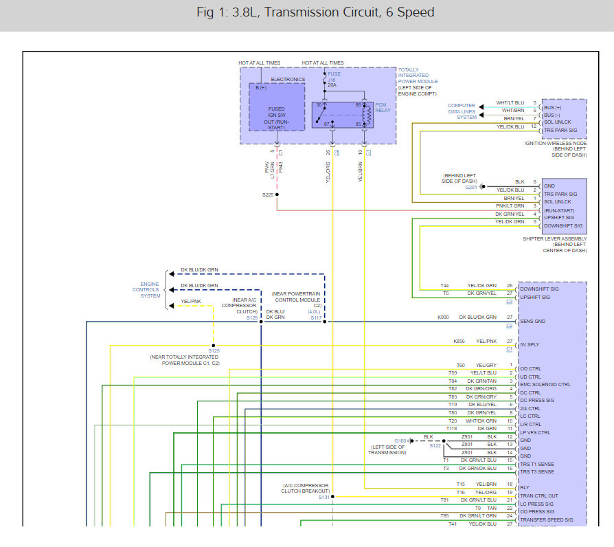

I replaced both Inner and Outer speed sensors. The cable and connectors look fine. Still no speed on the speedometer. Can you provide a diagram that shows the signal paths for the whole VSS system?
Oct 16, 2022 at 7:21 AM
  • 55,224 POSTS
Sure, here are the wiring diagrams for the VSS or output speed sensor as it is referred to in the wiring diagrams. Can we read the codes to see what comes up?
