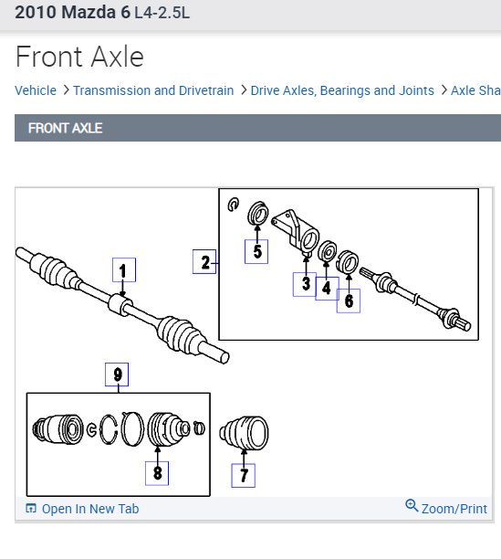

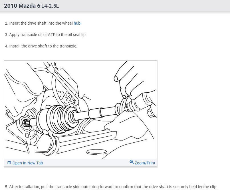

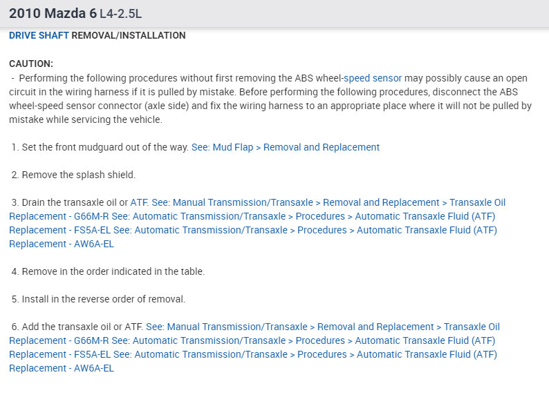

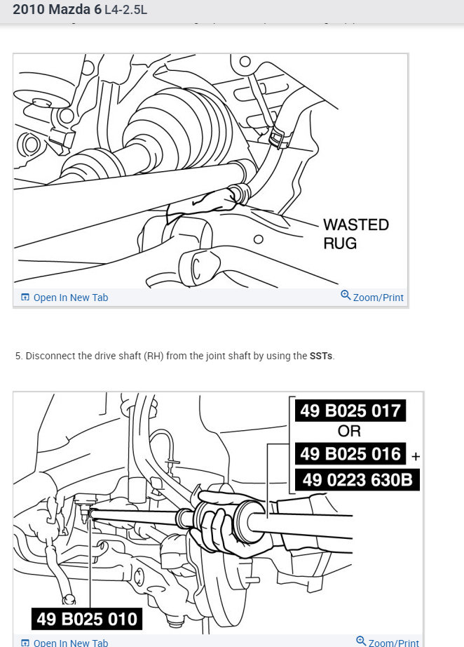

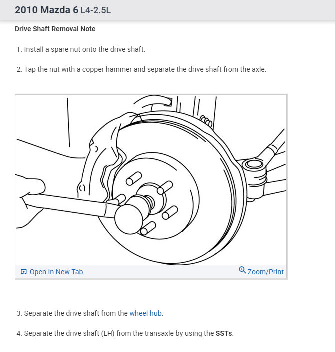

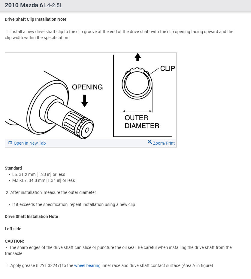

It is time to replace the CV axles on my vehicle listed above i Touring. I can hear the clicking when going in reverse and there seems to be a vibration that is not caused by an imbalance of the tires at high speeds. When replacing the CV axle, what else will I need to replace, and do you have any recommendations as to what else I should replace when doing this work? I love this car and intend on keeping it for quite a while. Thank you in advance. Zoom, zoom.
May 17, 2022 at 4:12 PM
SQM
  • 6,383 POSTS
There are no certain items that will need to be replaced when you are changing the CV axle. It will all depend on the overall condition of other suspension components.
Do an inspection of the tie rod ends, control arm bushings and other joints and check for excess play.
Take a look at this guide, it covers the typical areas to look for:
https://www.2carpros.com/articles/popping-noise
Here is a guide on CV axle replacement:
https://www.2carpros.com/articles/replace-cv-axle

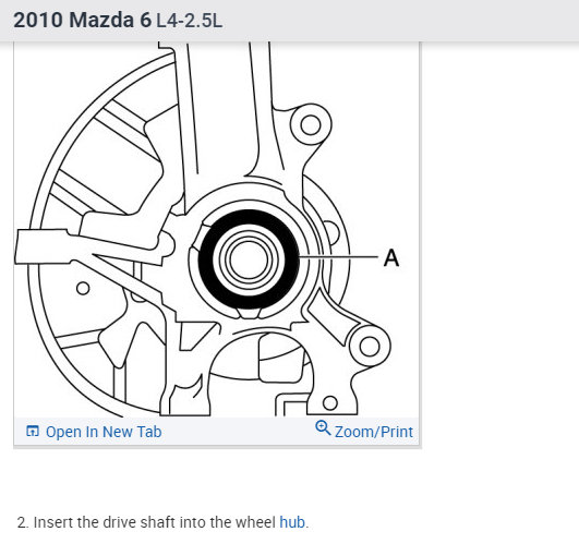

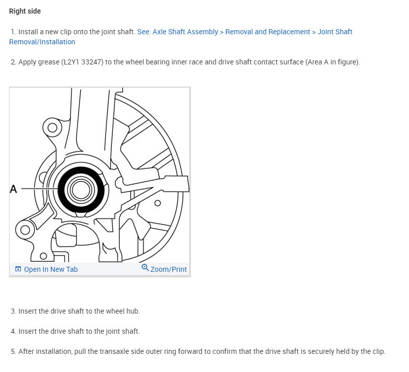

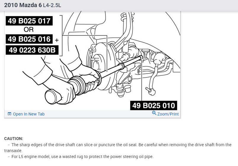

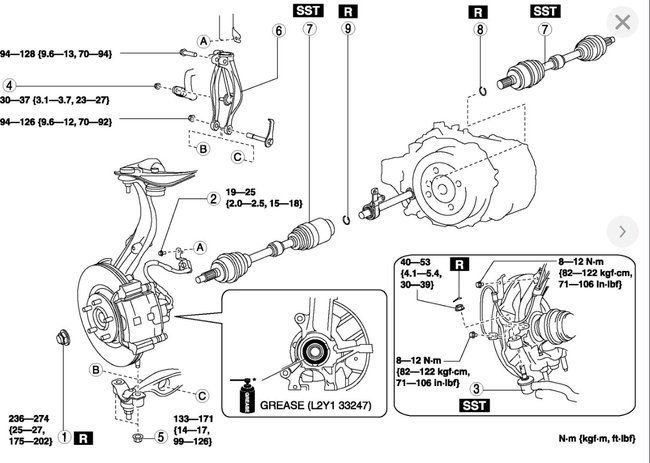

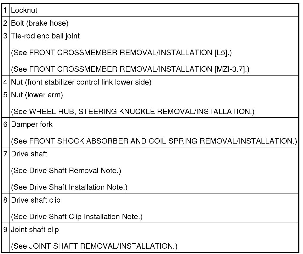

I have attached diagrams below for your reference.
Let me know of any questions.
