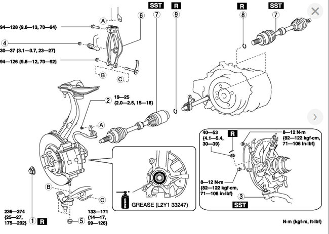

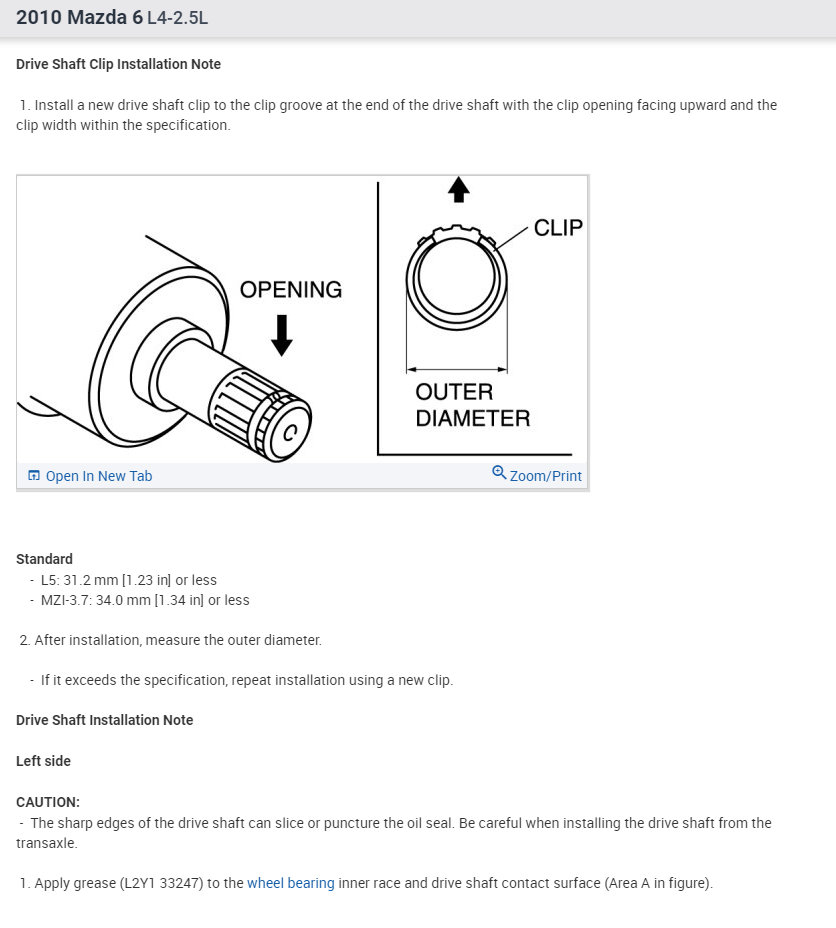

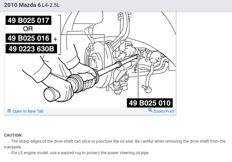

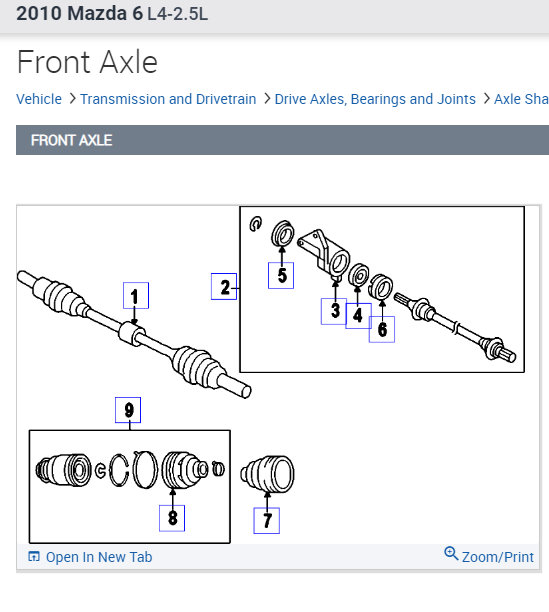

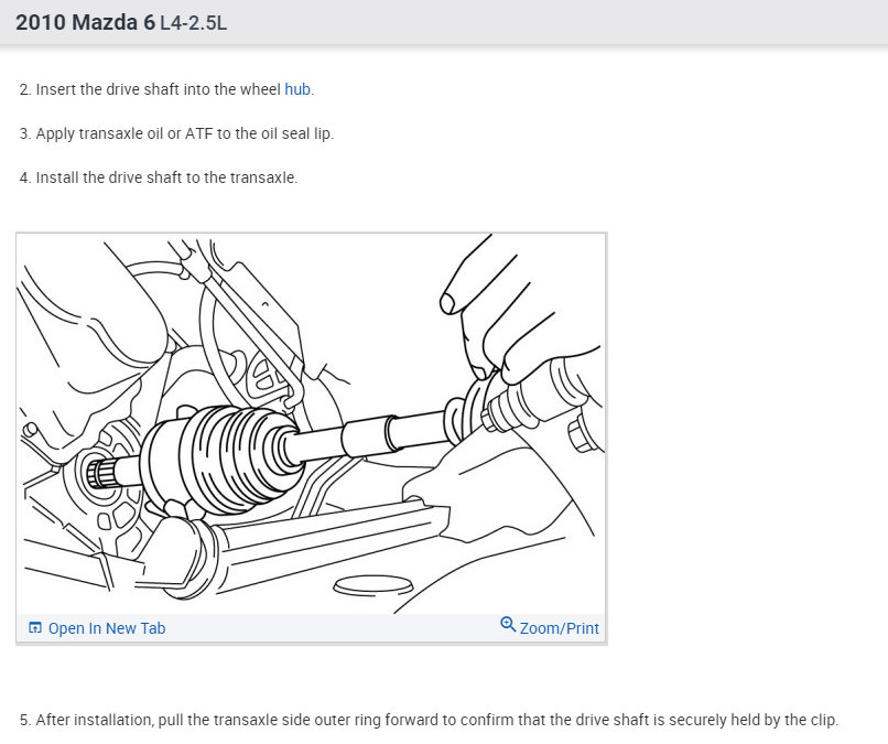

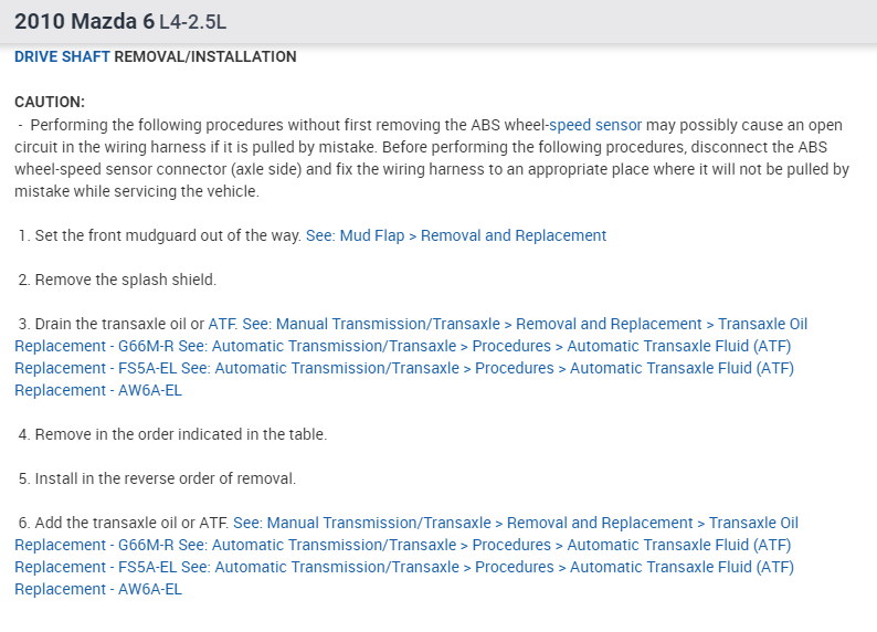

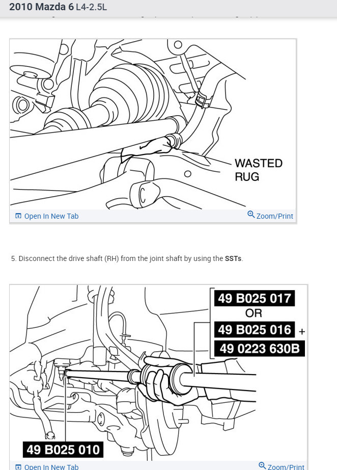

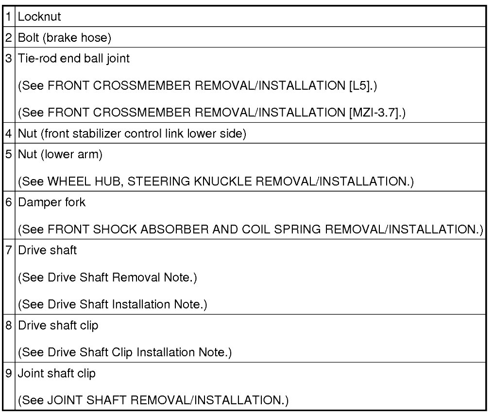

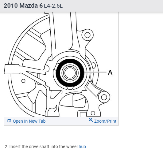

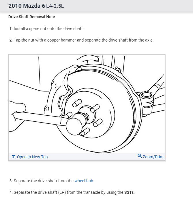

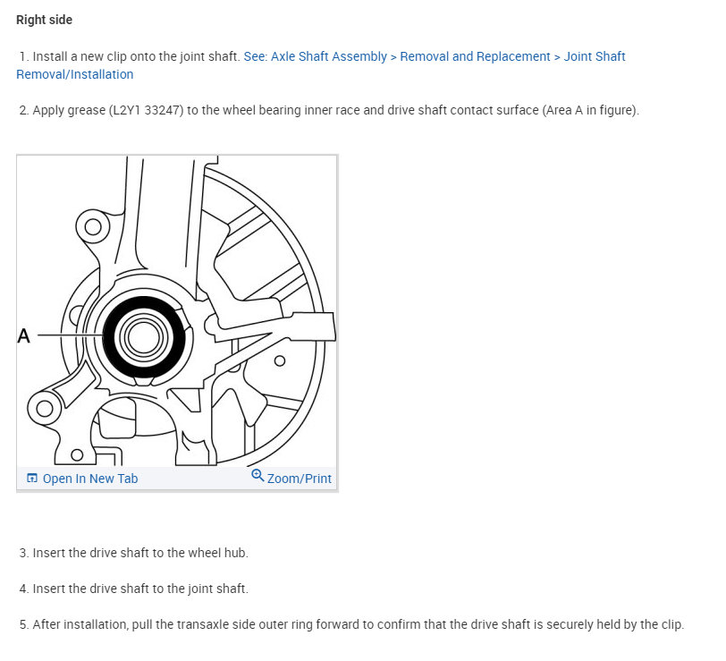

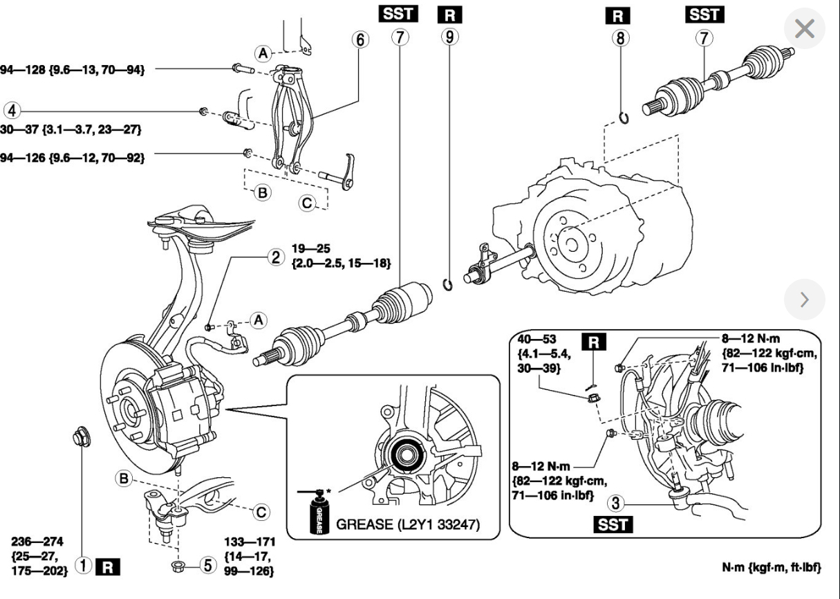

I have attached diagrams below for your reference.
