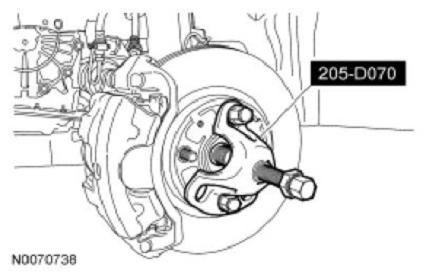

Will be replacing our passenger CV axle soon, looking for information on the correct way to remove it.

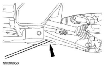

4. NOTICE: Do not use a prying device or separator fork between the ball joint and the wheel knuckle. Damage to the ball joint or ball joint seal may result. Only use the pry bar by inserting it into the lower arm body opening.
NOTICE: Use care when releasing the lower arm and wheel knuckle into the resting position or damage to the ball joint seal may occur.
Remove and discard the ball joint nut and bolt.
- Insert a pry bar in the lower arm body opening and separate the ball joint from the wheel knuckle.
5. NOTICE: The inner joint must not be bent more than 18 degrees. The outer joint must not be bent more than 45 degrees. Damage to the halfshaft will occur.

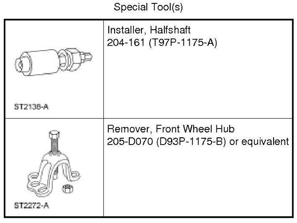

Using the Front Wheel Hub Remover, press out the halfshaft from the wheel hub and detach the RH halfshaft from the wheel hub.

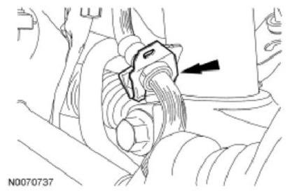

6. Remove the brake hose retainer.

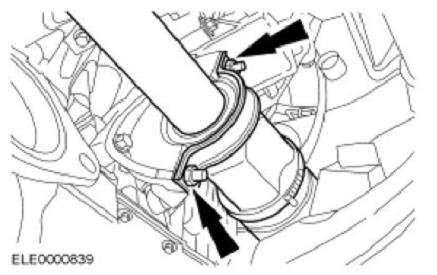

7. Remove and discard the retaining strap and 2 nuts.

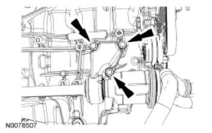

8. Remove and discard the 3 bracket-to-block bolts.

4. Install the 3 new bracket bolts to the engine block.
- Tighten to 48 Nm (35 lb-ft).

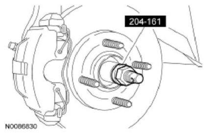

5. Using the Halfshaft Installer, install the RH halfshaft into the wheel hub.

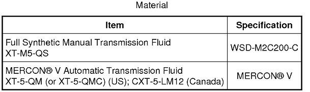

10. Top off the transmission fluid level.
