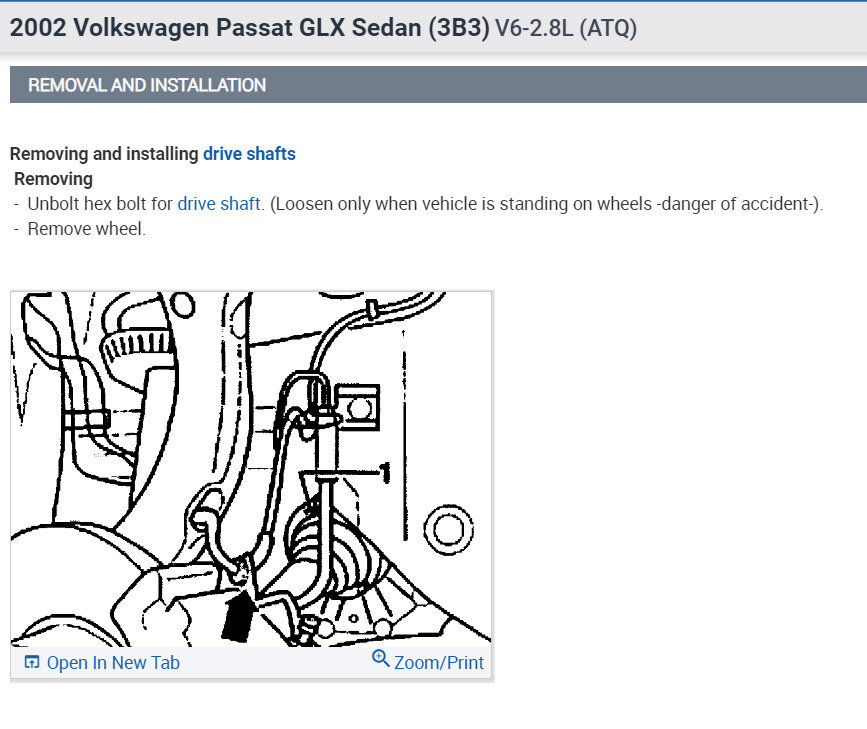

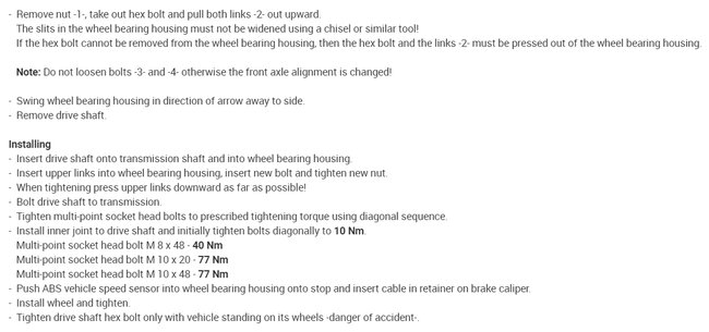

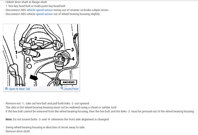

Has there been any suspension modifications? Also, has the car been in an accident? If not, then it sounds like you got a defective CV axle. Here is a generic guide to help you step by step with instructions in the diagrams below to show you how on your car:
https://www.2carpros.com/articles/replace-cv-axle
