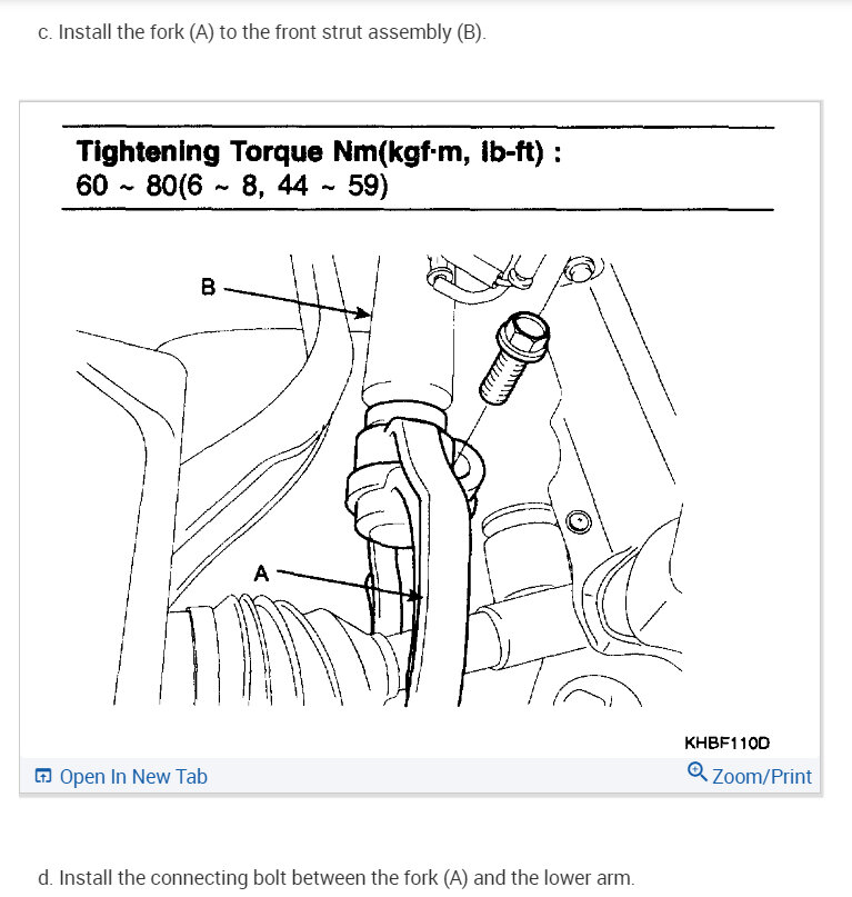

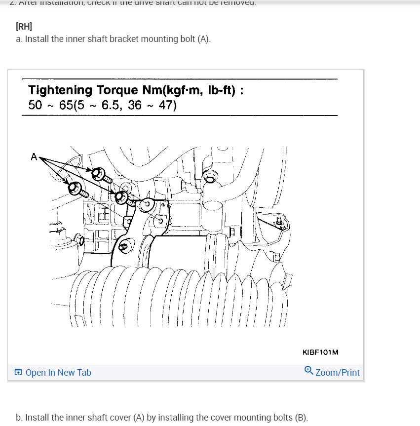

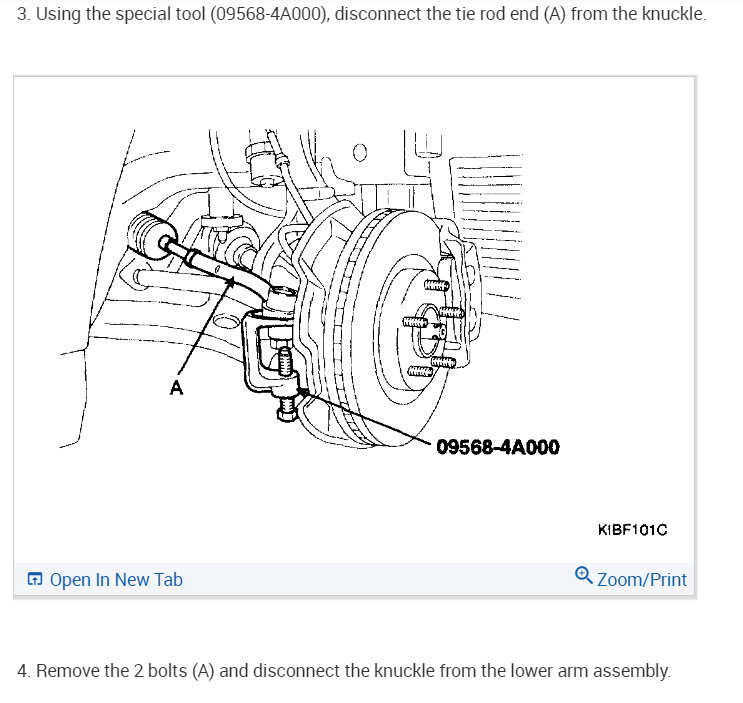

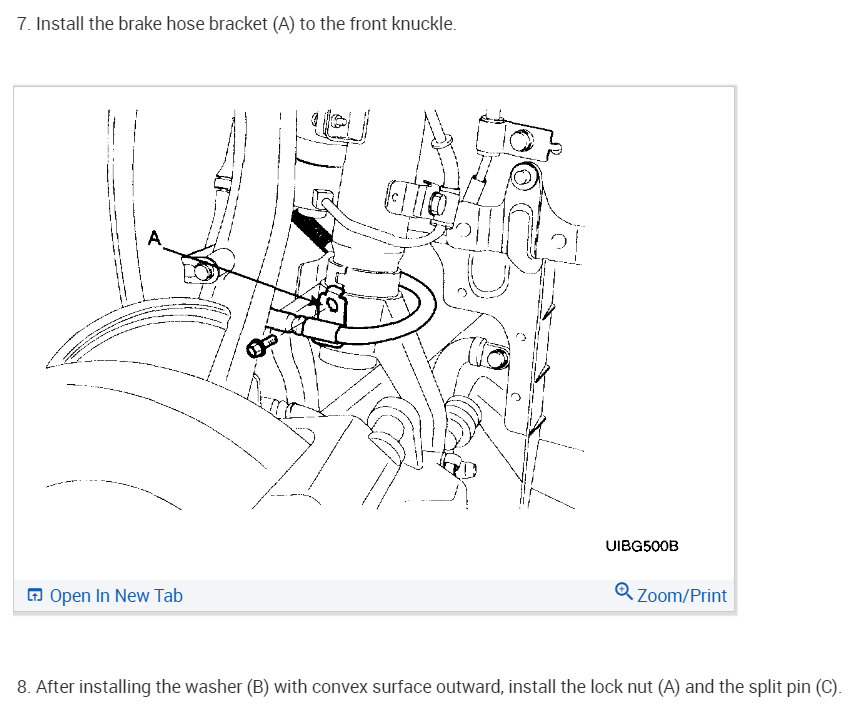

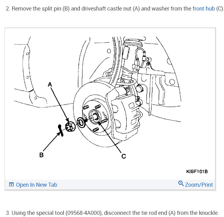

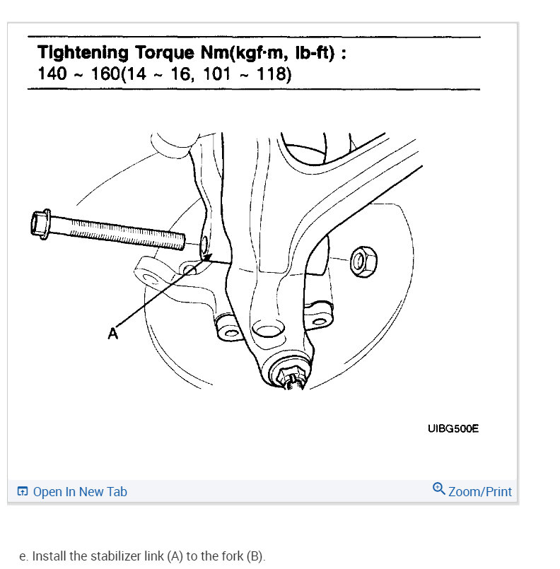

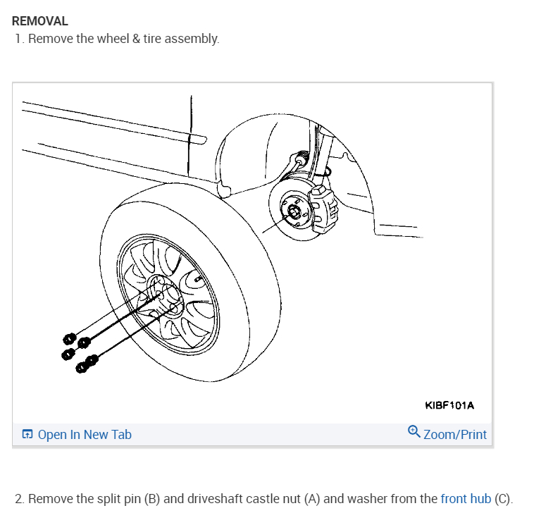

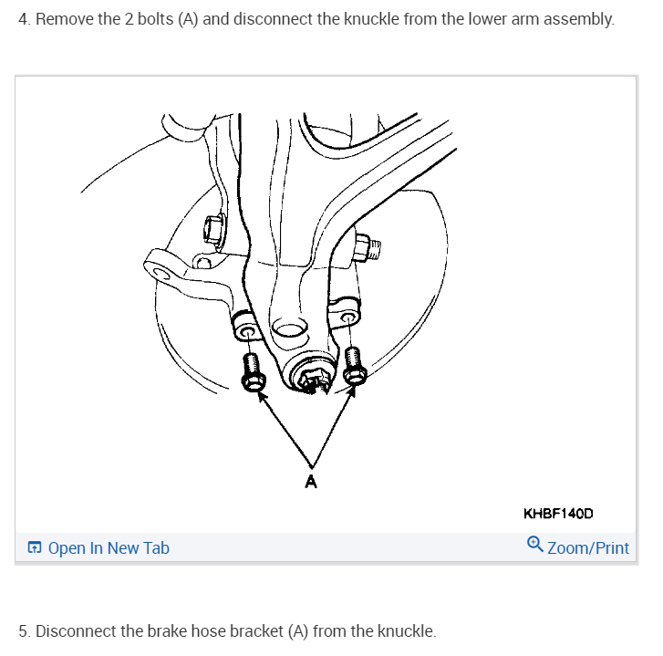

sometimes when I take off, I hear a pop near transmission I was told CV joints will do this no noise or clicking when turning if only every once in a while when acerating forward with no clicking does this mean need to get new joints soon or do I have some time before they go out. Thanks, Phil
Sep 20, 2023 at 7:39 AM
  • 55,399 POSTS

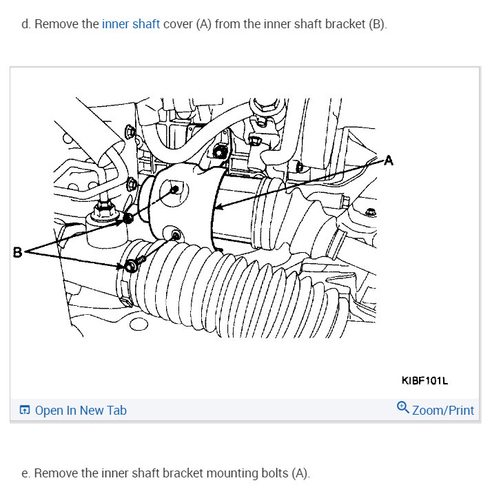

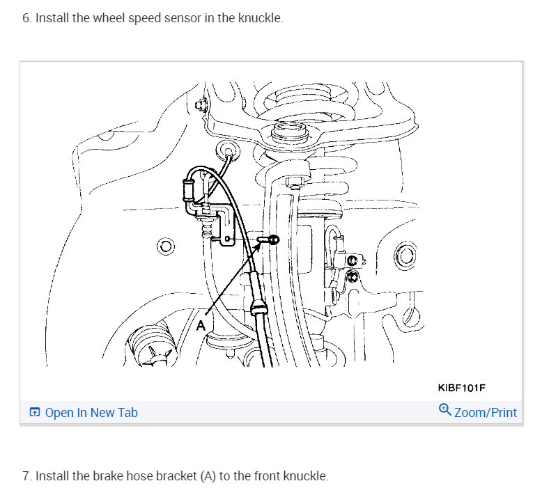

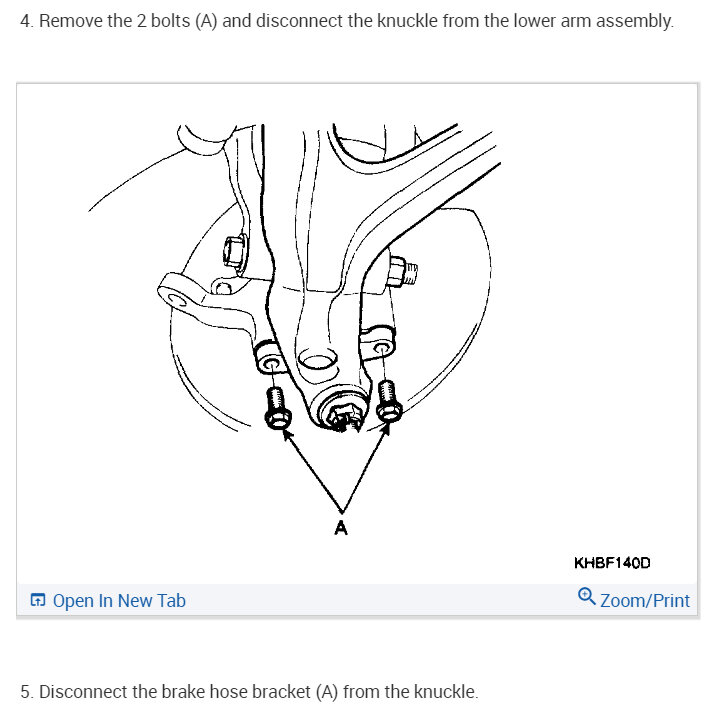

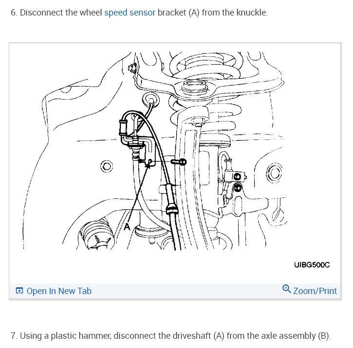

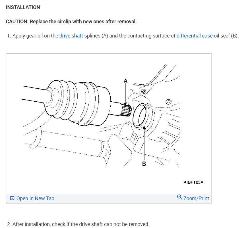

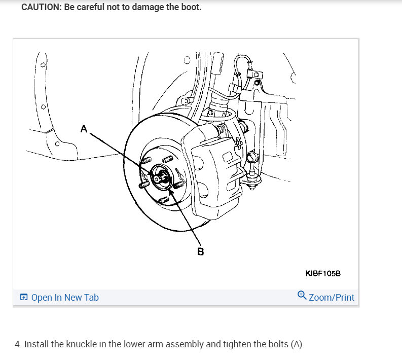

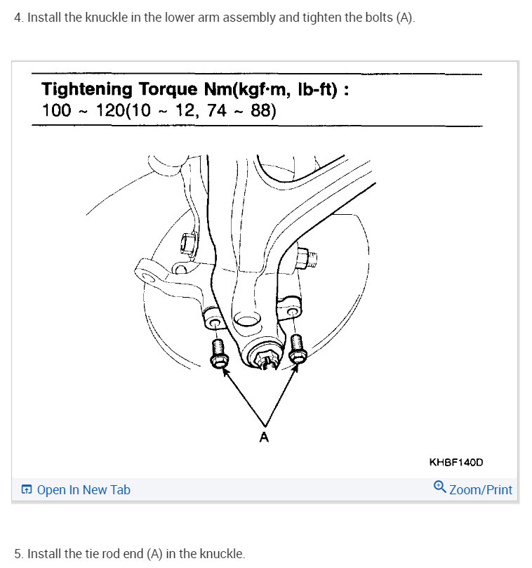

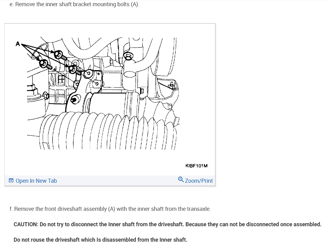

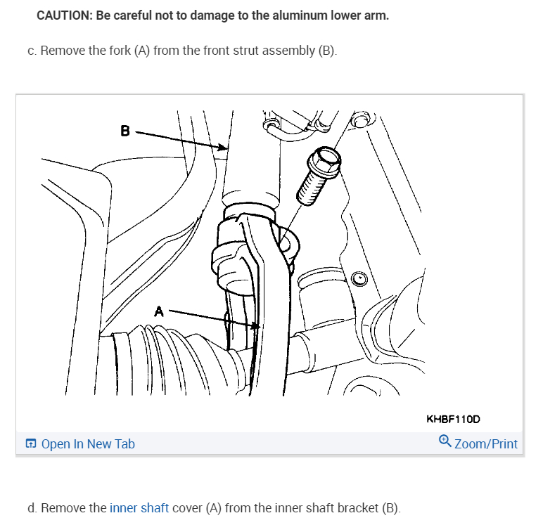

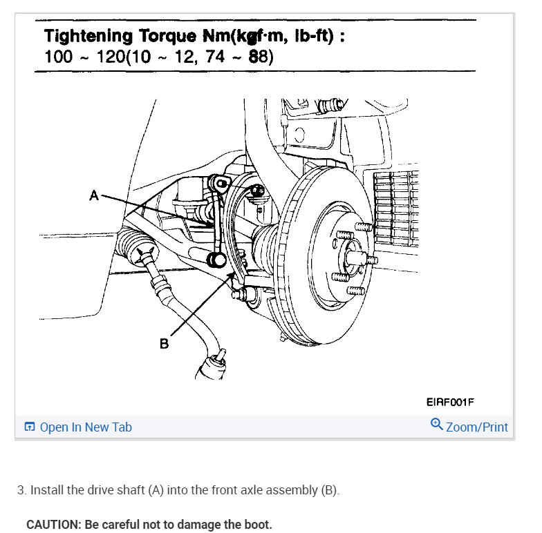

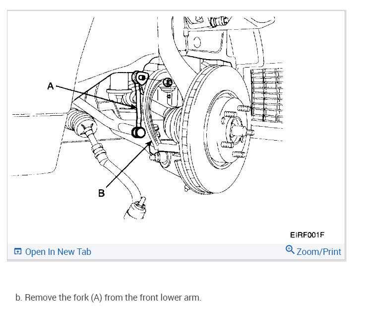

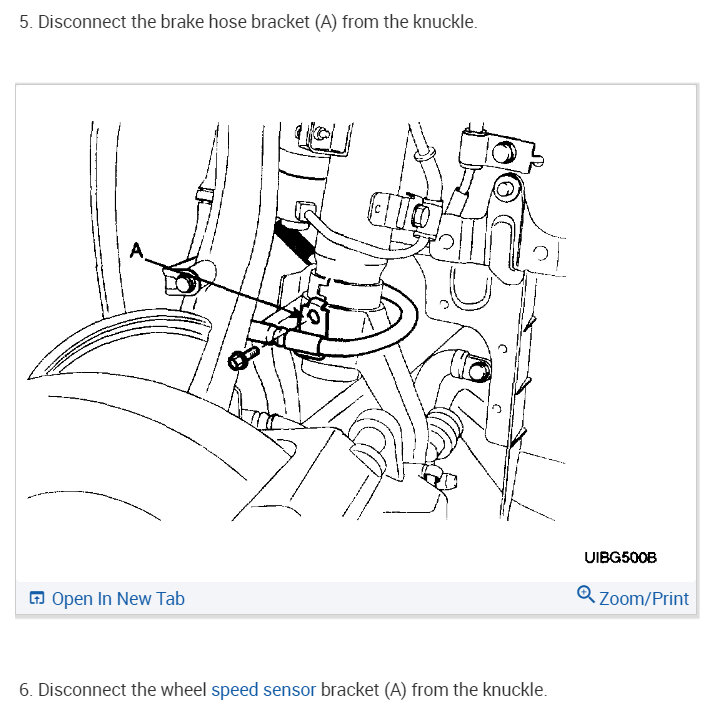

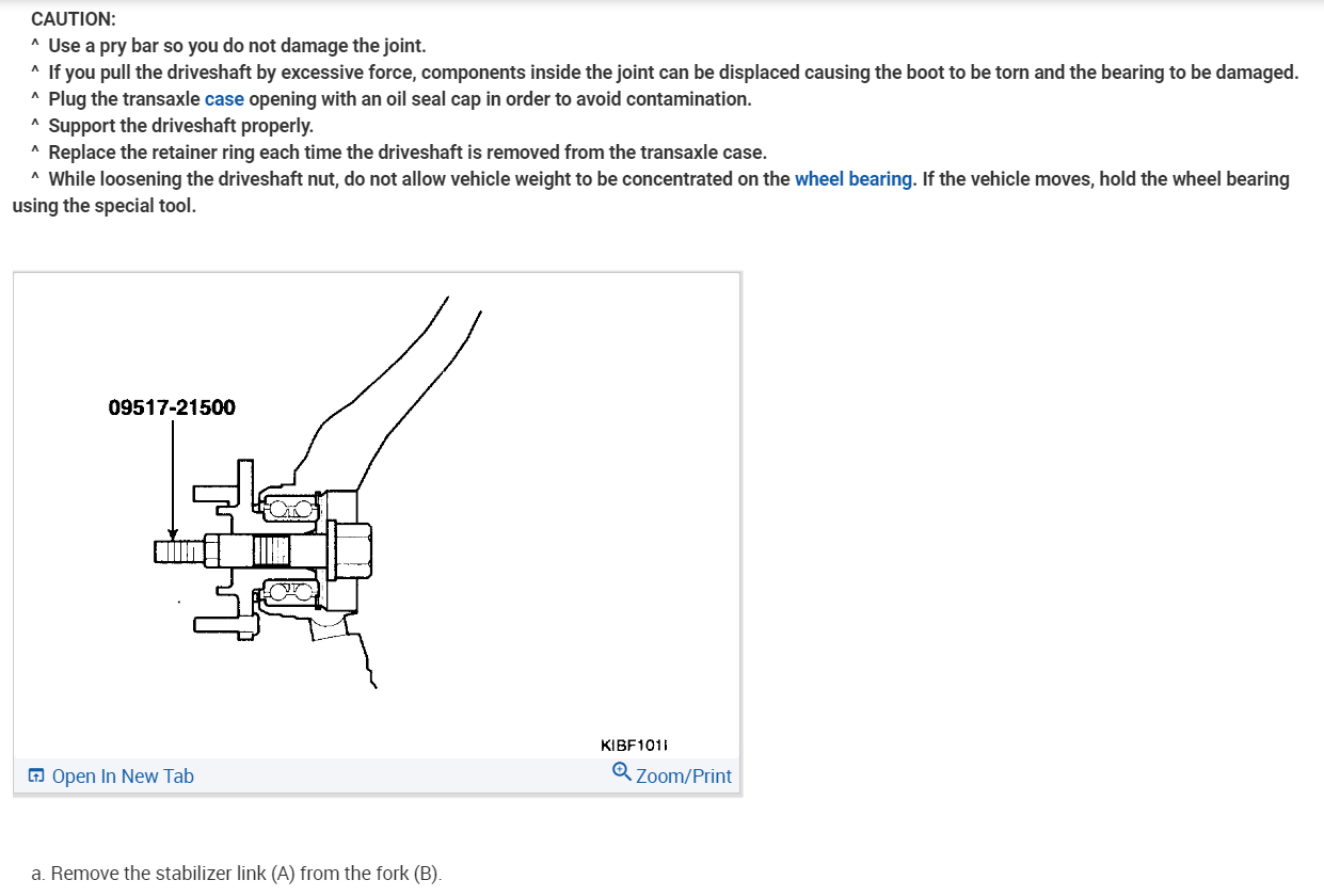

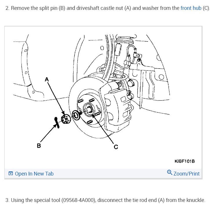

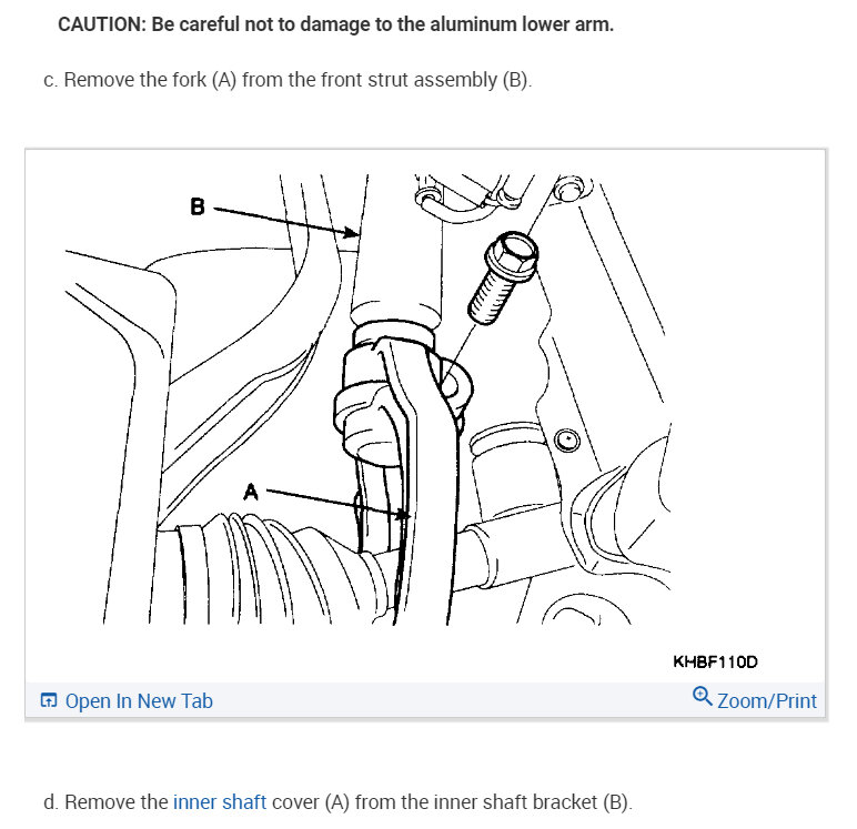

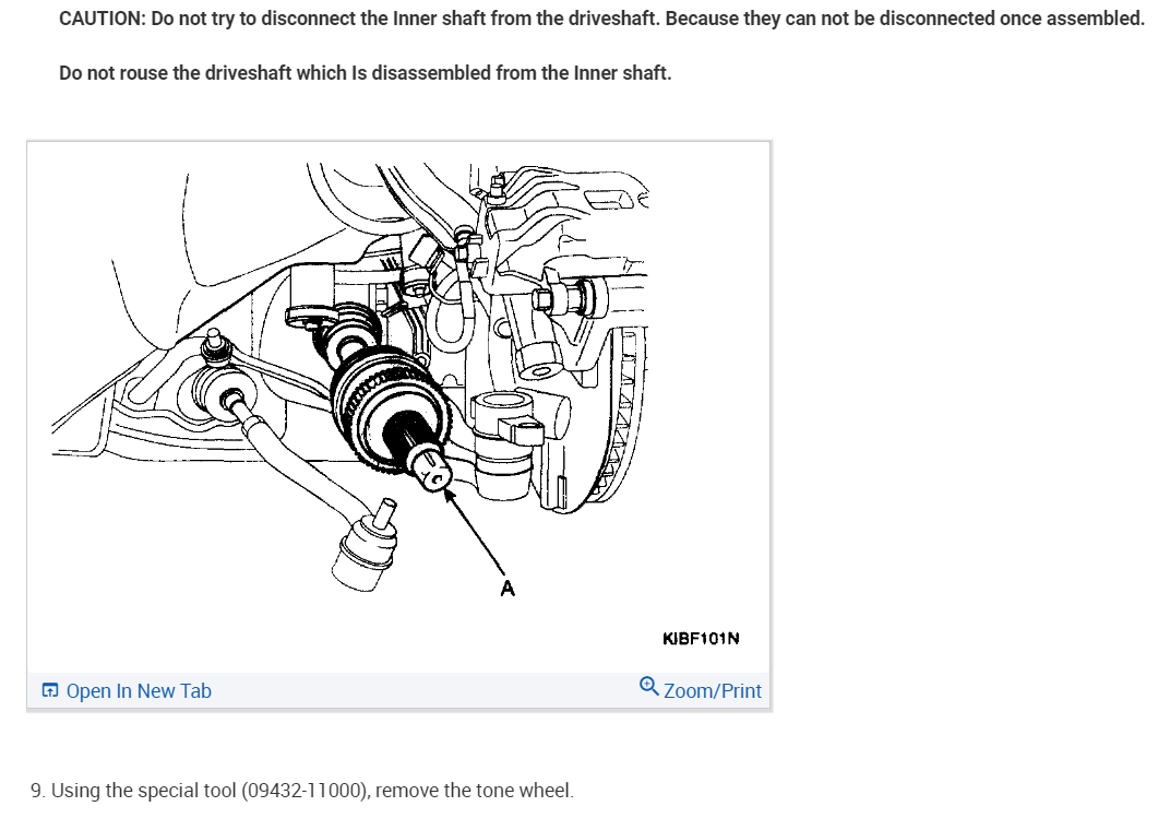

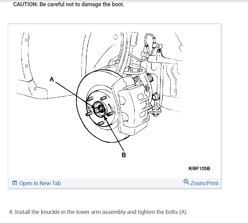

Yes, CV axles can make a clicking or popping noise during initial take off. Can you please shoot a quick video with your phone so I can hear the noise? That way I can tell for sure what's going on. You can upload it here with your response.

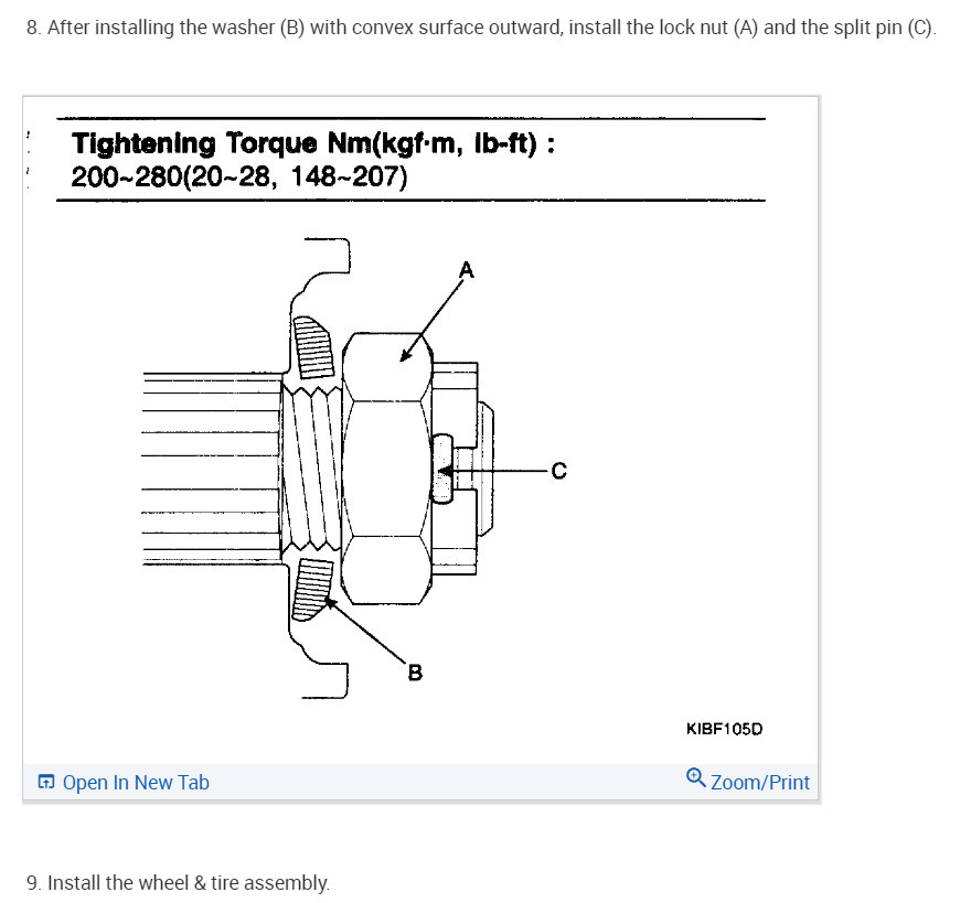

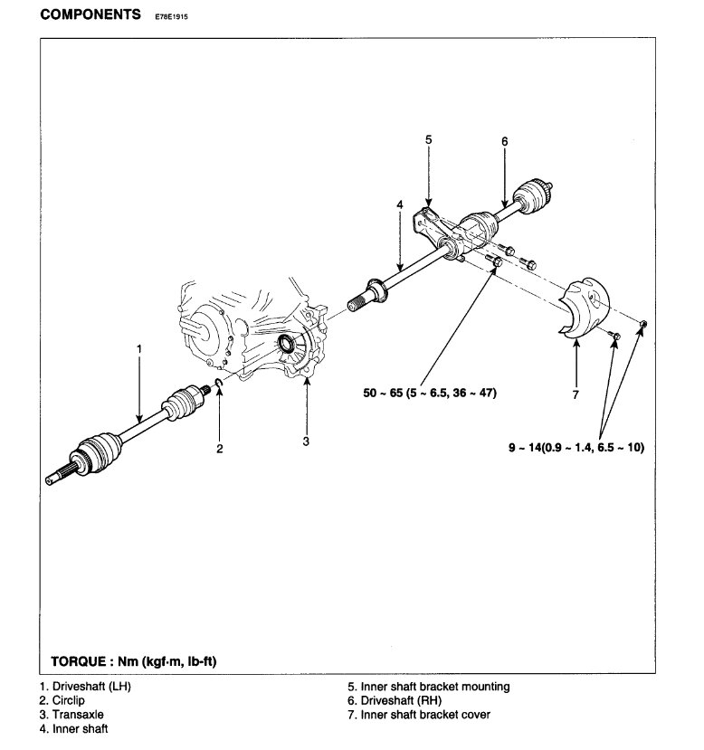

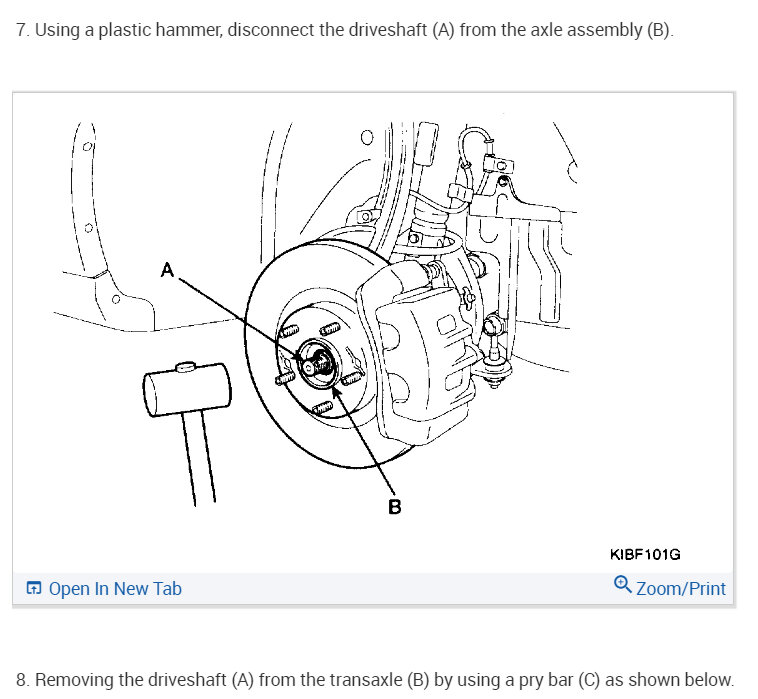

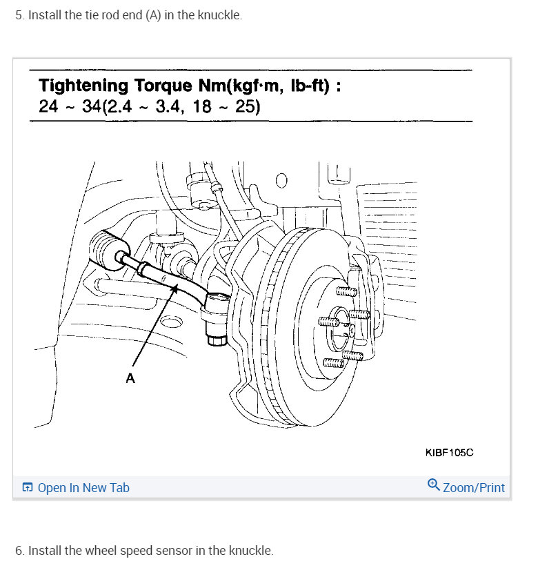

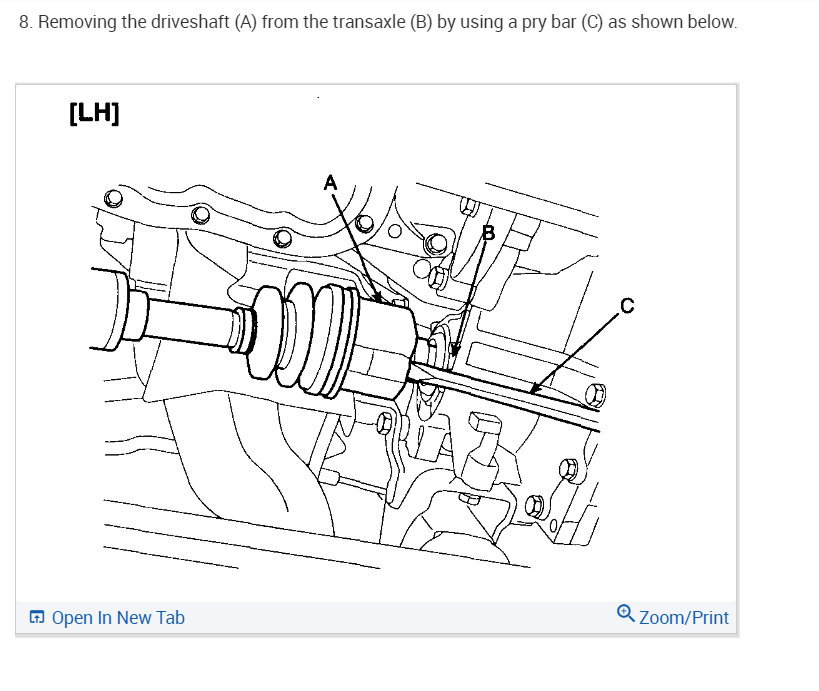

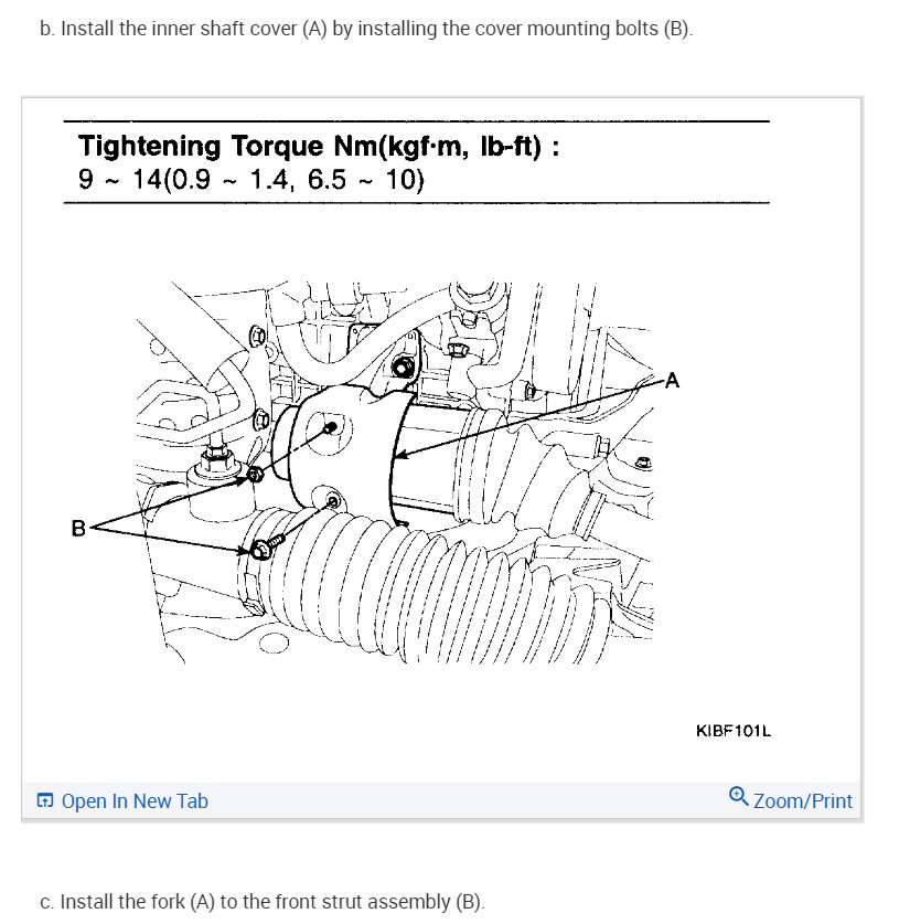

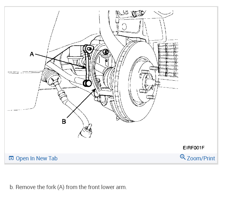

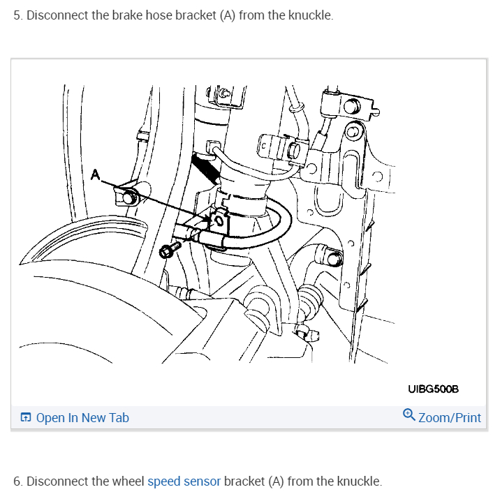

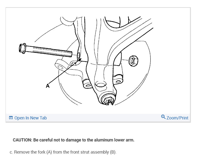

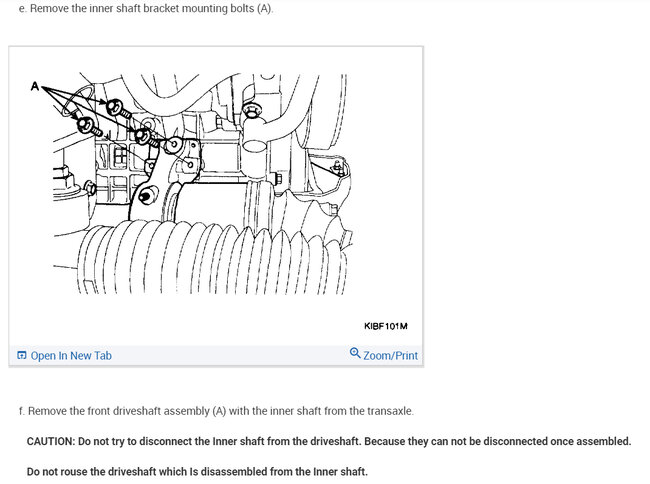

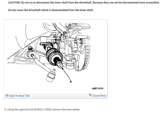

Here is a generic guide to help you step by step with instructions in the diagrams below to show you how on your car:
https://www.2carpros.com/articles/replace-cv-axle
I would replace both CV axles, check out the images (below). Please let us know how it goes.
