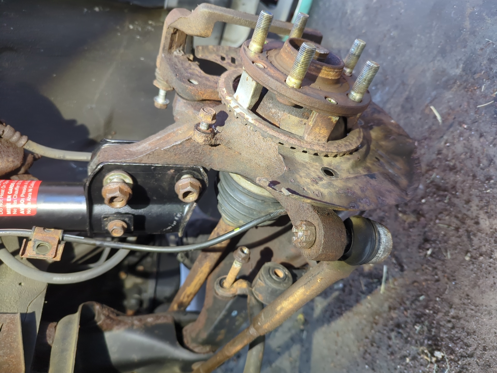

I had to bring a mobile mechanic in to try and free the axle I need to replace (front left), but he couldn't budge it - heat, air hammer, mallets - it's like it's welded together. Now, I need to either remove the entire assembly, and have a machine shop press it apart and rebuild, or buy new hub kit and knuckle, and have them press that together. I just replaced all 4 struts, and money is tight. What would you recommend as the best solution? And should I avoid re-using the existing bearings, after the pounding they just took?

Unfortunately, that is common with that design, the rust in the splines and lock together like they were welded. Generally, they resist a light hammer, and they get the hub grappler. If that still doesn't push it out then I order the bearings, hub and axle. Then heat the hub until it's red hot and push it apart. That usually wipes out the bearings and seals and ruins the temper in the axle and hub. If you have an oxy/fuel torch I would go after it with a lot more heat. As you need to press it apart I would at minimum replace the bearings and the axle due to the hammering alone.

Thanks again, Steve. Update on the axle fiasco: After removing the entire assembly, I tried freeing 2 stuck bolts. The first was the small one holding the ABS sensor in place. Sheared the head off that one completely. The second bolt holds the ball joint. Buggered up the head on that one, and it's not budging. Looks like I'll need to replace the whole shebang. The job just went from quick and not too expensive to "uh-oh" in a hurry.

Not having a good torch handy, I resorted to sheer brute force and anger, and wailed on the axle stub with a large hammer until it finally broke free. Unfortunately, I shattered the ABS tone ring in the process. Apparently, those things are pretty brittle. Now, I have to decide whether to shell out over $100 for a new ring (highway robbery), or just do without it. I've read where others have just not replaced them. Next challenge is trying to free the two frozen bolts from the knuckle, or I'll have to replace that, too.

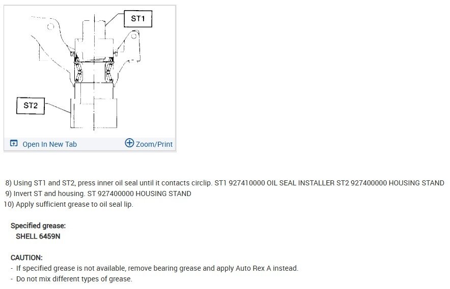

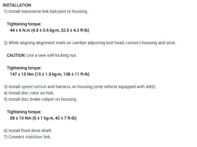

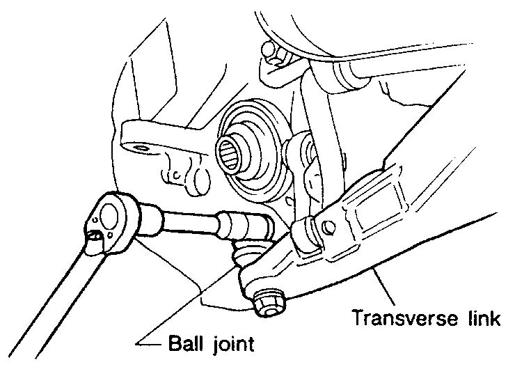

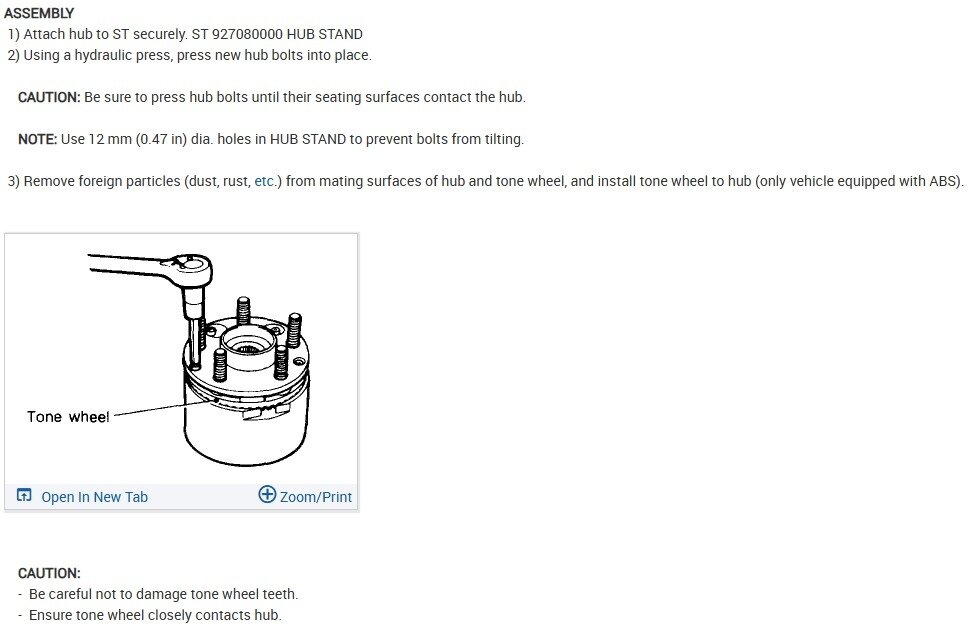

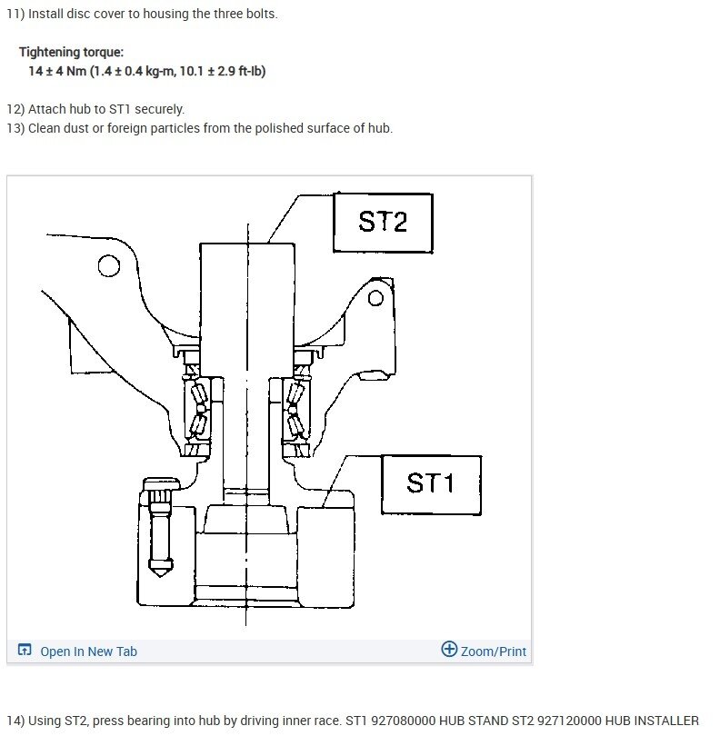

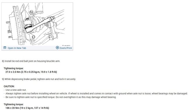

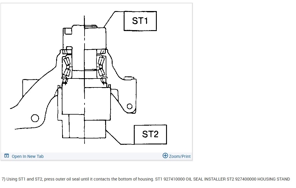

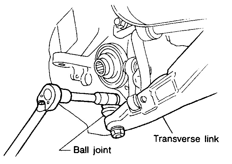

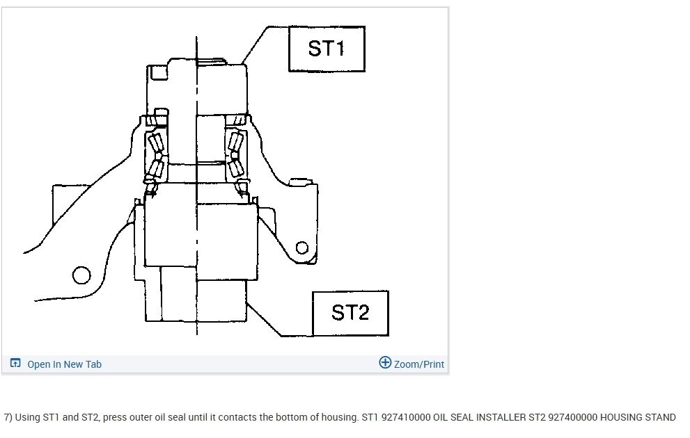

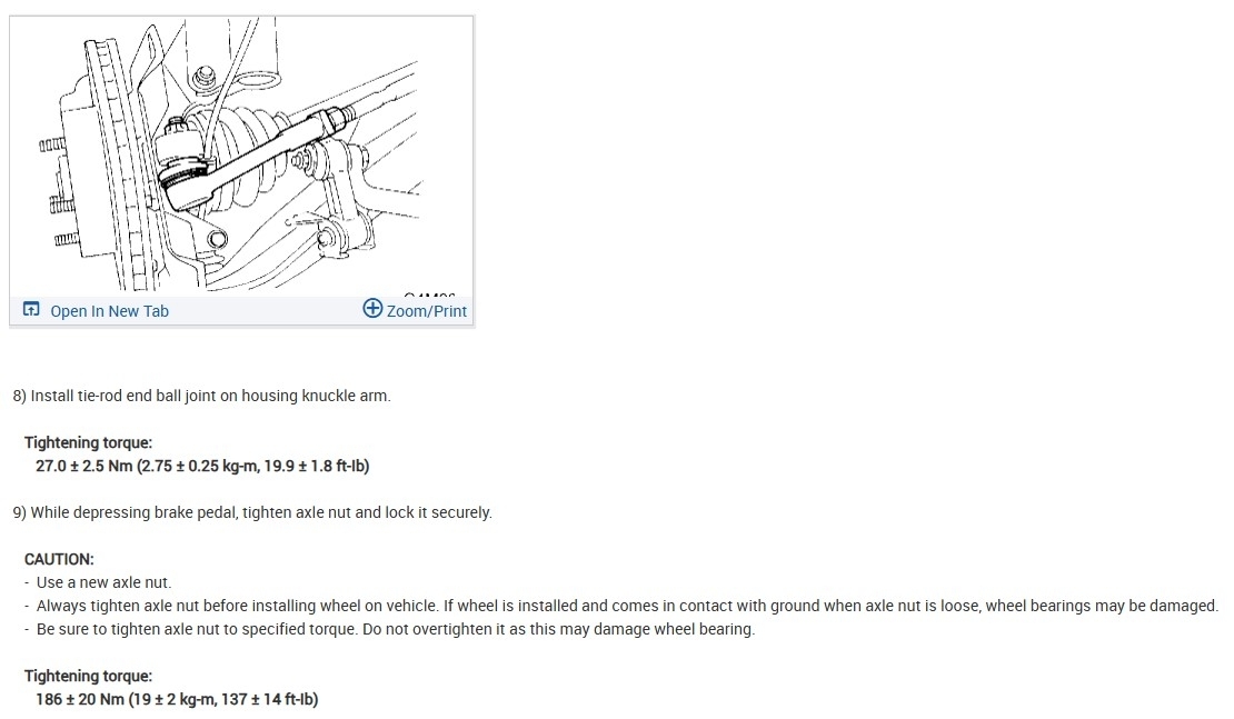

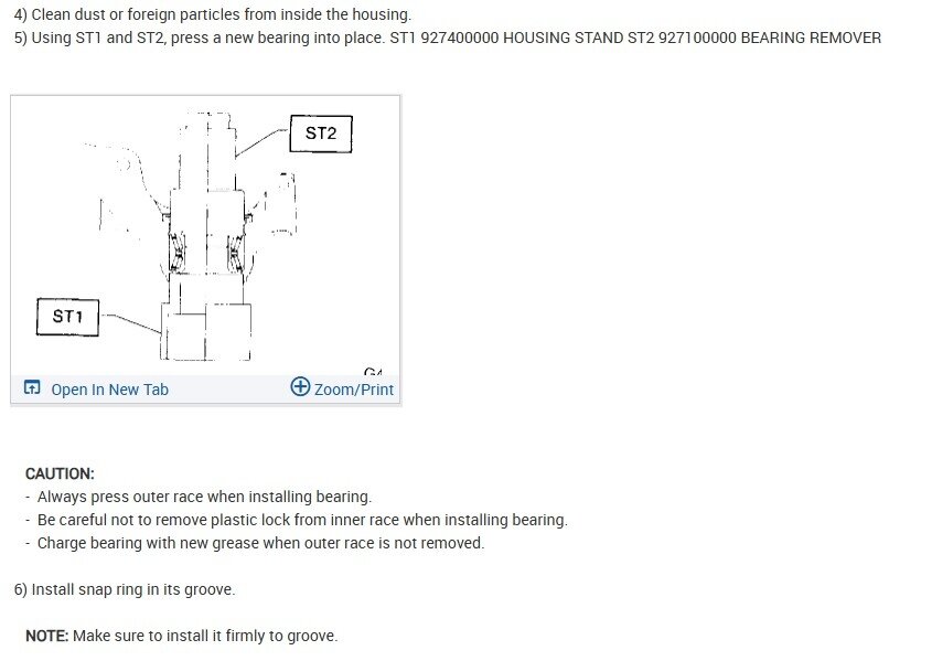

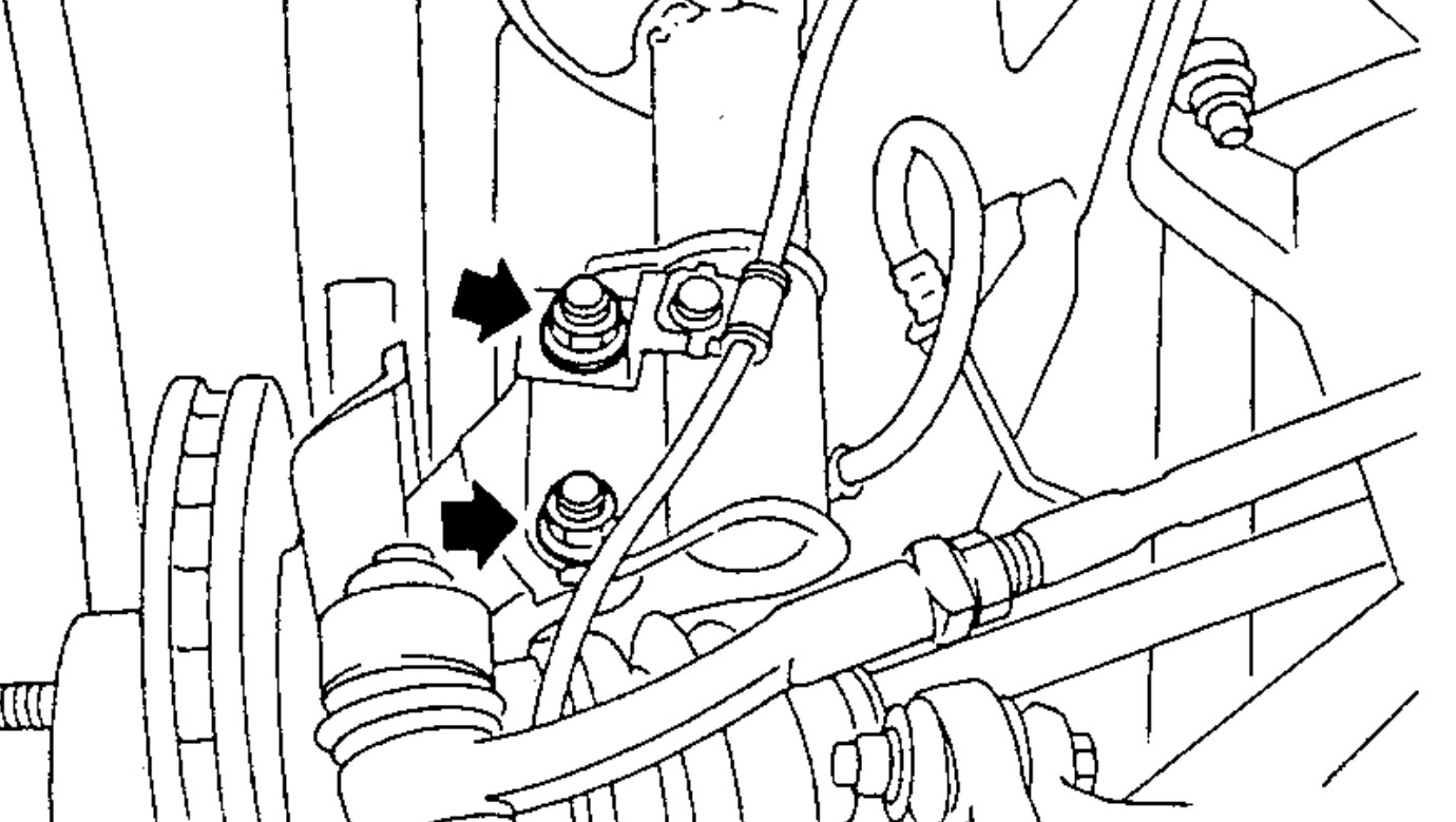

Yeah, that bearing design can cause tempers to flare. I'll post the info from the service data in attached images. Basically, you clean up the knuckle, then use the press to install the bearing by pressing only on the outer race Then install the outer seal and then you assemble the tone ring to the hub. Next you press the hub into the bearing while supporting the inner race. Then the snap ring goes on and then the inner seal. Then you install the unit to the car. Two strut bolts, slip the axle into place and then the lower ball joint and tie rod. Sway bar link next and then torque those all down. Then the rotor and caliper bracket, caliper with pads and then set it down to torque the axle nut and stake it and the lug nuts.
These should help some:

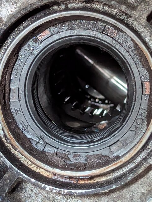

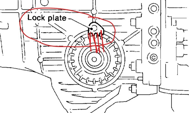

Update: I removed the axle stub from the old axle, and put it into the new half shaft, securing it with the roller pin. (Sorry if my terminology is off!) I examined the opening in the trans, and it looks like either the oil seal there is toast, or it's no longer there at all, but I can't quite tell which. I'm attaching a photo of what I'm seeing. I ordered inner (CR 22026) and outer (CR 22032) "wheel seals" from SKF, and now I have to figure out where they belong, because none of the many pics I took seem to show them well, and I couldn't find specifics on the seals. Once I get this mess sorted out, I can start reassembling everything.

The seal is there, it's the NGK part, but it looks like it was seeping and needed replacement. Just use a screwdriver or seal puller and remove the old one, then line up the new one and press or drive it into position.

Thanks, Steve! I had seen some people saying that in order to remove that seal, you have to unscrew the "sundial" on the transmission. Are you sure that it can just be popped out without the need to do that?

That's correct, forgot this was the front shaft. For that you unscrew the retainer then the seal can be removed, If you are careful you won't disturb the bearings. Replace the seal and put it back together. Tighten the ring down and put it back in the same place as you removed it. The locking tab that bolts to the housing usually leaves a nice spot to return it to or you can just put a mark on them before you remove them. You could get a heli-coil kit to rethread the hole. It's probably at the right size for that. Or epoxy a stud in the hole and just use a nut on the outside.
