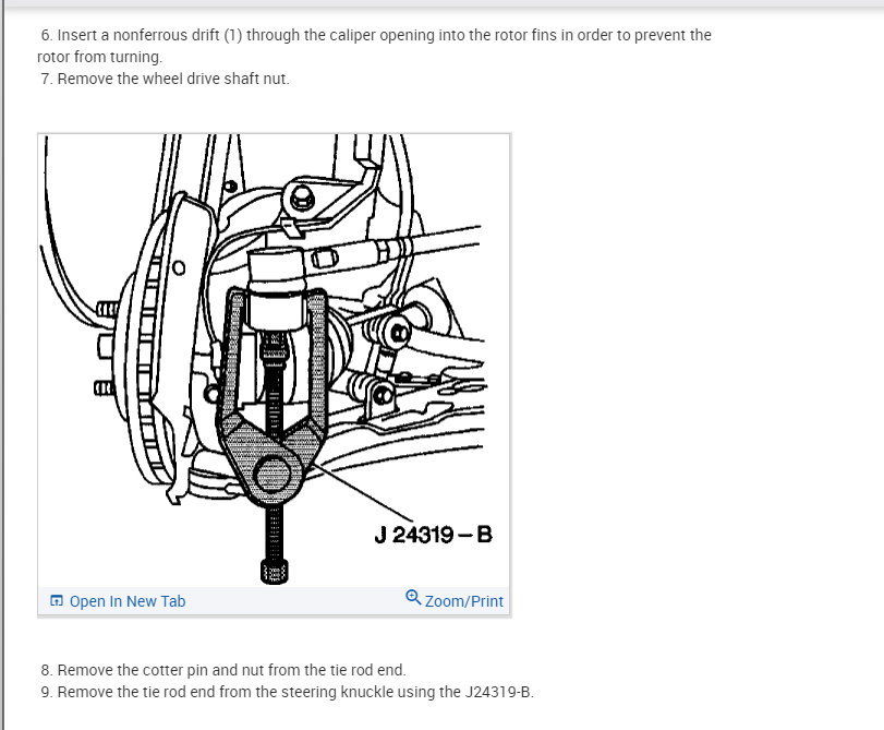

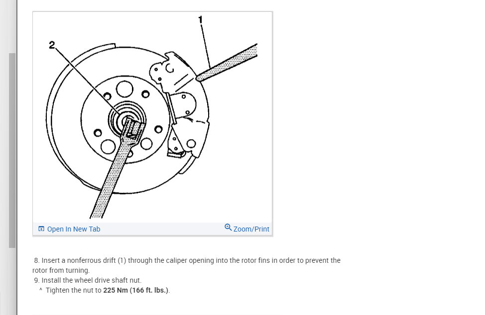

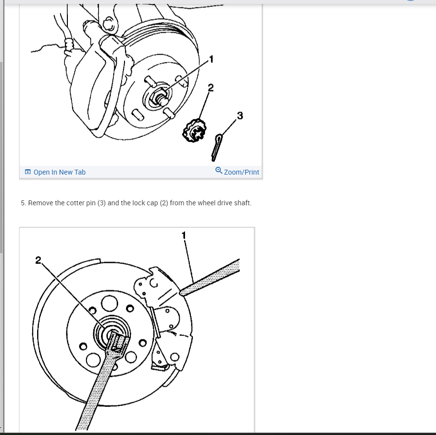

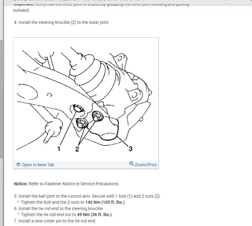

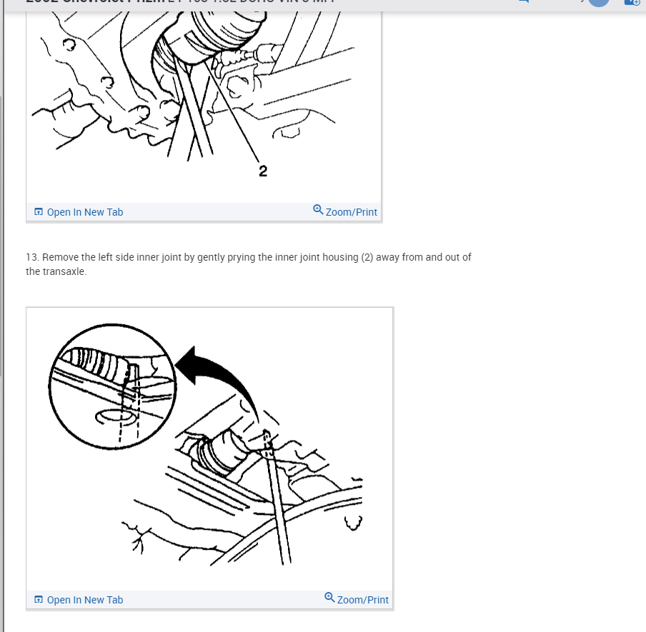

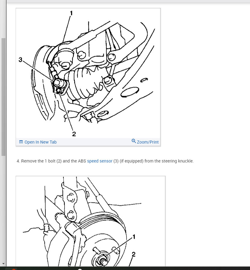

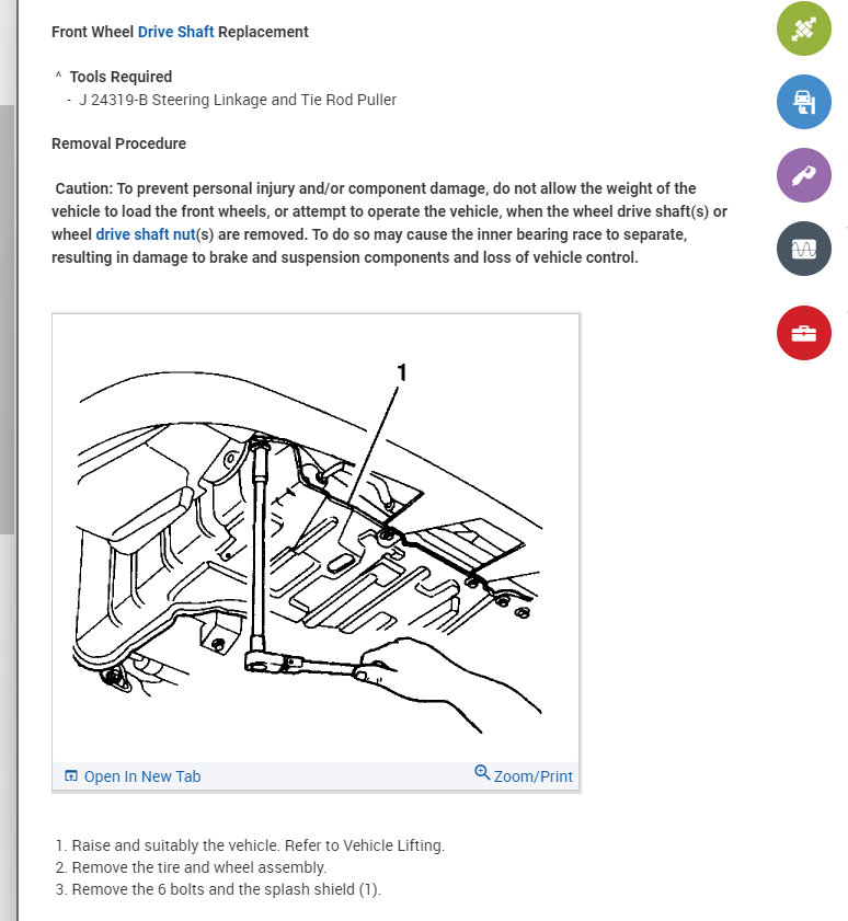

I'm guessing it's slipping. Please upload the instructions to change the thing. This promises to be a fun at home project.
Saturday, May 7th, 2022 AT 3:29 AM
MECHANIC
18,907 POSTS

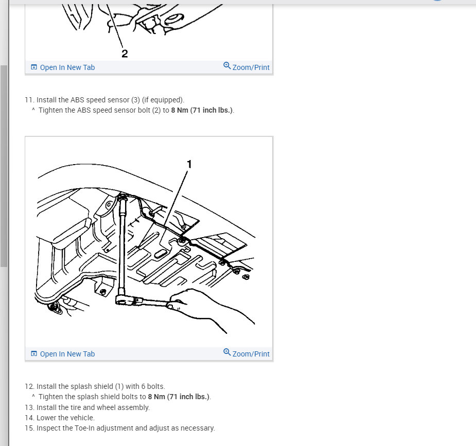

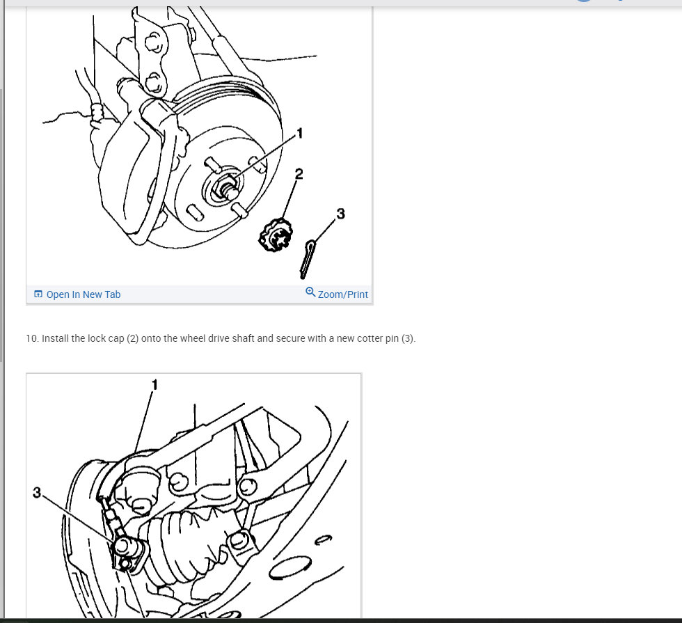

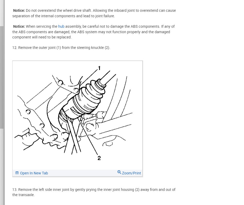

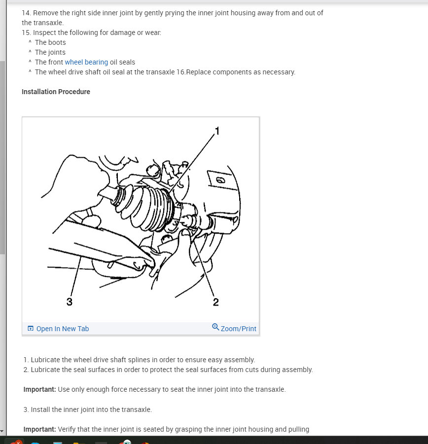

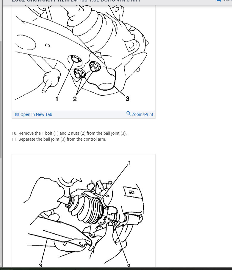

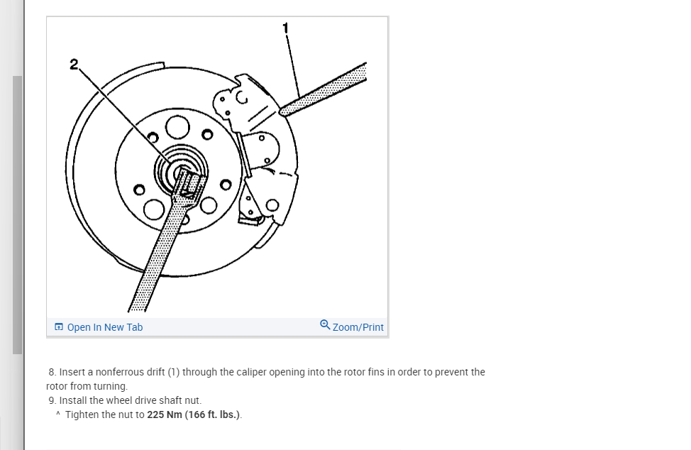

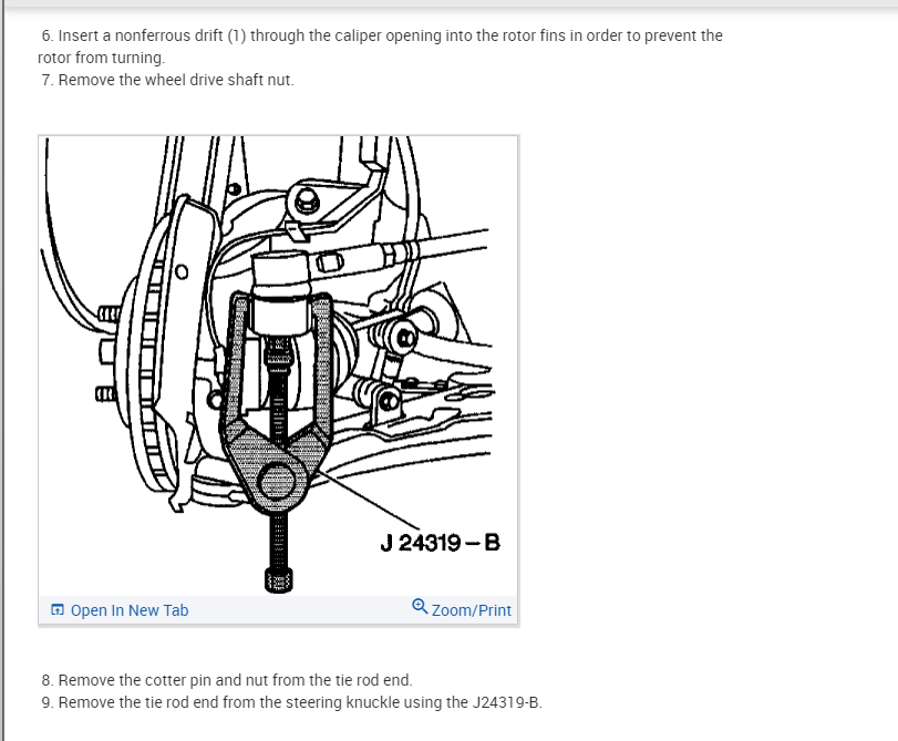

This does sound like it needs to be replaced, so here are a couple guides that have great info that will help in doing this:
https://www.2carpros.com/articles/symptoms-of-a-bad-cv-axle-joint
https://www.2carpros.com/articles/replace-cv-axle
I am attaching the process below from the manual that will help with replacing this.
Please run through this and let us know how it turns out.
Thanks
