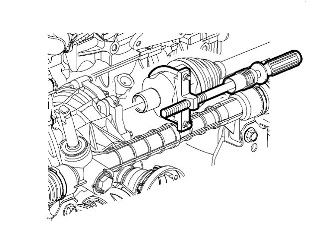

Special Tools
J 2619-01 - Slide Hammer
J 42128 - Hub Puller
J 44394-A - A Seal Protector
J 45341 - Rear Wheel Drive Shaft Removal Tools

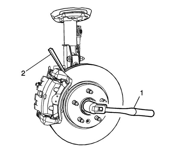

3. Insert a punch or a drift (2) in the cooling fins of the brake rotor.
4. Rotate the brake rotor until it rest against the brake caliper mounting bracket.

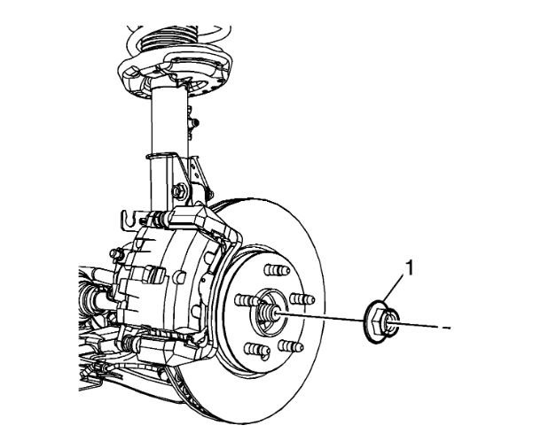

5. Using a breaker bar and the proper size socket (1), loosen the wheel drive shaft nut.
6. Remove the wheel drive shaft nut (1) and discard.

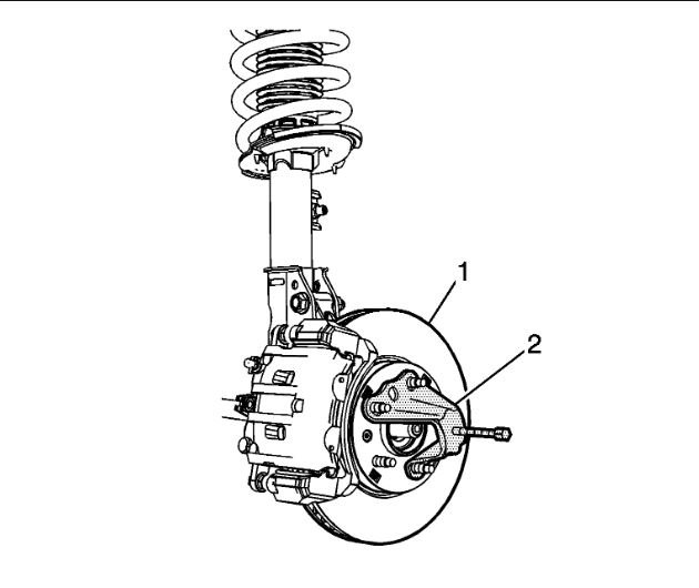

7. Using the J 42128 - puller (2), separate the wheel drive shaft from the wheel hub (1).

11. Using the J 2619-01 - hammer and the J 45341 - tool , remove the wheel drive shaft from the vehicle.
