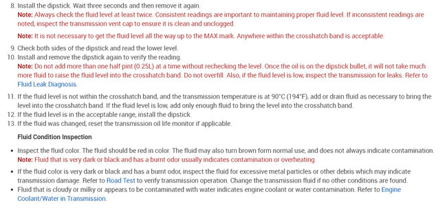

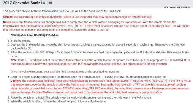

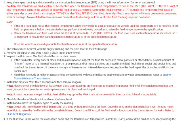

Yes, the fluid level is above the seals, or the transmission fluid was over filled, here is how to add or check the fluid level once the car is back together. Check out the images (below). Please let us know if you need anything else to get the problem fixed.

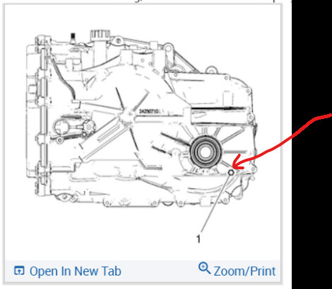

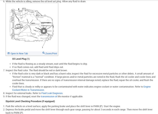

Did you see the drain plug level indicator on the side of the transmission I noted in the images above?

It sounds like it was, the level plug is on the driver's side, check out the images (below). Please let us know how it goes.
