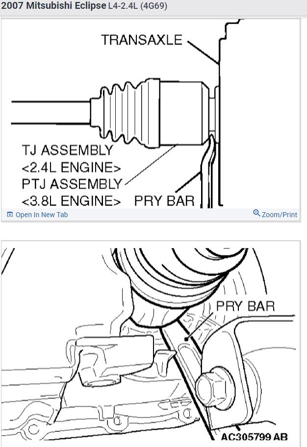

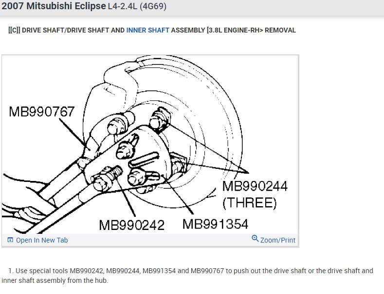

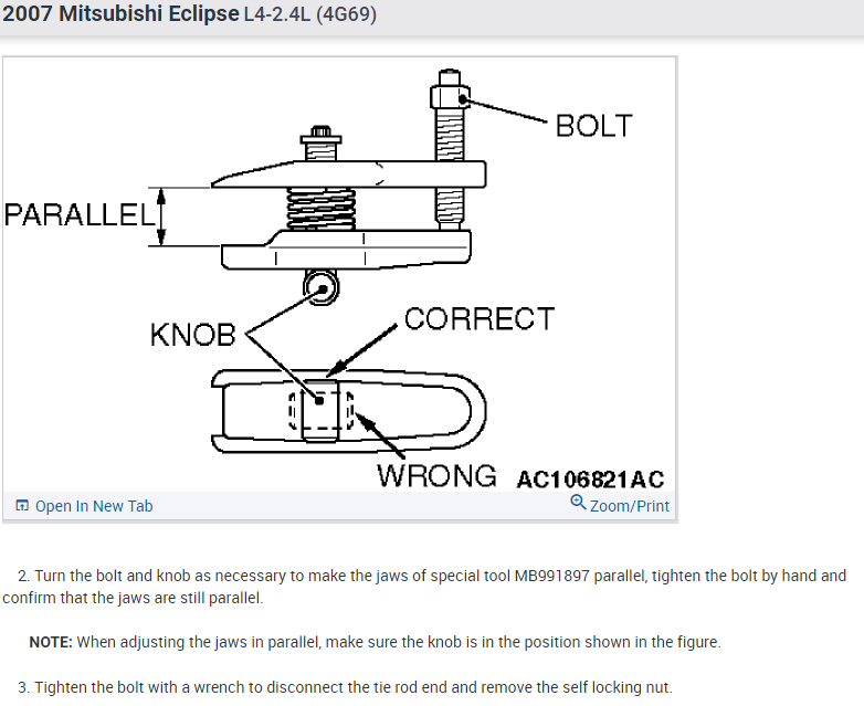

What all do I I need to replace the CP excellent driver side?
Jul 14, 2021 at 12:33 AM
SQM
Experienced Mechanic
6,383 POSTS

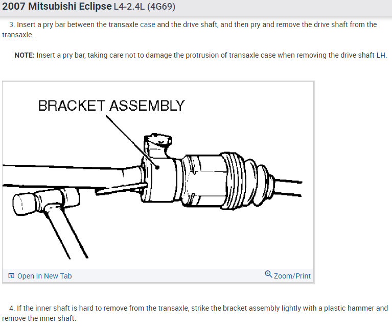

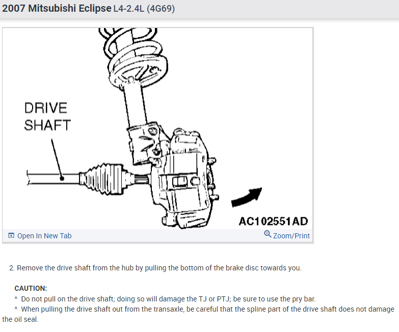

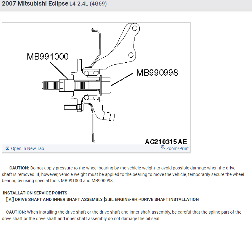

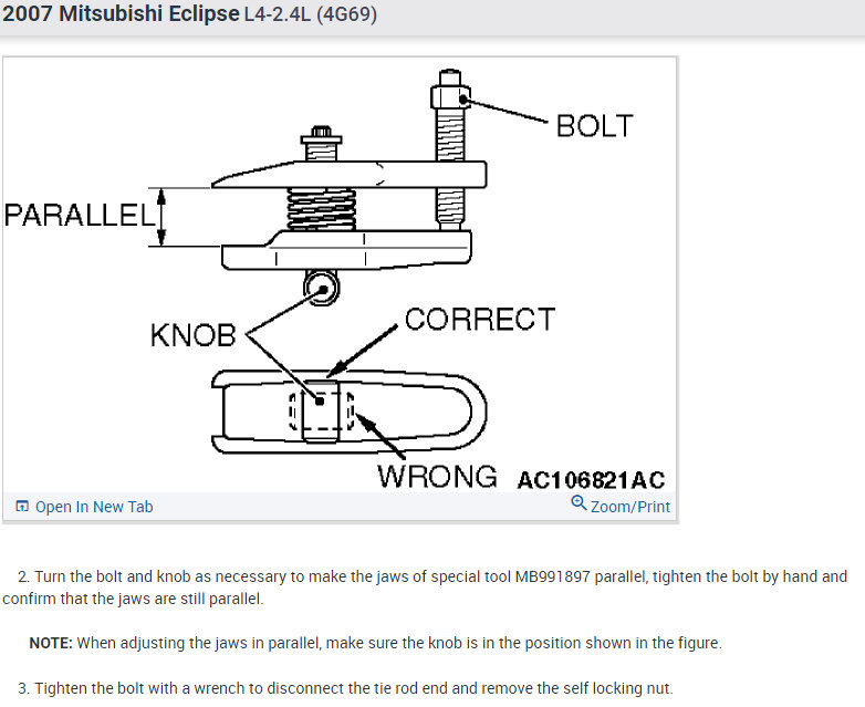

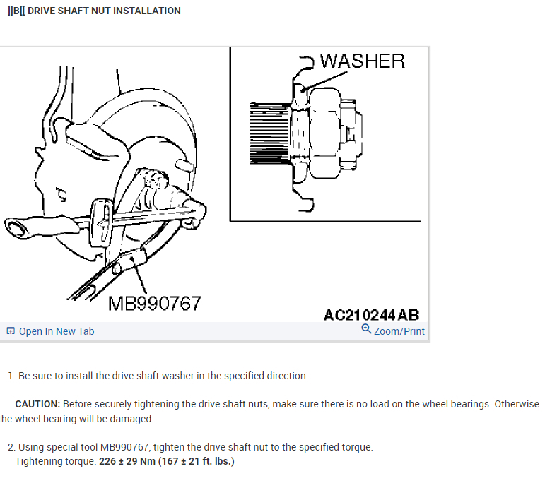

Please refer to this article, it has some good info:
https://www.2carpros.com/articles/replace-cv-axle
https://youtu.be/9OYxj9y3Zjc

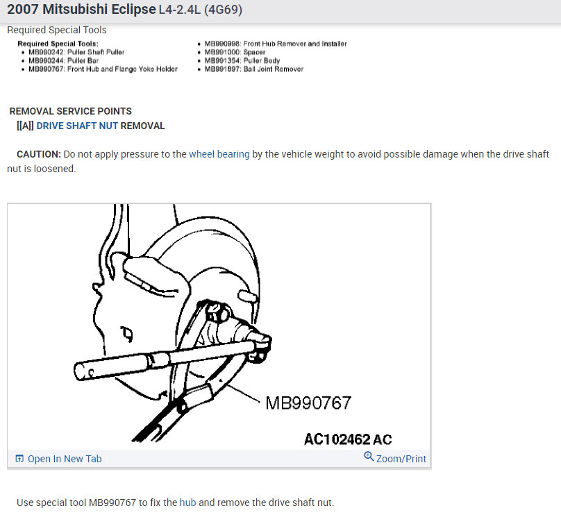

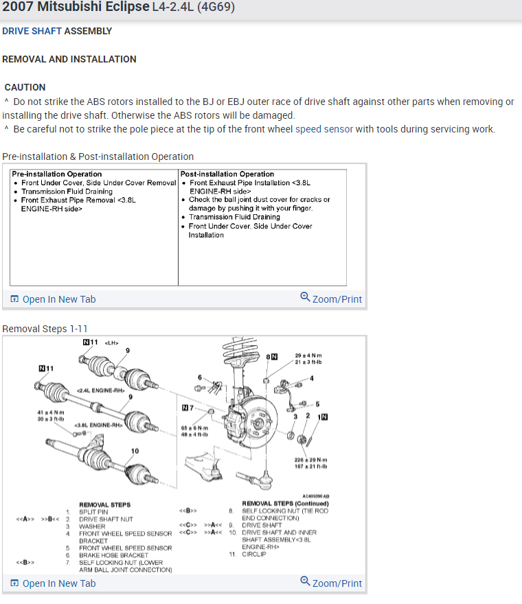

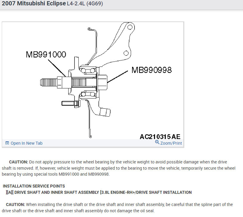

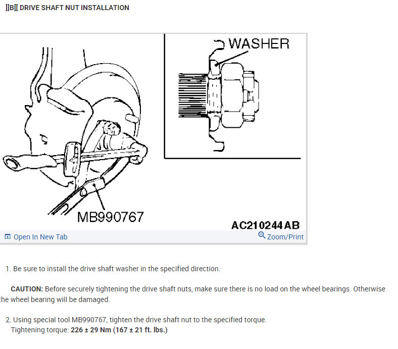

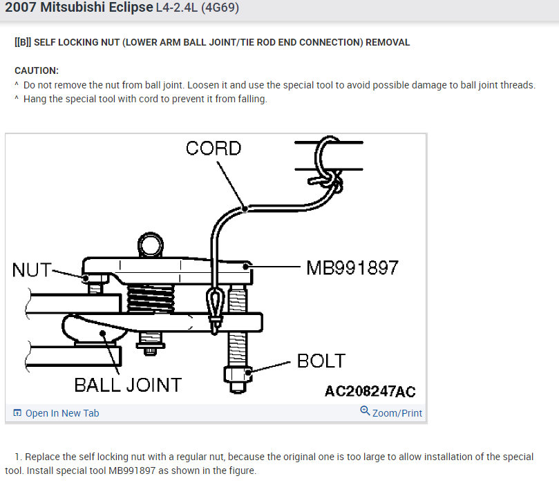

I have also attached replacement procedure for the CV axle on your car.
