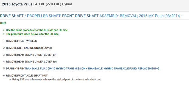

Cv axle making clicking noise?
2015 TOYOTA PRIUS
180,000 MILES
MARC VALENCIA
I'm spinning my axle and it's making clicking noises
Sep 7, 2024 at 8:32 AM
  • 110,240 POSTS
Chances are the joint itself is worn. Do me a favor. Take a look through this link and let me know if it mirrors what you are experiencing:
https://www.2carpros.com/articles/symptoms-of-a-bad-cv-axle-joint
Note: If you are turning the axle back and forth and hear a sound from the inner side attached to the transaxle, that is likely normal. It is how the gears are meshing.
Sep 7, 2024 at 12:02 PM
  • 55,214 POSTS

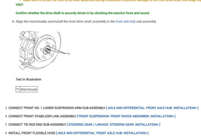

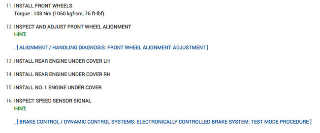

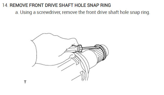

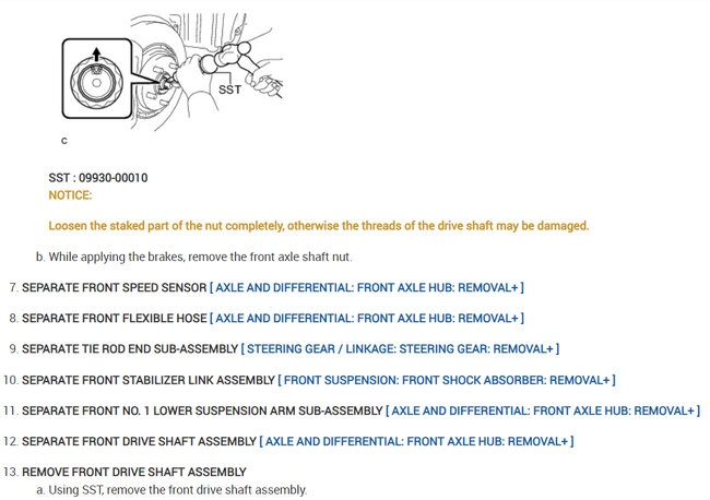

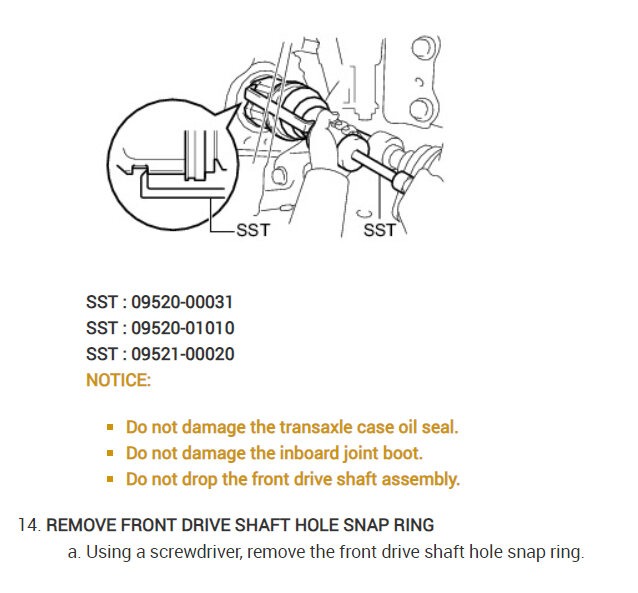

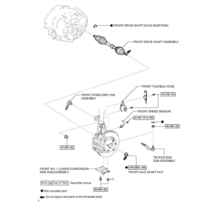

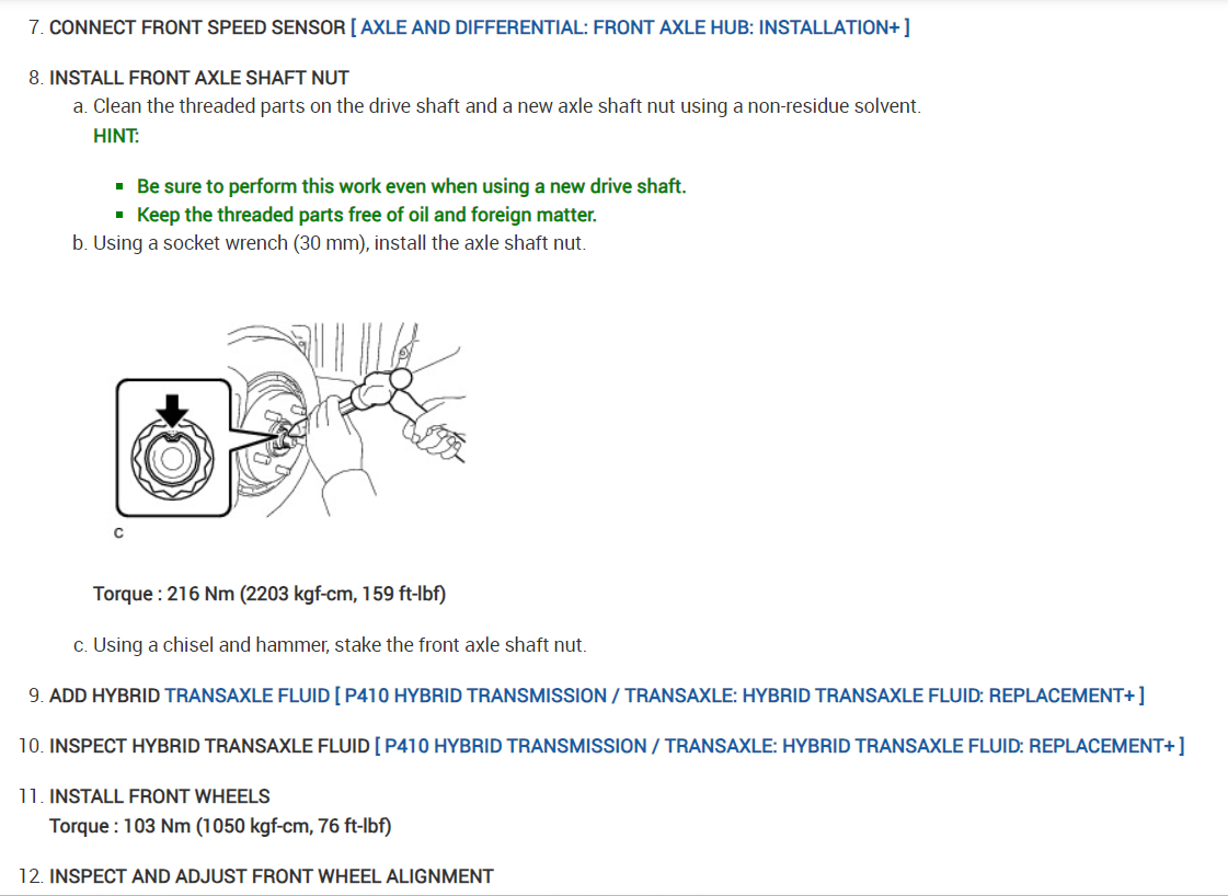

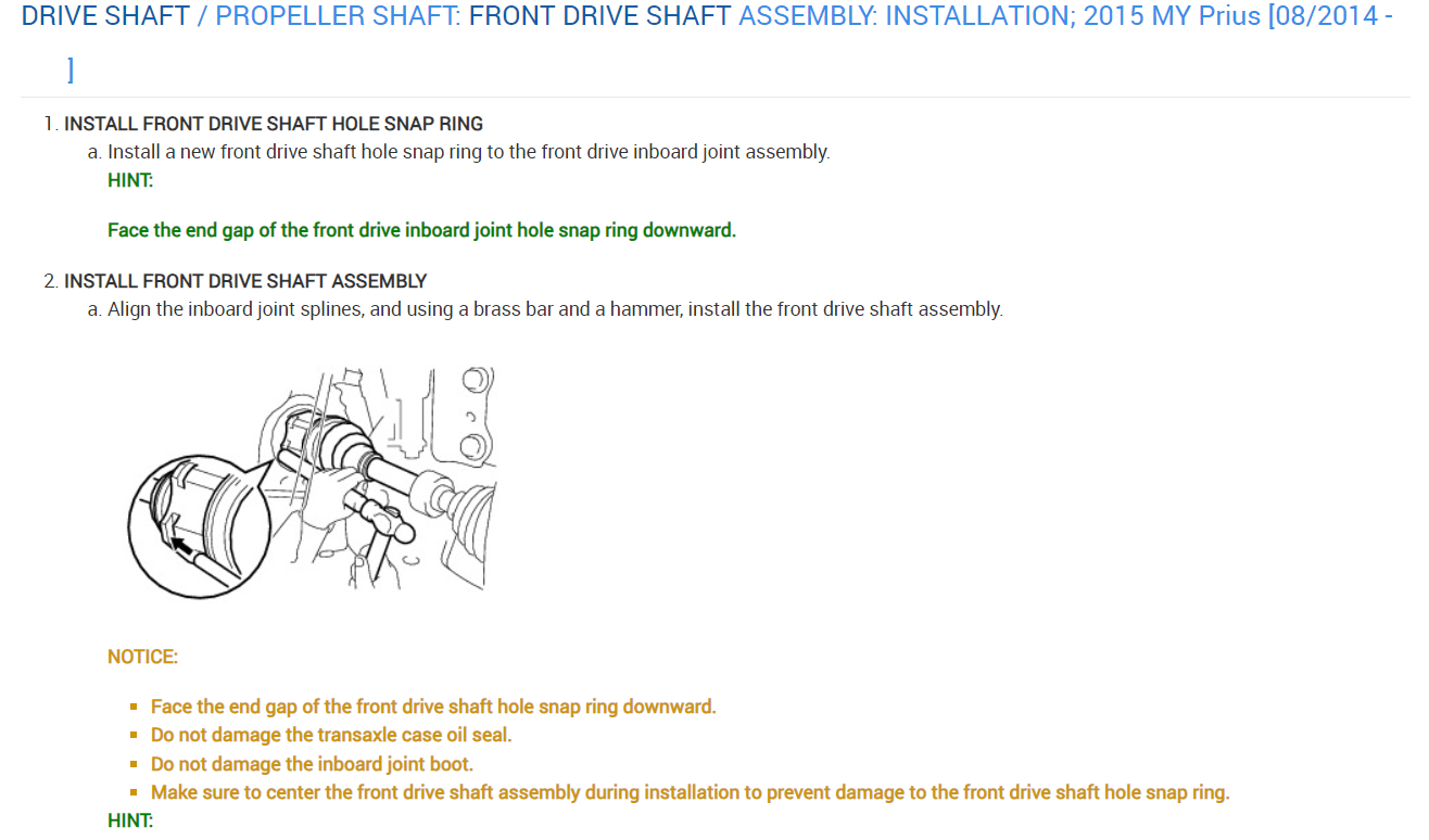

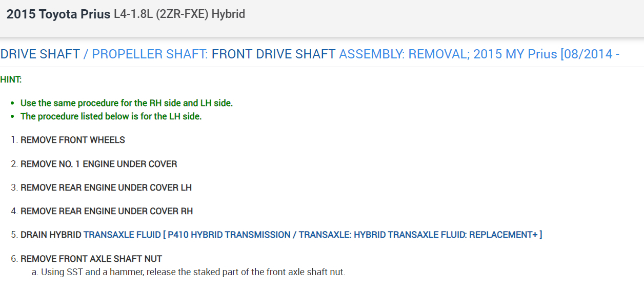

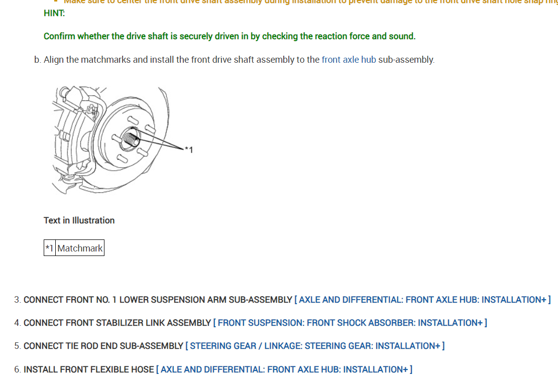

That's no good, the CV axle should make no noises so it should be replaced, I would do both of them. Here is a guide to help walk you through the steps with instructions for your car in the images below.
https://www.2carpros.com/articles/replace-cv-axle
Check out the images (below). Please upload pictures or videos in your response of any problems so we can see what to help you with.
