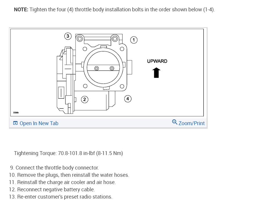

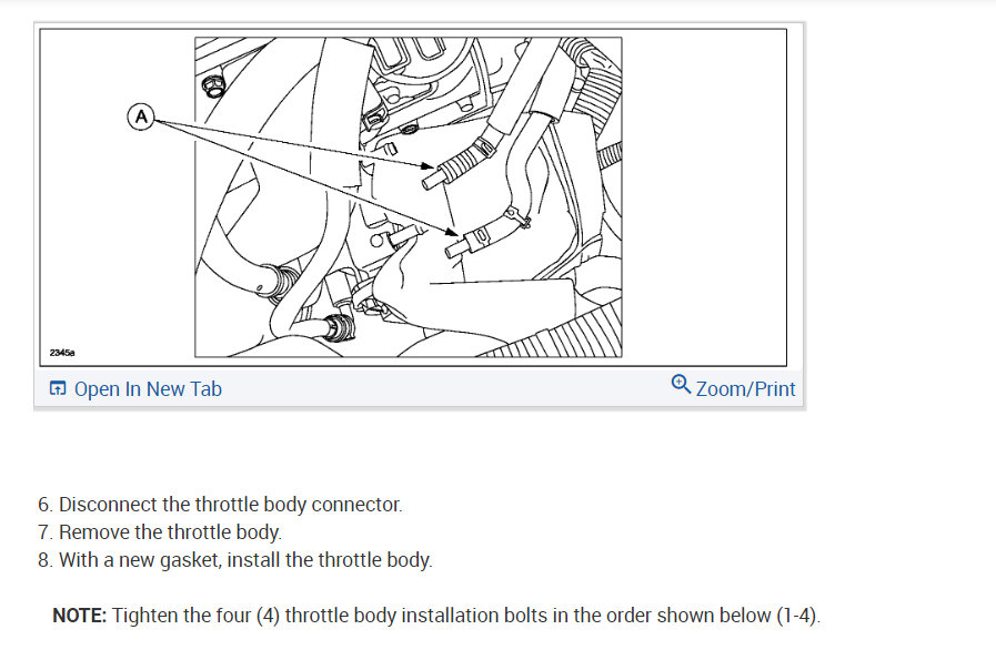

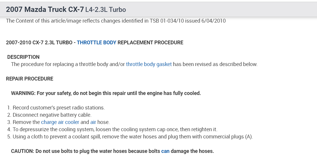

Yep, this happens when you have a vacuum leak, or the throttle body needs to be serviced. here are two guides to help us fix the problem with instructions for you can in the images below:
and use this guide when the engine is cold only.

I have seen a bad throttle bore or throttle pedal sensor go out and cause this issue with no codes. I would try cleaning the throttle bore first. Check out the images (below). Please let us know what happens.
