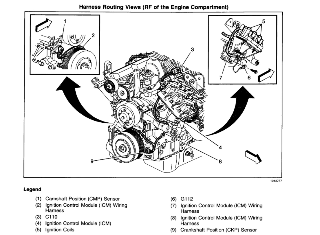

This could be either the crankshaft position sensor where the signal is dropping out or it could be the ignition control module which is common.
https://www.2carpros.com/articles/engine-stalls
I would remove the module and take it to a parts store and have it tested. It is a free service.

The ignition control module is not a sensor.
What other sensor beside the crank sensor did you replace?
