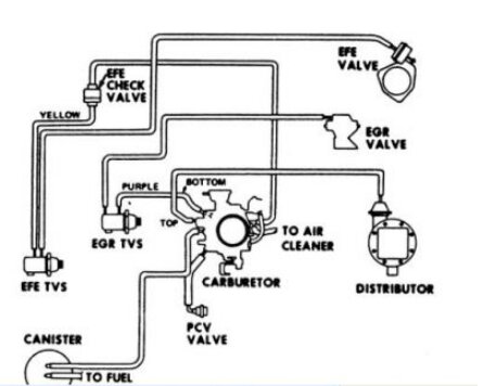

Cutting off and rough idle, can I get a diagram for the vacuum hoses?

I need a diagram of the vacuum hoses.

Sure, here you go, also check for vacuum leaks and a sticking EGR valve.

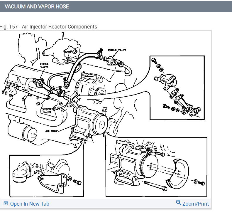

This guide may help:
Check out the images (below). Please let us know how it goes.
