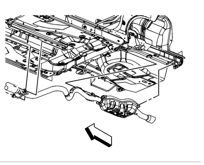

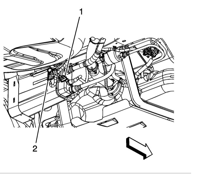

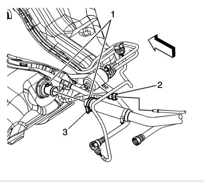

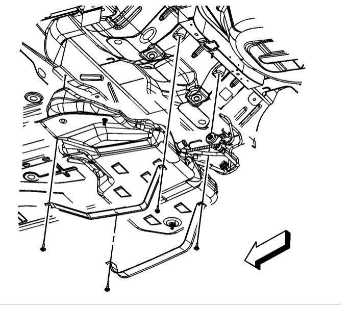

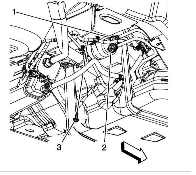

When driving my car, once the car warms up it will then start to jolt and drop revs and eventually the engine will cut out. Also it has trouble restarting while the car is warm.
Jul 22, 2017 at 11:04 AM
  • 55,433 POSTS

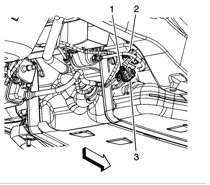

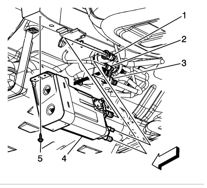

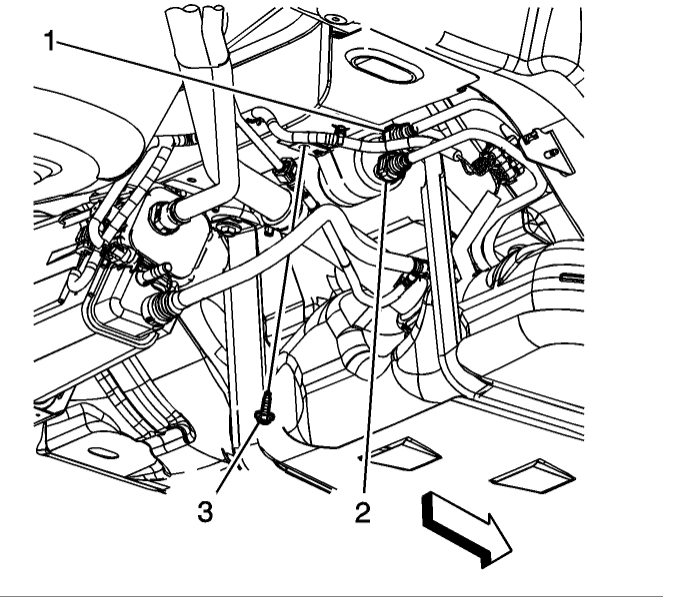

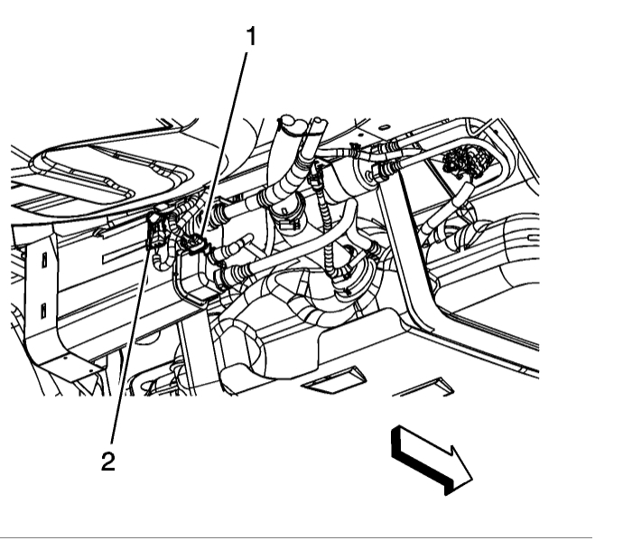

It sounds like you have a fuel pump going out which is common. Here is a guide to show you how to test it.
and
https://www.2carpros.com/articles/engine-stalls
Here are some diagrams that will help you change out the fuel pump.
