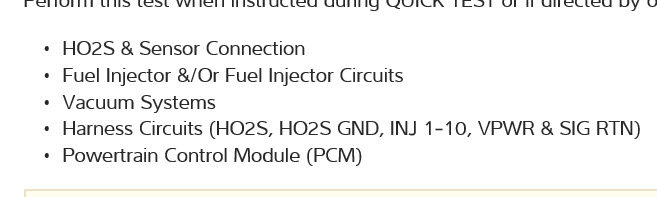

These are the codes that came up last night after I read the codes.
B1994
U1262
P0133
P1000
P1549
P0133 a second time but says it's confirmed.
I also have a problem with the air conditioner, It is blowing hot air and has automatic climate control. Could it be something I did when doing the plugs and coils/ Any help would be greatly appreciated.

the U codes is a communications bus problem it means one or two modules are not talking to each other like they should. a professional should look at this so he can delve in further to it. the B code is an air bag issue and p1000 is going to have a pro look at this as well. you can check for a vacuum line off for a/c but it has to be scanned by a local person anyhow so just take it in to fix all the stuff. the 133 code is what is in the picture, but could be caused by one of the other codes like the U code. same thing with the 1549 code.
