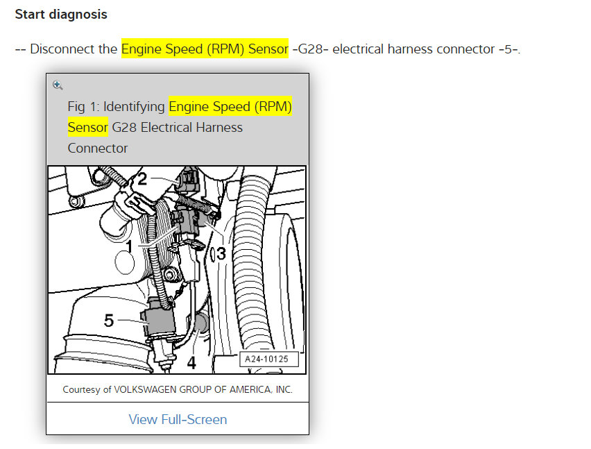

I am buying the car listed above it is a five speed. I was told the crank sensor needed to be replaced. It got replaced and now it will not start. I was told it was the computer failed due to the crank sensor problem. Does this sound right?
Jan 24, 2017 at 5:08 PM
CARADIODOC
  • 34,321 POSTS

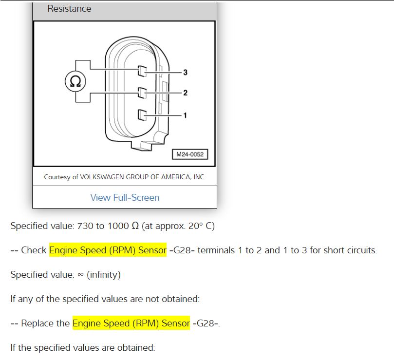

This sounds like you need to recheck the sensor and connector you could have a defective sensor here is the location. It is called an engine RPM sensor. Check out the diagrams (Below). Please let us know what happens.
