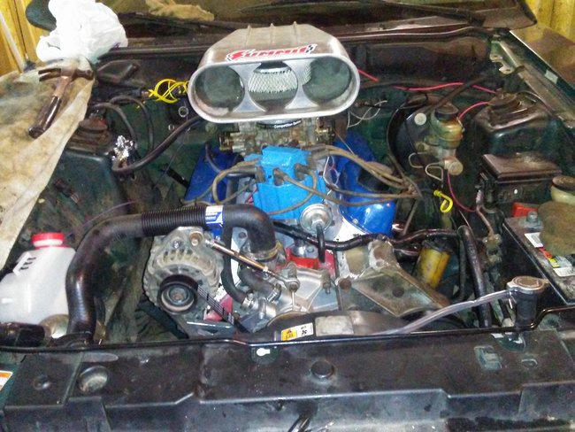

I'm decked 15 thousandth and bored 30 over on a '85 GT block. I'm running '97 Gt40P Mountaineer heads with spring upgrade and shaved 8 thousandth. A little Crane Cam with straight timing gear. A Typhoon intake with a 1" spacer under an original Carter/AFB 605S carb. I want to add a 200 shot of NOS eventually.
