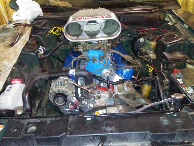

Cubic inch displacement?
1997 FORD MUSTANG
58,000 MILES
HOTSTANG
  • 29 POSTS
https://www.motortrend.com/how-to/28898-400-hp-302-small-block/
I'm decked 15 thousandth and bored 30 over on a '85 GT block. I'm running '97 Gt40P Mountaineer heads with spring upgrade and shaved 8 thousandth. A little Crane Cam with straight timing gear. A Typhoon intake with a 1" spacer under an original Carter/AFB 605S carb. I want to add a 200 shot of NOS eventually.
