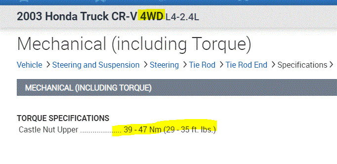

Need outer tie rod torque spec for the vehicle listed above.

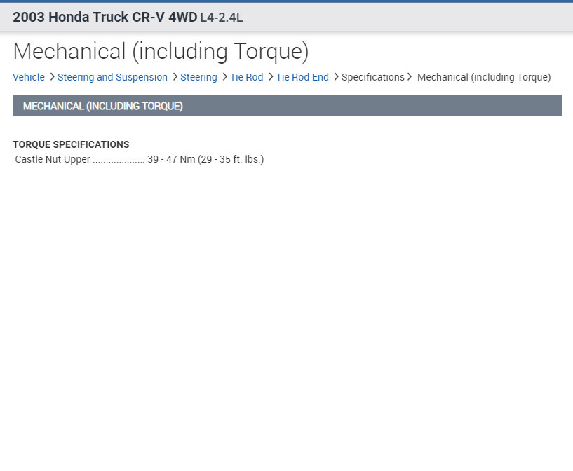

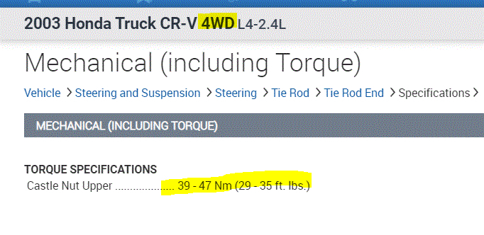

I wasn't sure if it was a 2wd or 4wd. However, after I found the specs for the 4wd and compared the two, they are the same.
If you look below, I attached it for you. Also, this should have a castle nut on it. Make sure to securely install the cotter pin.
See pic below.

The torque specification for the outer tie rod end nut is 29-35 ft. lbs.
