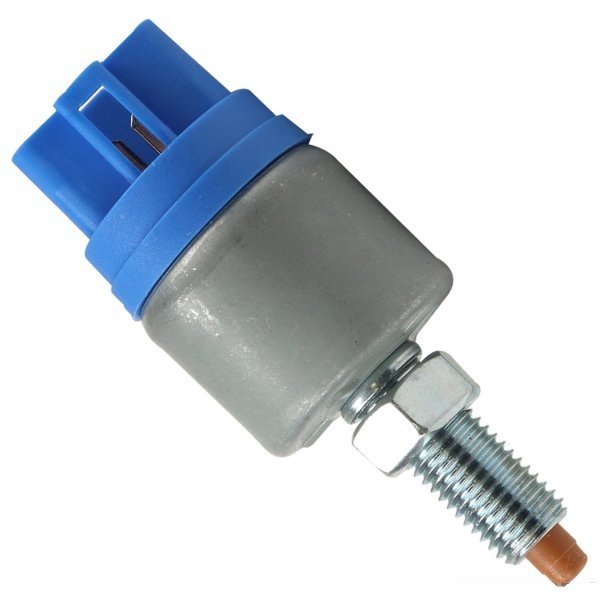

The cruise control stops intermittently and can shut it off with the control on the steering wheel and restart it but it keeps shutting off. Recommendations please?

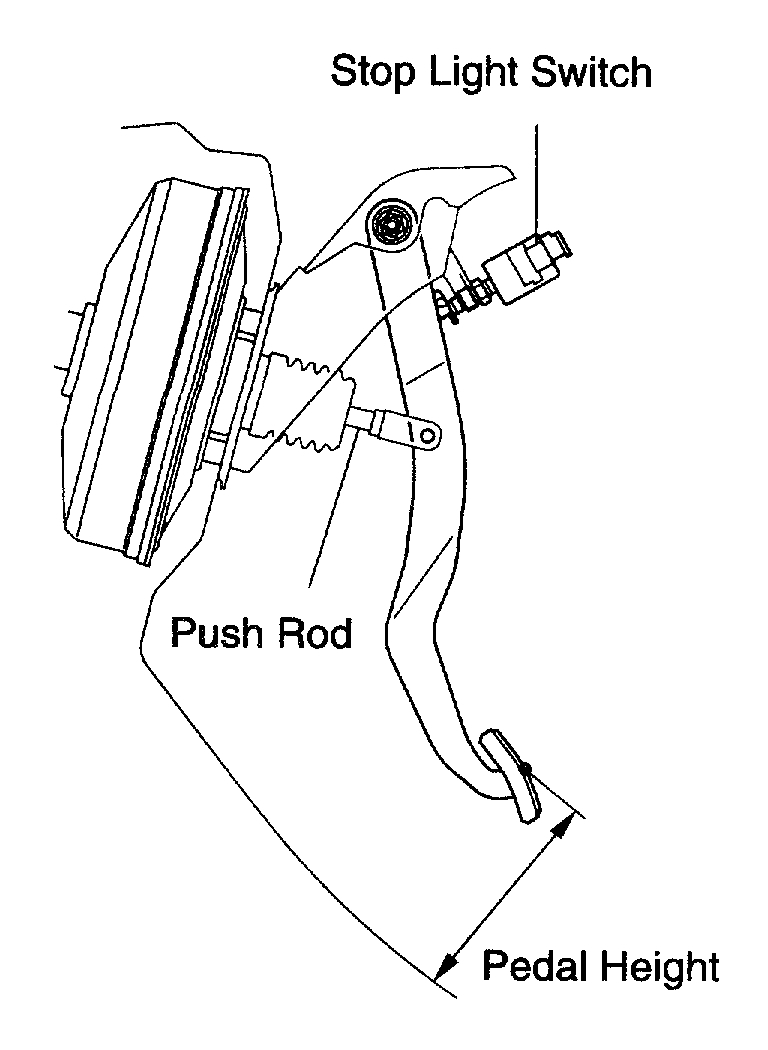

Welcome to 2CarPros. A common cause of this issue is a bad or wrongly adjusted brake lamp switch. Part of the switch is used to shut the cruise off when you step on the brakes. A quick test for adjustment is to use the cruise and put your toe under the brake pedal and lift it toward the dash, that holds the switch so it doesn't move. If the cruise now works without shutting off you have a switch that is worn or out of adjustment. To adjust it you can screw the switch in a turn. That would be the same as lifting the pedal. Personally I would replace the switch and adjust the new one so it is fully depressed when the pedal is at the stop.

Wow, i am 70 years old so i got a reclining lawn chair with a nice thick cushion and laid in that just outside the vehicle and wiggled my way in. I guessed right with 14mm wrench and turned the switch in about a turn and a half. I test drove it about 25 miles and presto!!! It all worked flawlessly. You deserve a donation directly. I don't like to give to most organization because they often bug the bejesus out of me for more and more. You know the deal!!! I would like to send you $40.00 via pPayPal please for your time and knowledge!!! Please say yes! God bless you. Jack Ellenberger.

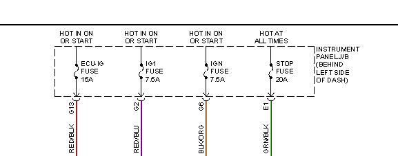

I have the same problem as the other guy who has a 2002 Toyota Highlander with the cruise control problem. My car and cruise control not engaging are the same as his. Mine started failing at 275000 miles. Controls work, lights work, cruise does not engage.

check four fuses inside car see pic, and then have scanned as it may be an ecu problem.
