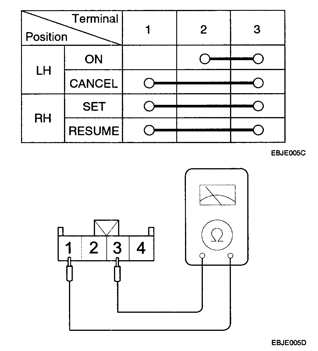

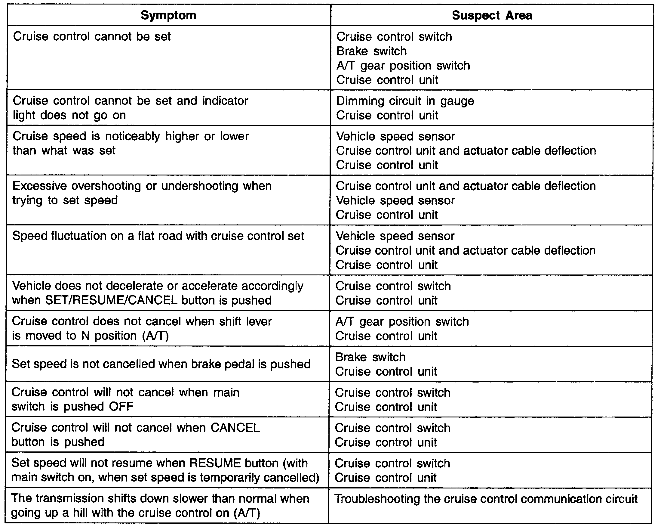

i have replaced brake light switch, the control module under hood. no ABS light on. what else do I need to do?

Okay. If it isn't working at all, it could be a servo, module, cable, switch, and so on. I am going to provide the diagnostics related to checking the switch and then the unit. Before you get started, make sure to check the fuses listed at the end of the diagnostics listed.

CRUISE CONTROL MAIN SWITCH
1. Operate the switch and check for continuity between the terminals.
pic 1
2. If continuity is not as specified, replace the switch.

TROUBLESHOOTING
see pic 2
NOTE: Before troubleshooting:
- Check the No.4 (10 A), No.14 (10 A), No.19 (10 A) fuse In the passenger compartment relay box.
- Check ECU #3 (10 A) fuse in the engine compartment relay box.
- Check that the horn sounds.
- Check the tachometer to see if it works properly
