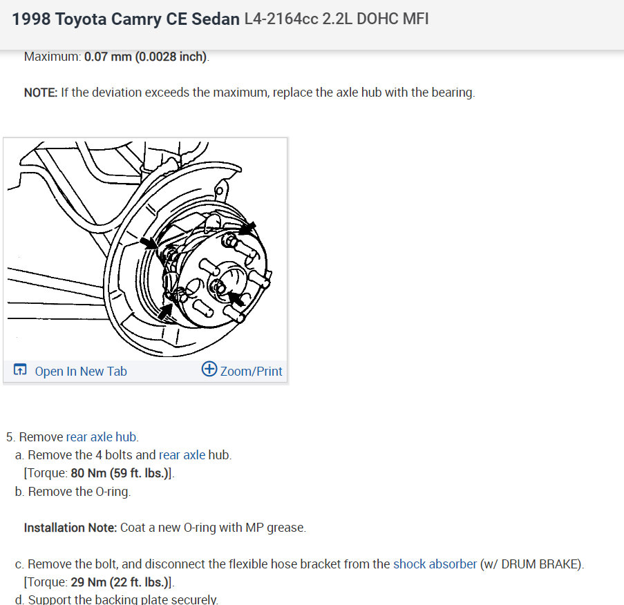

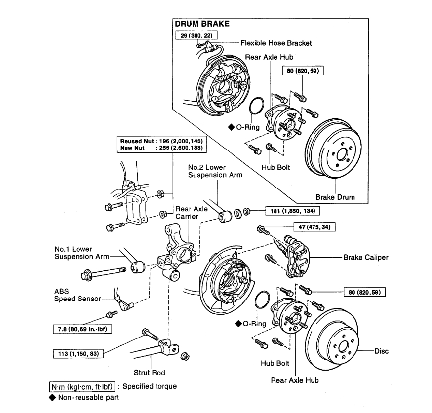

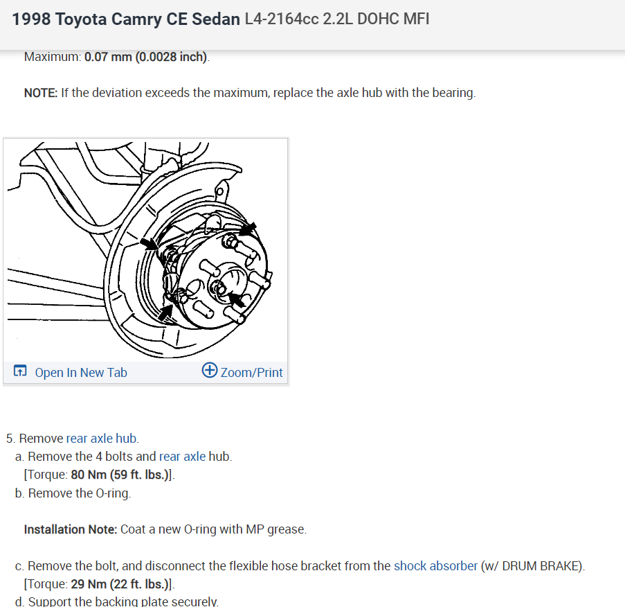

That sounds like a wheel bearing hub. I would raise the rear of the car and grasp the wheel to check for play, also, spin the wheel and listen for the bubling noise. If either of these are present the hub is bad and needs replacement. If nothing is found raise the front of the car and do the same thing. Please go over this guide as well
https://www.2carpros.com/articles/7-common-symptoms-of-a-bad-automotive-bearing-hub
Here is how to change out the bearing hub on the rear in case you need it.
This guide should help as well:
Check out the images (below). Please let us know what happens. Thanks for the video, it helps.

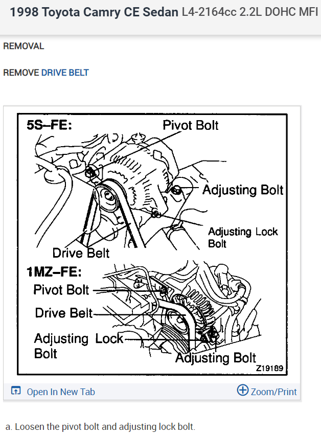

No, the bearing hubs will not make the noise, I read, "behind my back rear tire" and I assumed you were driving, no problem, lets remove the serpentine belt and start the engine to see if the noise goes away, if you could upload a video of the noise it would help. Here is how to remove the belt, do not run the engine for more than 1 minute. This will let us know if it is an engine accessory or something internal like a timing belt. Check out the images (below). Please let us know what happens.
