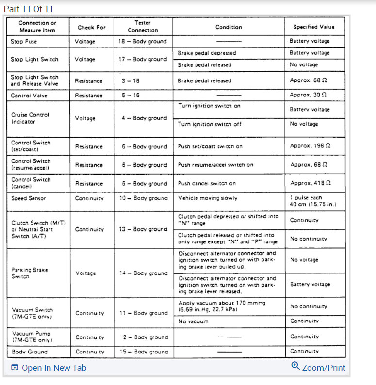

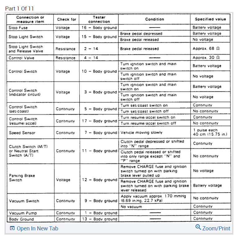

Cruise control works an doesn't work intermittently. When it doesn't want to work, the cruise control indicator light flashes 5 times and it will not come back on until you turn the ignition off and restart the engine, and even then you have 50/50 chance it will work properly. Note: It seems to not work at all only on the first try every time. If it works the very first time after starting the engine, it usually works from there on out. Could someone help please?

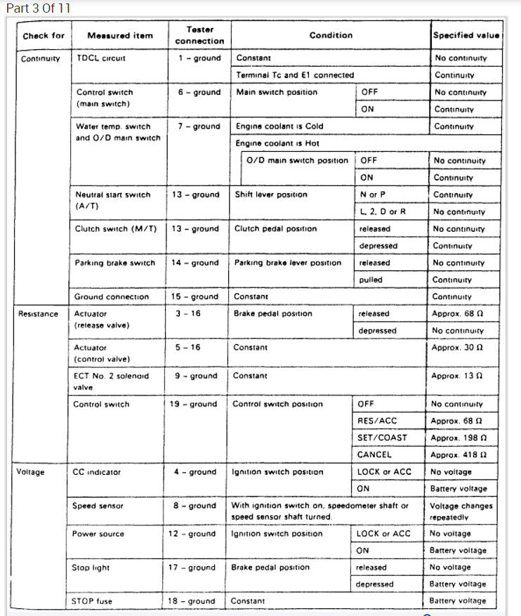

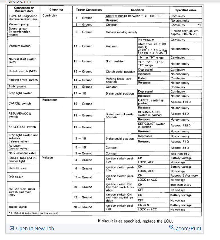

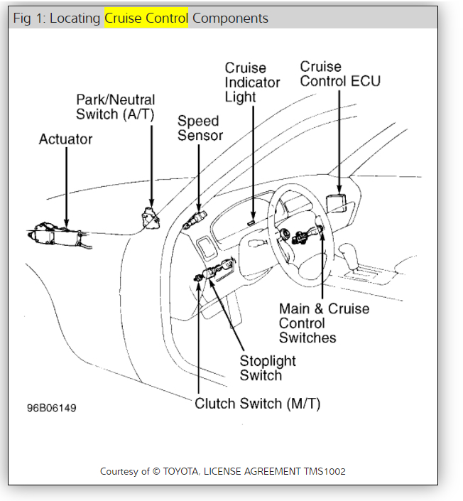

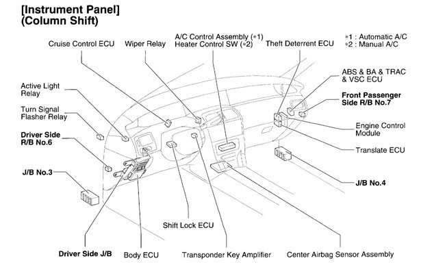

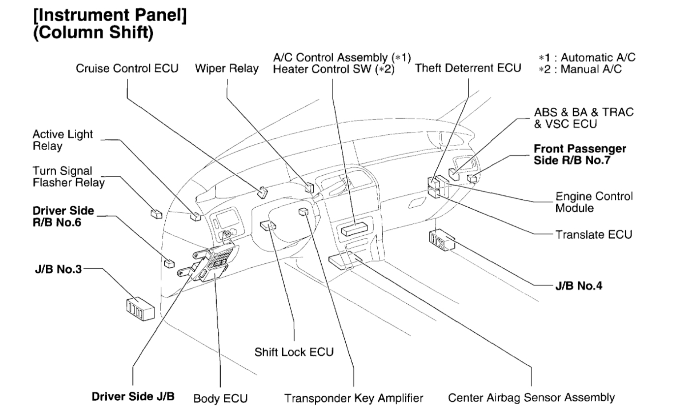

it sounds like the cruise control ECU has gone bad. here is the location so you can try replacing it. Check out the diagrams (below). Let us know what happens and please upload pictures or videos of the problem.

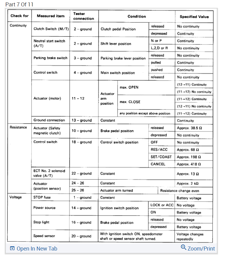

With respect sir, I really want the Toyota Service Manual troubleshooting procedure before that can be determined. I have a Toyota Engine Service Manual but it has no info on troubleshooting the Cruise control circuitry. What does the blinking (5) times mean? PC?

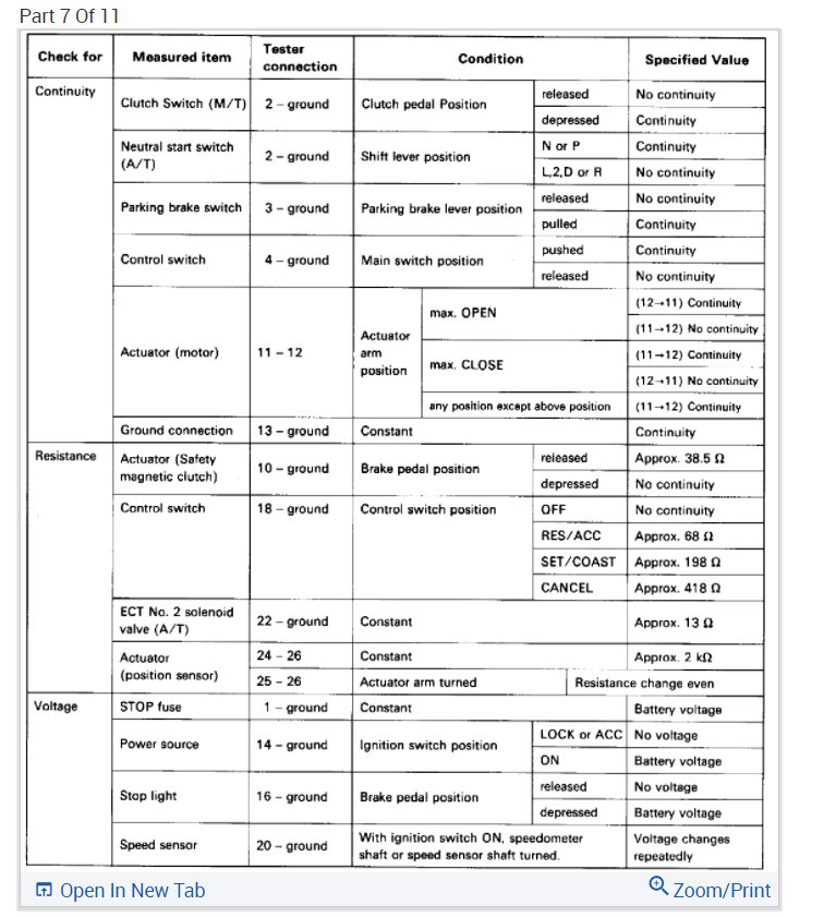

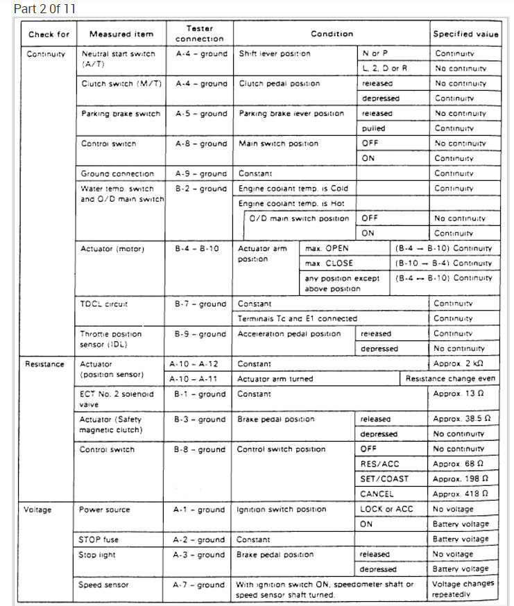

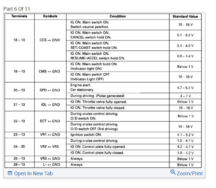

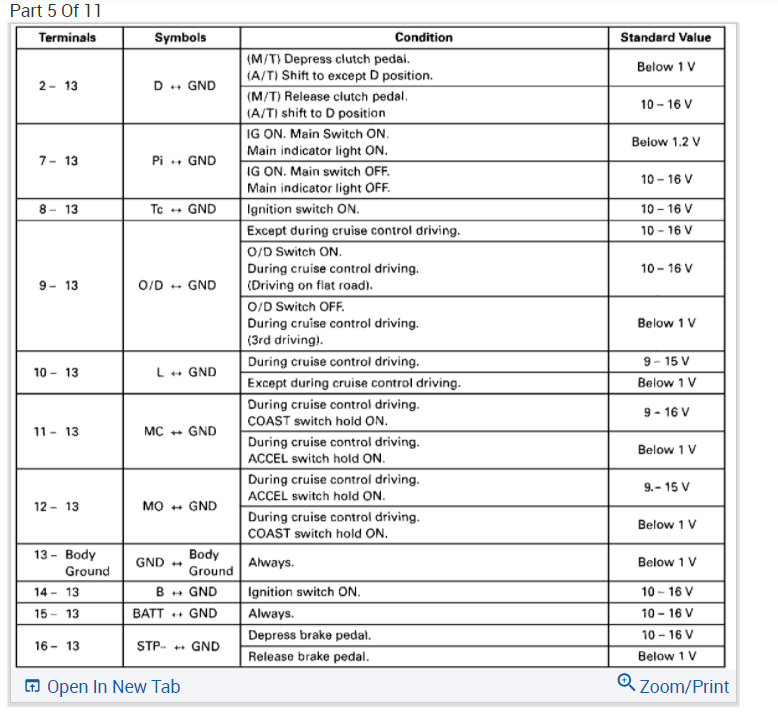

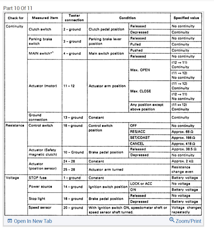

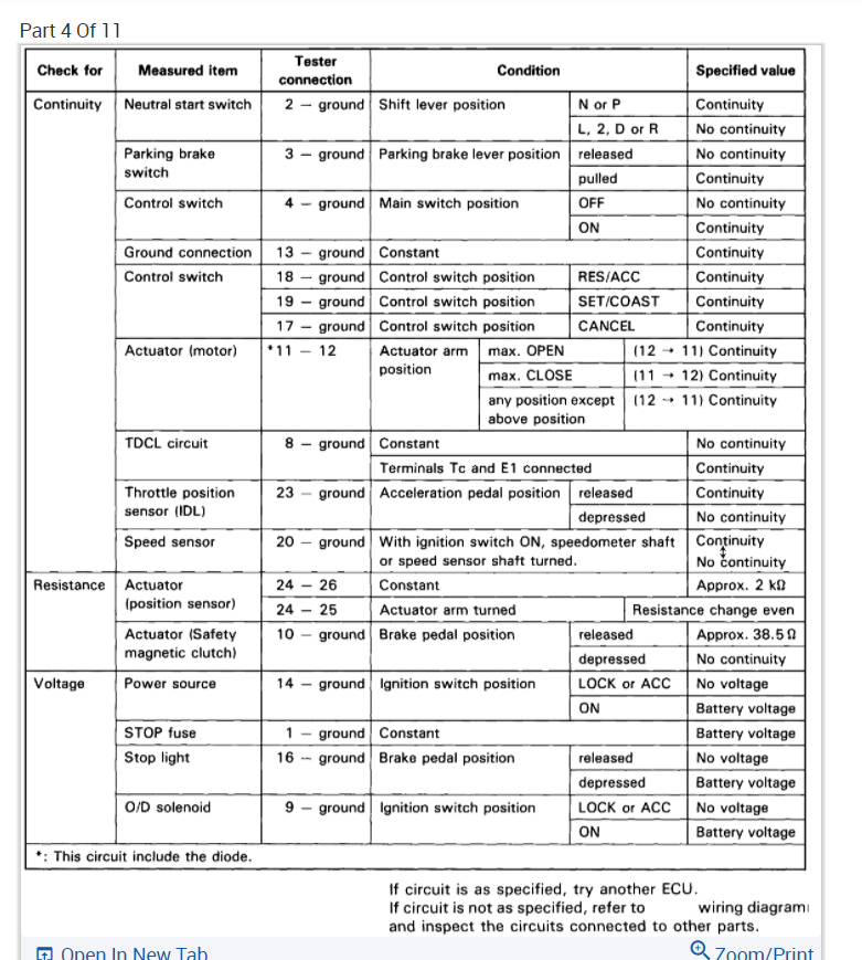

The blinking light means there is an operational l error. This guide can show you how to get the codes:
Here is the factory testing procedures. Check out the diagrams (below). Please let us know what you find.

Hello Ken, upon further testing of the Cruise Control System, I've uncovered a very simple but illusive type problem. The switch on the column is the culprit. I did two separate experiments with the switch. First I press down on the lever to activate the Cruise Control like I would normally, using a moderate amount of force, which failed the test (error code). Second, I press the lever down with liberal force and the test passed every time. The contacts inside the mechanical switch are dirty (not making good contact) or it is a defective switch.
