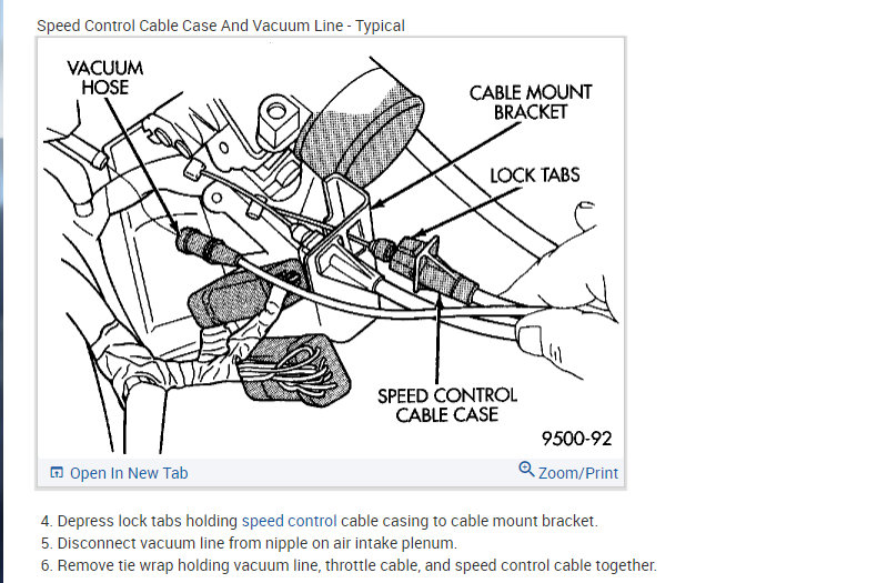

I recently replace the transmission filter pan and gasket. Also I replaced the radiator. However, my cruise control will turn on but it won't engage and take over. I'm hoping my transmission is not on its last leg. Any idea how to fix this.
Mar 4, 2021 at 5:30 AM

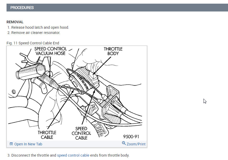

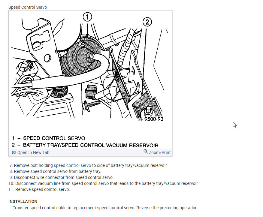

I doubt the transmission is related to this. The cruise control is just a cable and servo that holds the throttle plate and the needed position to hold the speed.
If the switch turns the light on and it comes on but the speed does not set then the issue is most likely the servo which is what moves the cable to the proper position.
I attached the complete process below on how to replace this as this is what I would do and retest the system. Let me know if you have questions. Thanks
