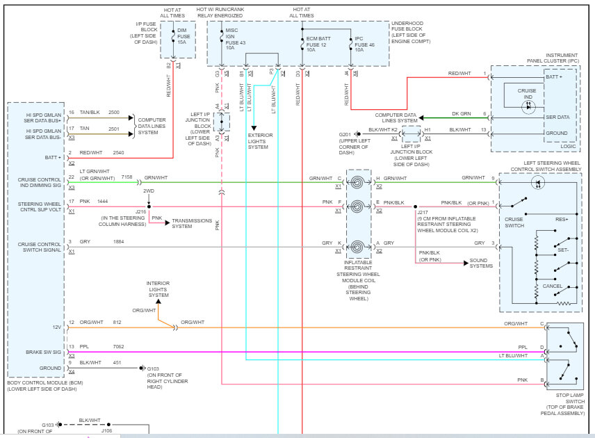

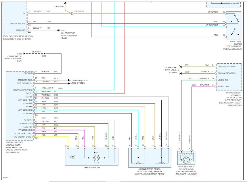

My cruise control doesn’t work. The light on the button lights up but the dash light doesn’t work, nor does it set the cruise. I am trying to find the wiring diagram for the entire cruise control system including interior panel fuses and main panel fuses. Thanks

See attached for the cruise control wiring schematics.

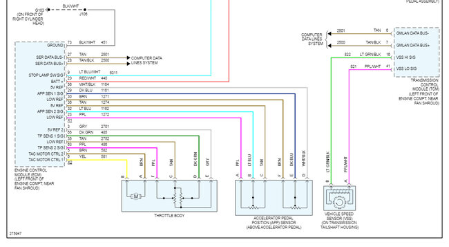

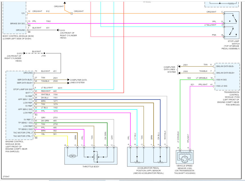

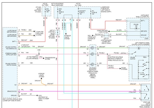

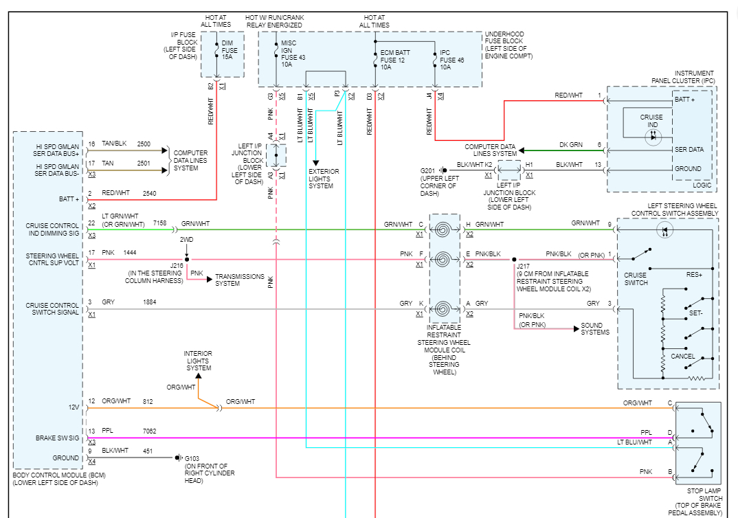

As far as the cruise control not working, it could be a few things. The fuses related to the circuit are in the under-hood fuse box. The system requires the body control module (BCM), transmission control module (TCM), and engine control module (ECM) to function.
If you look below, I attached the entire circuit related to the cruise control. It identifies the fuses, modules, and wiring color.
I hope this helps. Let me know if you have questions.
See pics below. Note: I had to cut the pic in half to make it readable for you. I did overlap them so you can follow from one to the next.

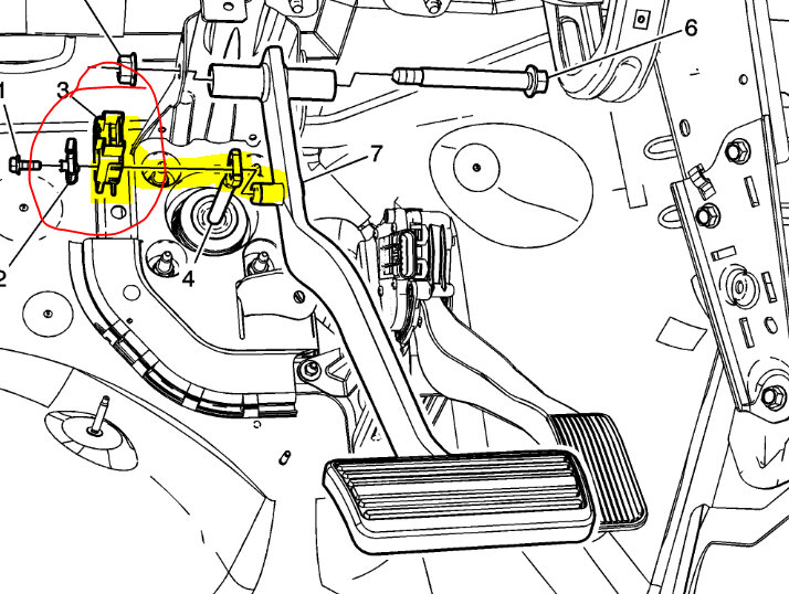

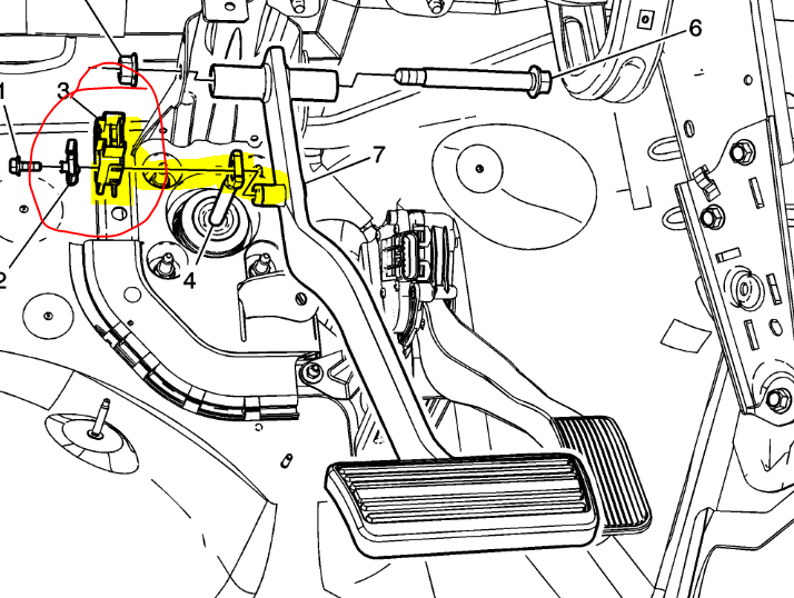

It goes a couple inches and then feels like a normal brake pedal. I'm thinking there’s just air in the lines. All of the brake lights are working as they should. And I meant the little switch that tells the truck when the brake pedal moves from its resting position. I can try and check the CAN thing later. Thanks

Are you referring to the brake lamp switch? I attached a pic below showing it.
Oct 25, 2022 at 10:47 AM
421JMS
  • 6 POSTS
Yes, that part. Sorry lol, I couldn’t remember its actual name.
