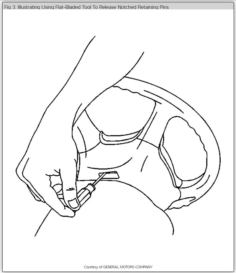

Couple of weeks ago, while using my cruise control, suddenly a burning smell occurred in my truck for a brief moment like a burning coil and after that, the cruise control stopped working. there is no light on the dash showing on. I later read online to see what the cause is and in general is all about brake light switch replacement. Even though my brake lights are not burnt out and just to my curiosity, I replaced the brake switch with a spare on hand to see if the will be any luck and there was not. Scan reader did not picked out any codes. This brings me back to one of your pro mechanics (HMAC 300) who wrote below as coat "(Have a pro scan for codes it may be the coil in steering wheel is bad or a body module problem. Could also be a lan problem). Uncoat""So, how do I get to this coil? what does it look like? is it replaceable as a DIY?what is the official part name of this coil? A solution to this issue will highly be appreciated.

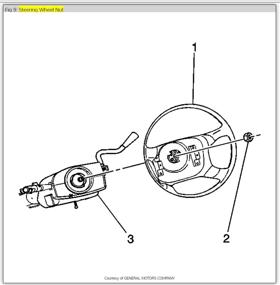

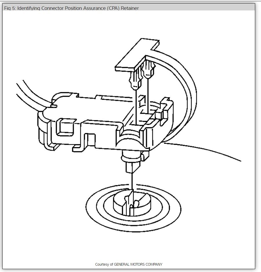

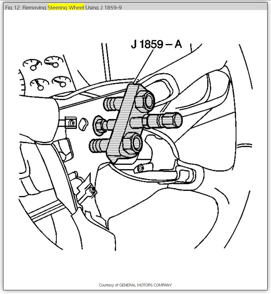

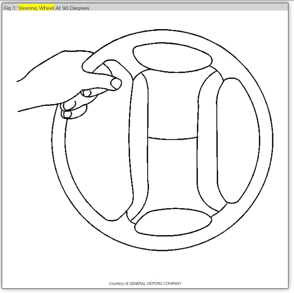

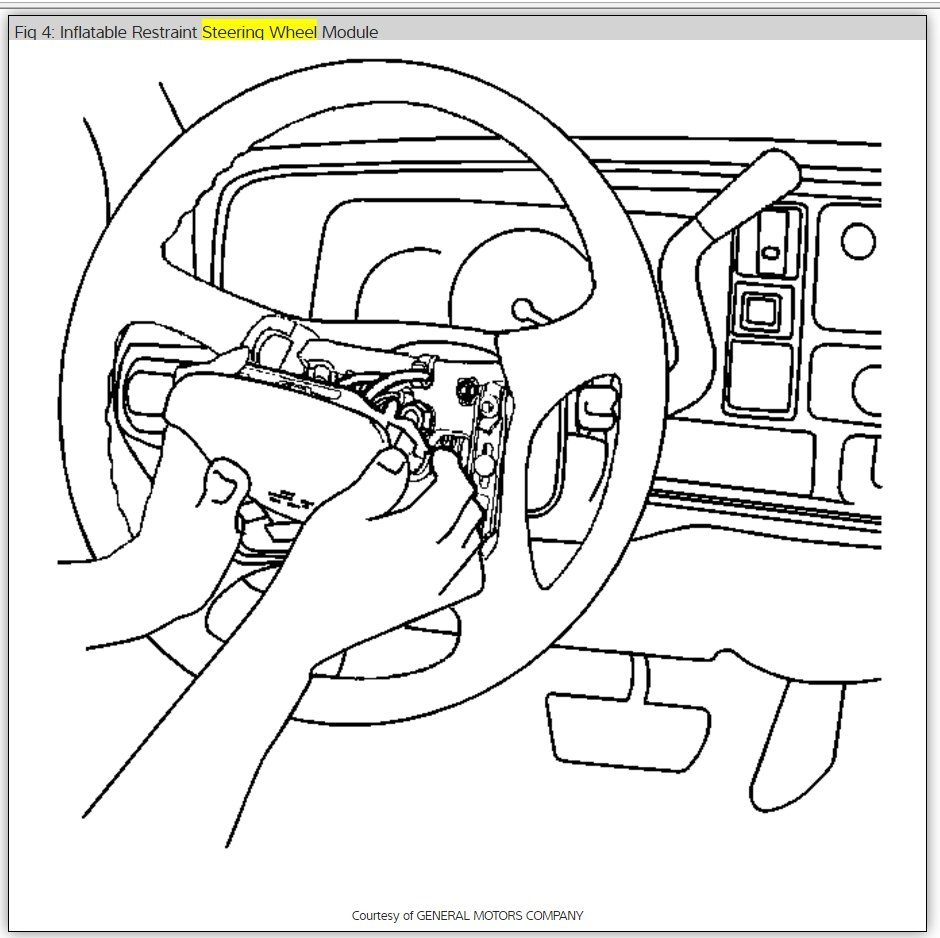

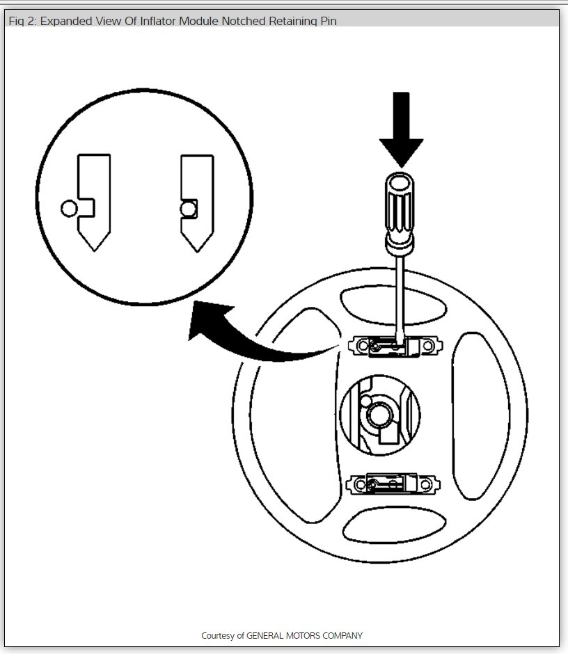

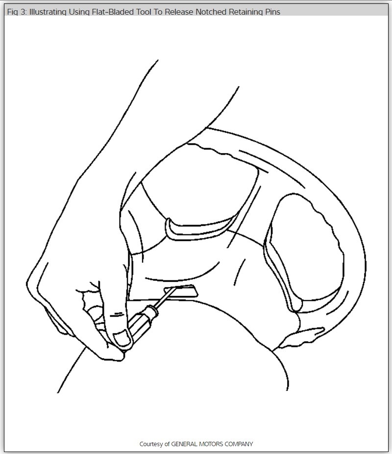

Yes the clock spring as it is called can be replaced by removing the steering wheel. This is a high failure part. Here is a guide and some diagram (Below) so you can look at the job to see if its something you want to do. These guides give you an idea you car will be a little different and the steering wheel will need a puller.
https://www.2carpros.com/articles/air-bag-removal-steering-wheel
and
https://www.2carpros.com/articles/steering-wheel-clock-spring-removal with video

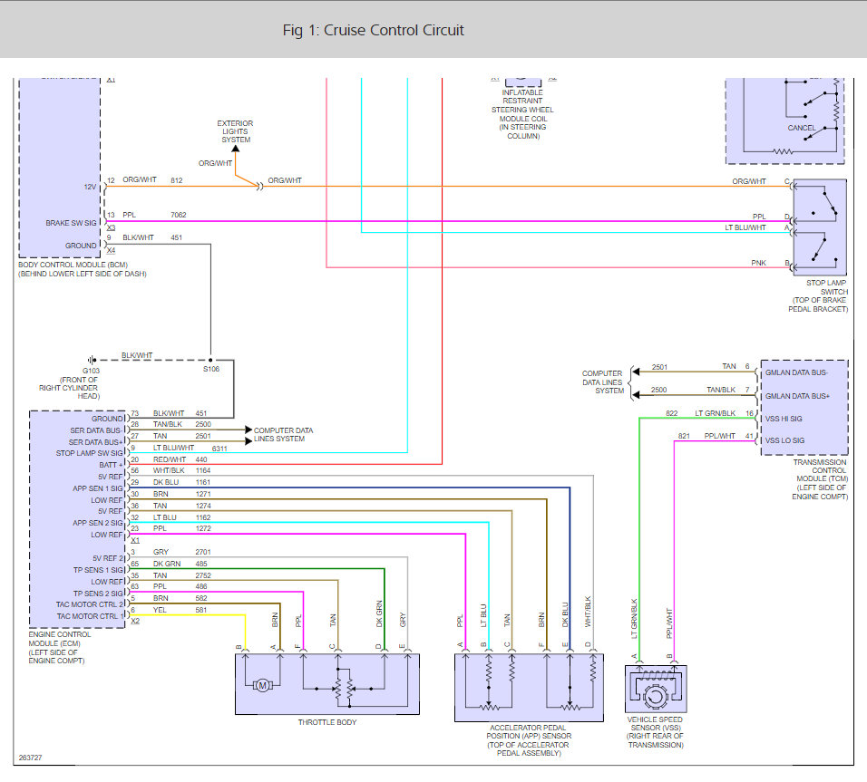

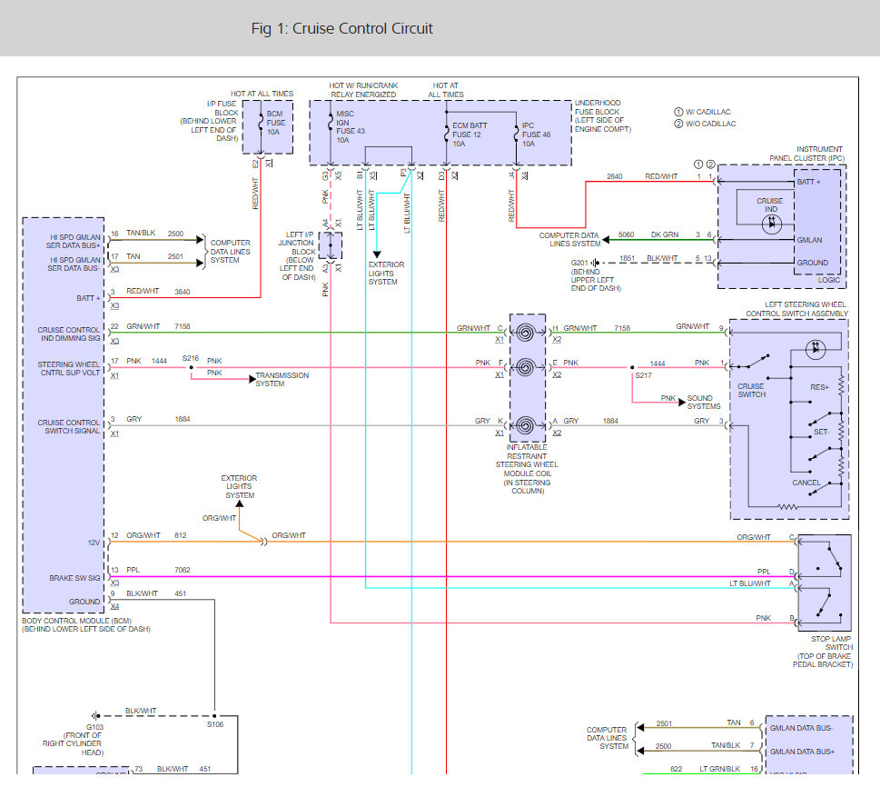

I have replaced the clock spring from Dorman type 525-032 & I still have no cruise control working. I'm 100% sure a burning smell came around underneath the steering column wiring harness. This could be another waste of bucks, but before getting another clock spring from the dealership which comes with the whole wiring harness and not like the one from Dorman, what next should I be looking at? Some answers will highly be appreciated. Thanks

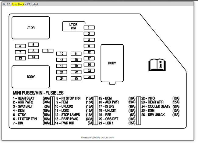

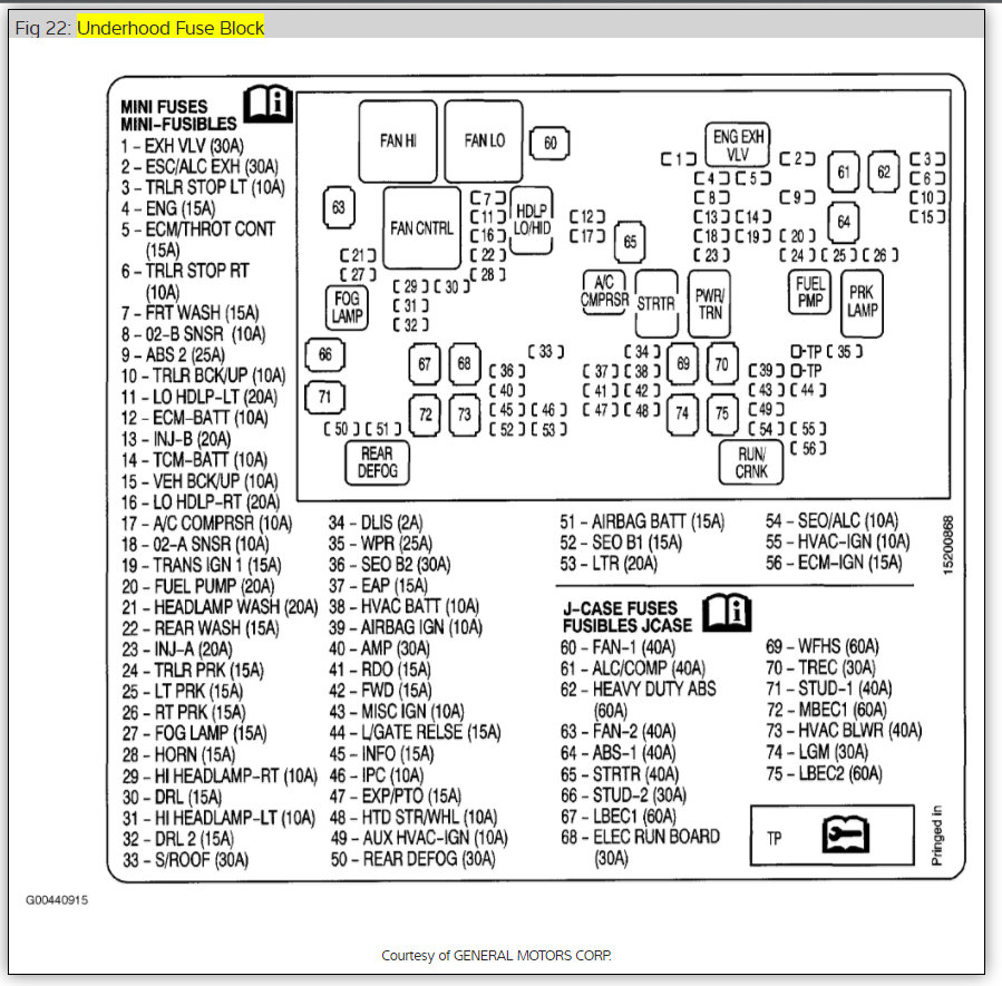

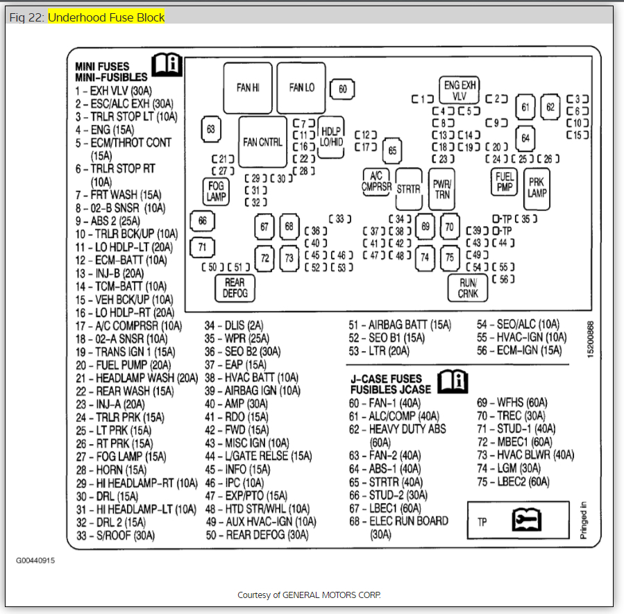

It may have rubbed some wires through or something, you will need to inspect the wiring, here is a wiring diagram and the fuse locations so you can keep testing.
and
Sep 11, 2017 at 2:50 AM

Hello Ken, is been awhile. I had a shop used their scan tool to check for further problems and nothing has been found after checking the wiring diagram my self. Miraculous, the cruise control has started working again after the professional scan tool was used. Could this be the scan tool has changed something. But overall, I’m happy to see it working. Thanks
Nov 12, 2017 at 10:37 PM
  • 55,423 POSTS
You gotta love a car that fixes itself :) Thanks for getting back to us
