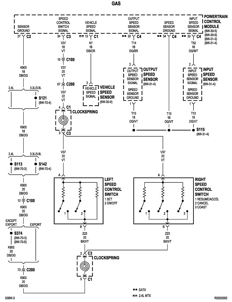

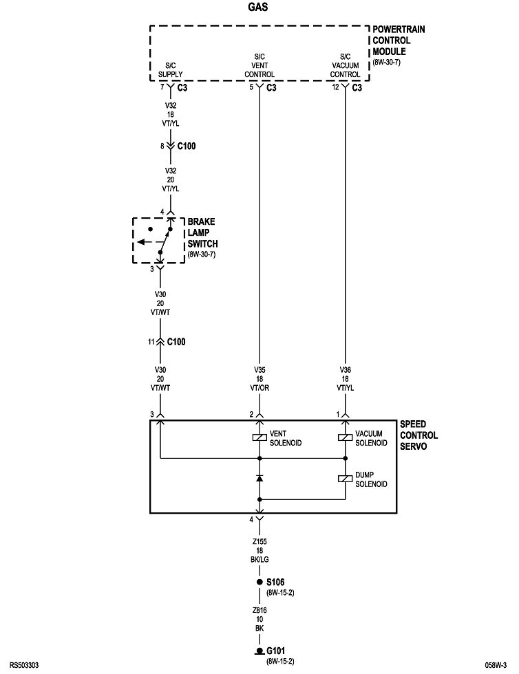

Here's the diagrams for the cruise control system.
You might also read and record any diagnostic fault codes to see if any are set related to this problem. You can do that yourself by cycling the ignition switch from "off" to "run" three times within five seconds without cranking the engine. Leave it in "run", then watch the code number show up in the odometer display. The people at many auto parts stores will also read them for you for free, but most of them can only read codes in the Engine Computer, and sometimes in the Transmission Computer.
Once you know the exact fault code number(s), you can go here:
https://www.2carpros.com/trouble_codes/obd2/p0500
to see the definitions, or I can interpret them for you.
