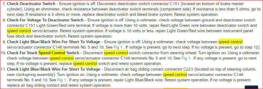

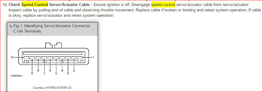

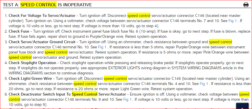

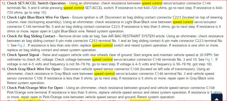

I would like to know where the cruise control is located, and if possible having a picture of that module,
Thank you
Sep 27, 2018 at 1:47 PM
DANNY L
  • 5,648 POSTS
Hello, I am Danny.
The cruise control does not have a module. I have attached a step-by-step instructions how to test the cruise control system. I have also attached a tutorial on wiring testing as well. Hope this helps and feel free to ask any questions. Thanks for using 2Carpros.
Danny-
