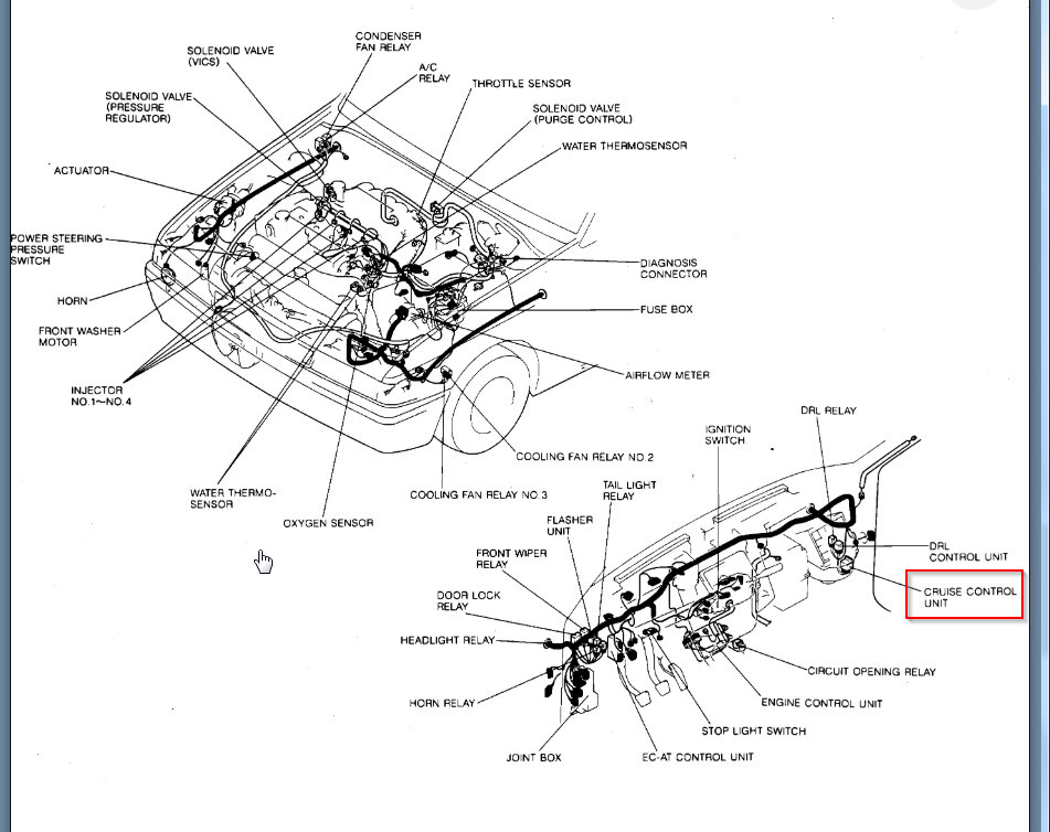

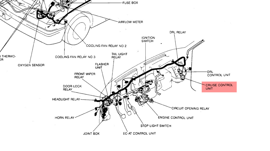

I'm needing to replace my cruise control module, however I'm having trouble locating it on the vehicle. Can you help me out?

Here is what I found, hope this helps!
Image (Click to make bigger)

I attached the location diagram and circled the unit. It is on the passenger side under the dash. Let us know if you need more info. Thanks
