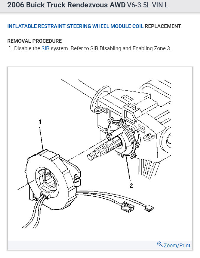

As above, have had the following repairs made: TAC module had no signal to cruise control - replaced module/throttle body, cleared codes. Worked once on test drive, but did not work after that. Was told the ECM needed to be replaced, did that and it still would not work. These were done at a reputable service department at a dealership, so I am assuming they did check the fuses/relays. I have spent lots of money to repair this car and it is not happening.
Sep 9, 2018 at 12:24 AM
  • 55,797 POSTS

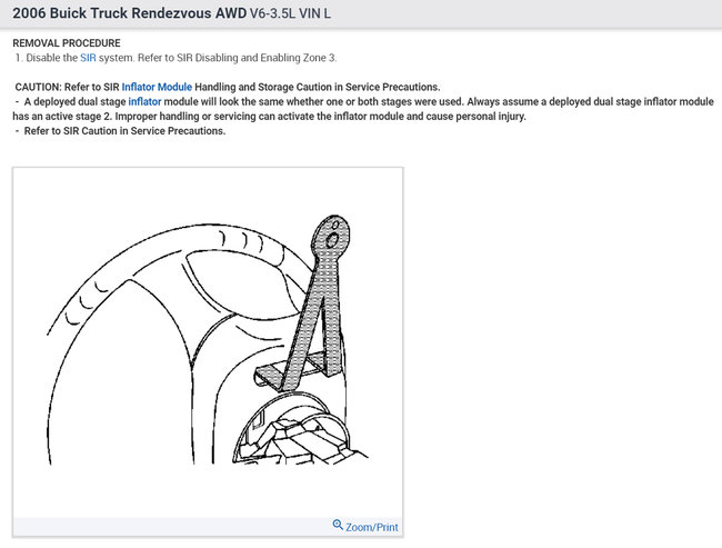

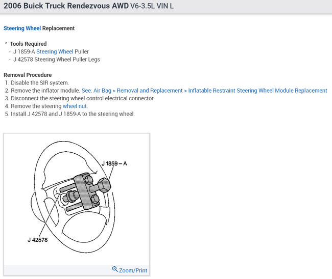

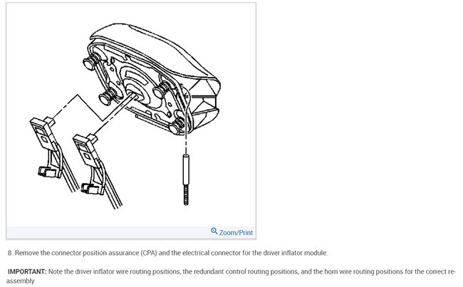

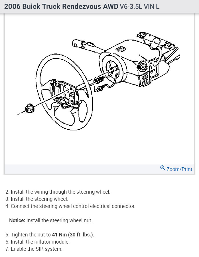

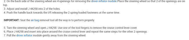

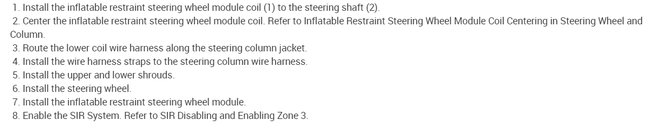

I have seen this problem before, the clock spring behind the steering wheel has an intermittent short circuit. Here is a guide to help you see what you are in for when doing the job plus diagrams below to show you how it will be for your car:
https://www.2carpros.com/articles/steering-wheel-clock-spring-removal
You will need to remove the airbag and steering wheel.
