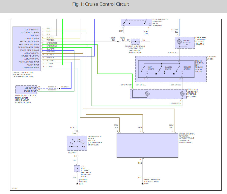

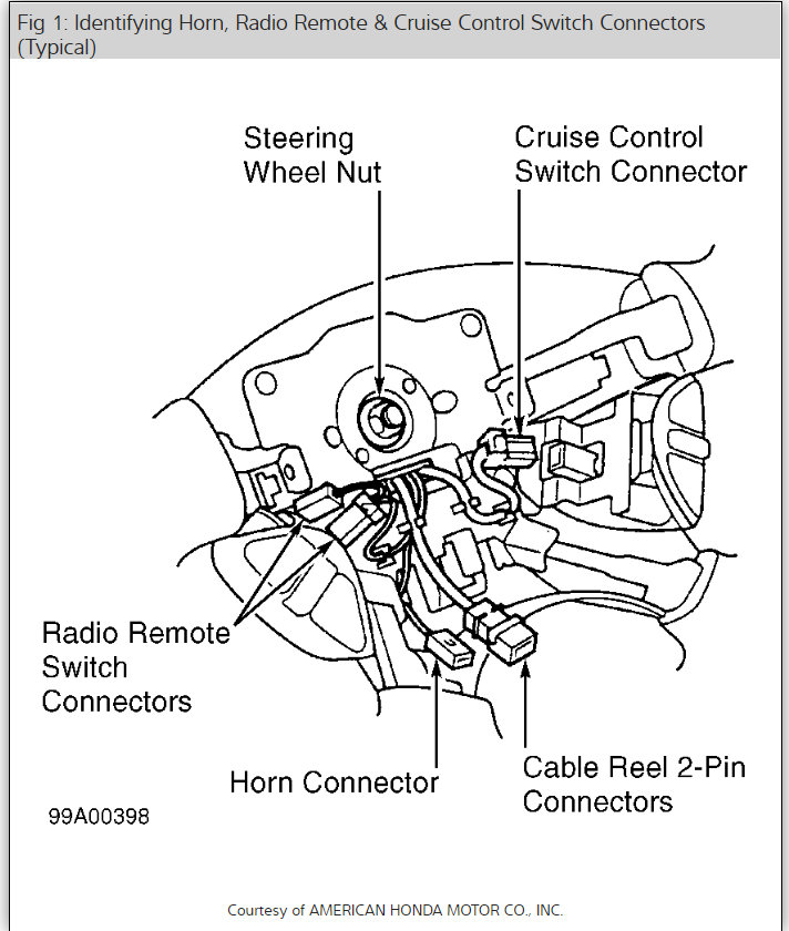

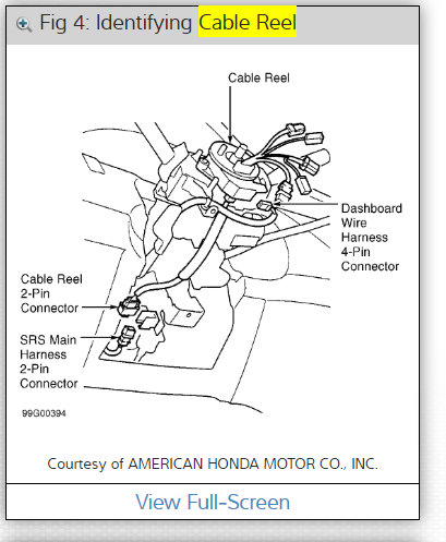

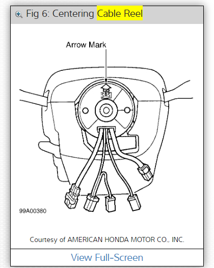

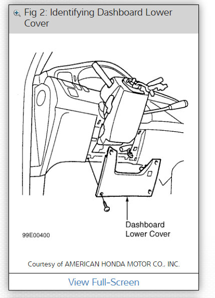

Yep, these cars had a problem with the clock spring behind the steering wheel losing connection to the cruise control, but to be sure here is a guide to help you test the wiring to confirm the issue:

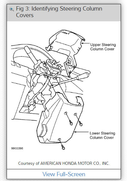

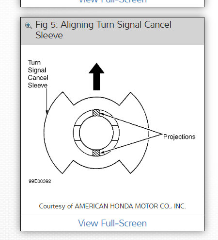

and if bad here is a guide and diagrams on how to do the job:
https://www.2carpros.com/articles/steering-wheel-clock-spring-removal

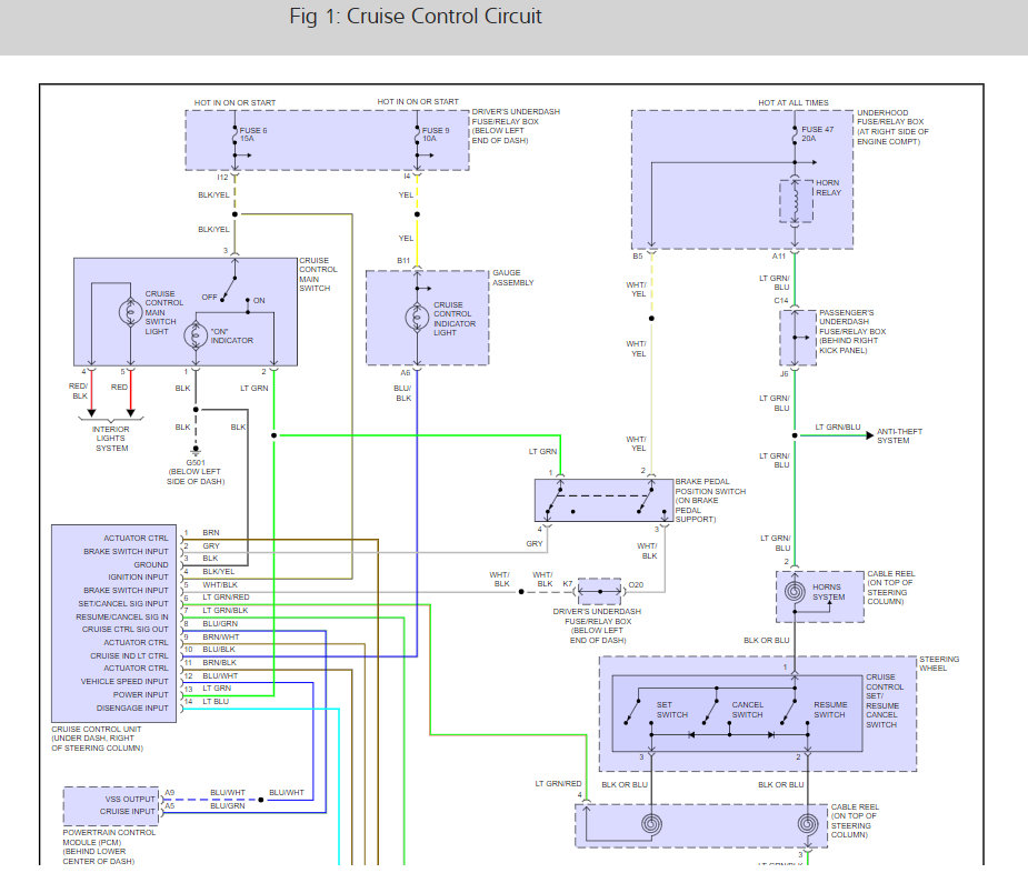

Check out the wiring diagrams so you can see how the cruise works (below). Please let us know what you find.

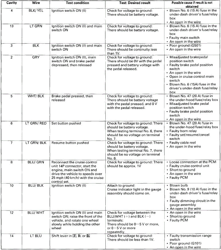

From your description it sounds like the cruise control either is not getting a speed signal (vehicle has to be travelling over 25 mph for it to set) or the servo under the hood is failing and that is causing it to not operate. The attached is the test chart for the cruise unit under the dash, it however does not show if the unit is getting a speed signal. There are also a few transmission codes that can deactivate the cruise control but not activate the CEL. To see those you need a good scan tool that can read the transmission and the cruise control module and test it and the servo.

Just for my own knowledge, are the pictures and links specific to my 2002 Honda Odyssey or are they universal and are the same on all cars?
I will let you know what I find with the testing.
Oct 11, 2018 at 11:20 AM
STEVE W.
  • 15,352 POSTS
All the diagrams are specific to a 2002 Odyssey. The clock spring and wiring test are more generic.
