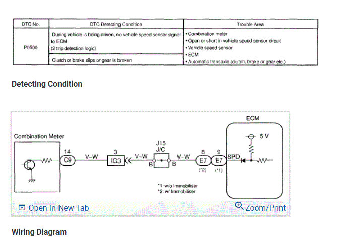

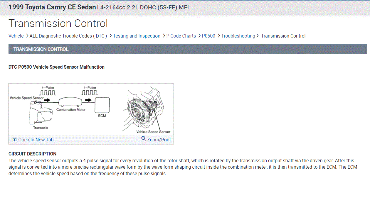

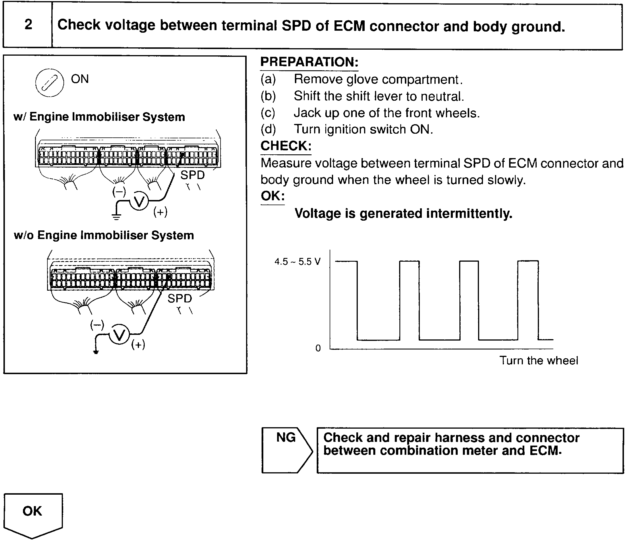

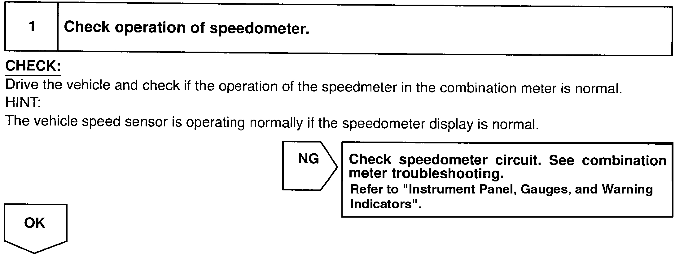

My car developed a problem upshifting and cruise control not working sometimes several months ago. Code is P0500 Speed sensor A. I changed the speed sensor and problem persists. The Speedometer is not malfunctioning and has worked perfectly throughout this before and after I changed the speed sensor. However if I disconnect the electrical connector from the speed sensor then the speedometer does not work at all-- stays at 0 MPH.

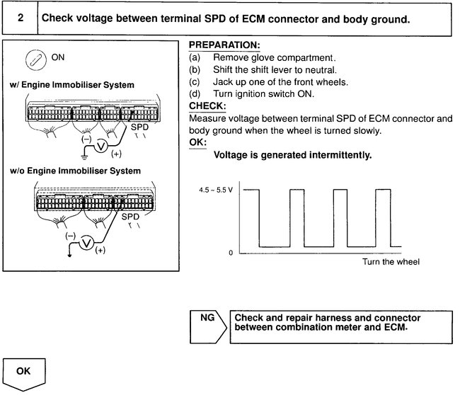

I saw a previous similar question answered by your experts that suggested a diagnostic algorithm. So I followed that.
Again speedometer is not malfunctioning. I took the instrument cluster out and inspected the wiring and connectors and they look OK. Next the algorithm said to
" Using DVOM, back probe
ECM harness connector. On models with engine immobilizer system,
measure voltage between ground and terminal No. 8 (violet/white wire) at
ECM harness connector E7. See Fig. 3 . On models without engine
immobilizer system, measure voltage between ground and terminal No. 9
(violet/white wire) at ECM harness connector E7. See Fig. 2 . On all
models, observe voltage reading while rotating front wheel. Voltage
should pulse between zero volts and 4.5-5.5 volts. If voltage is as
specified, replace ECM. If voltage is not as specified, repair open or short
in wiring between instrument cluster and ECM."
I assume back probe means stick the probe into the connector while it is plugged into the ECM ? I did not get the pulsing voltage as described, and the wire was purple but I did not see a white stripe.
The wiring and connectors around the ECM also look okay. Is it possible there is an open circuit in the instrument cluster so that the signal is not getting transmitted? I have attached the original question and answer I referenced.

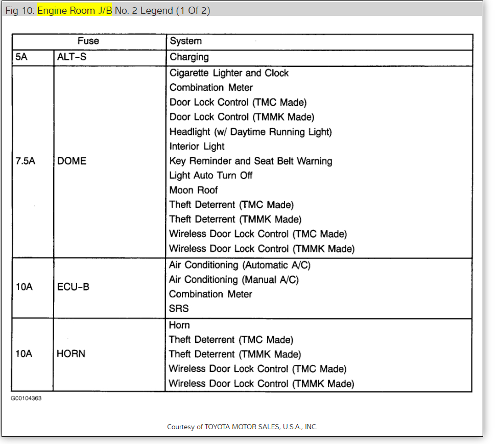

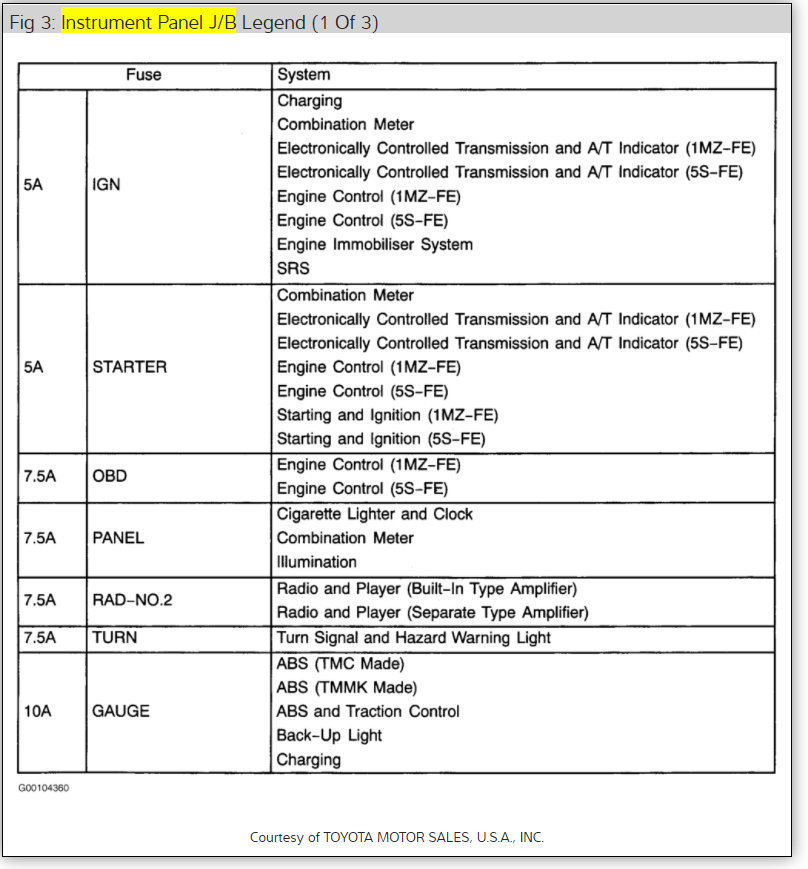

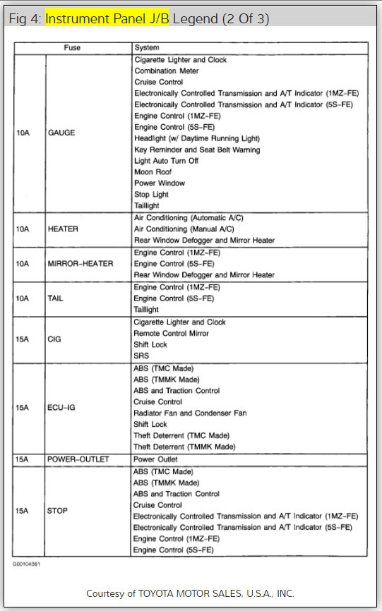

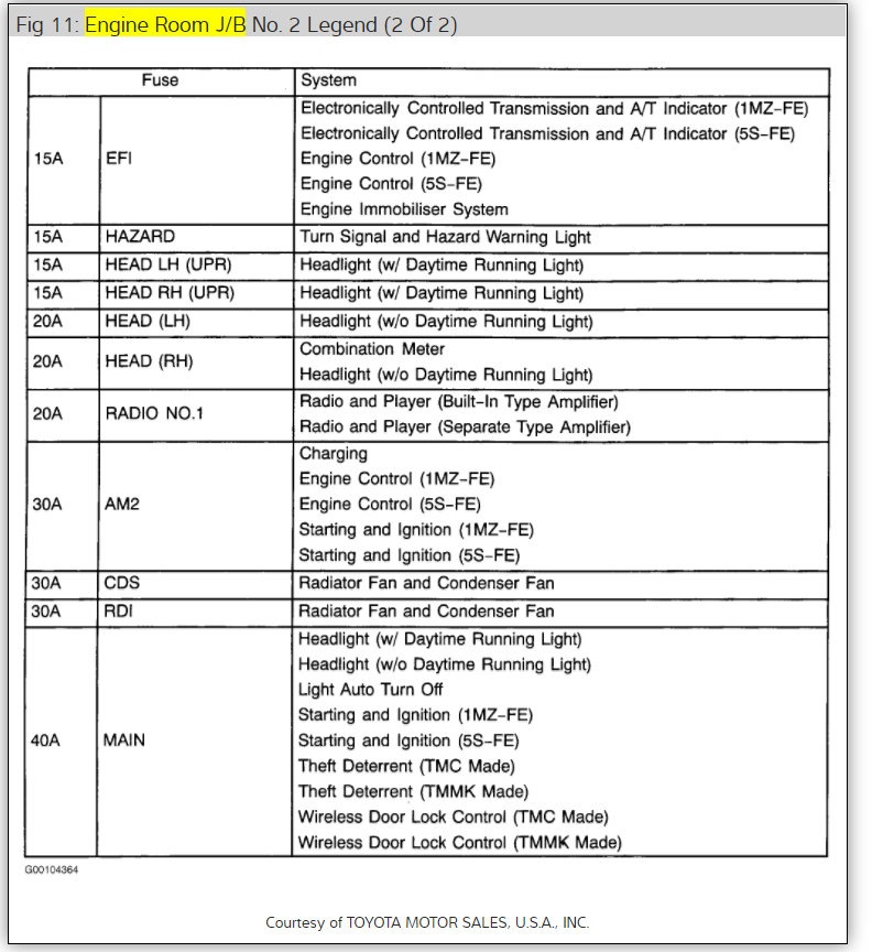

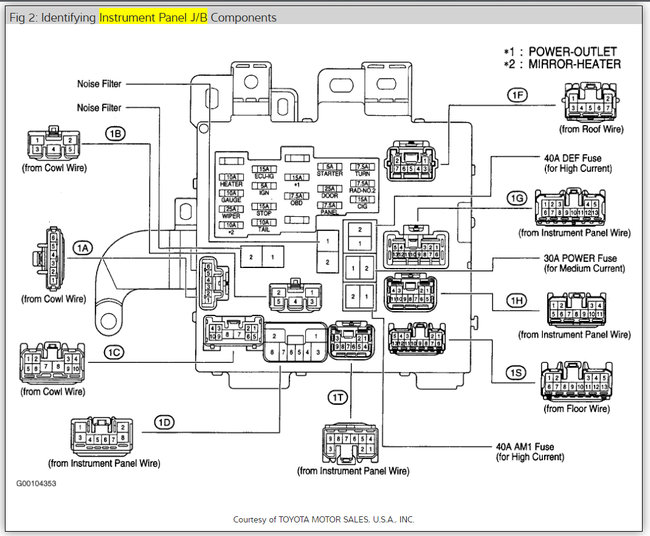

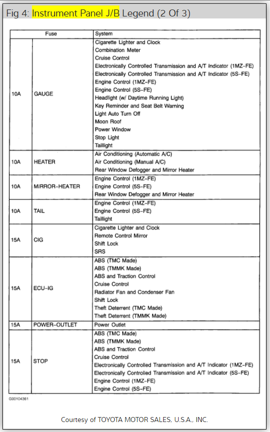

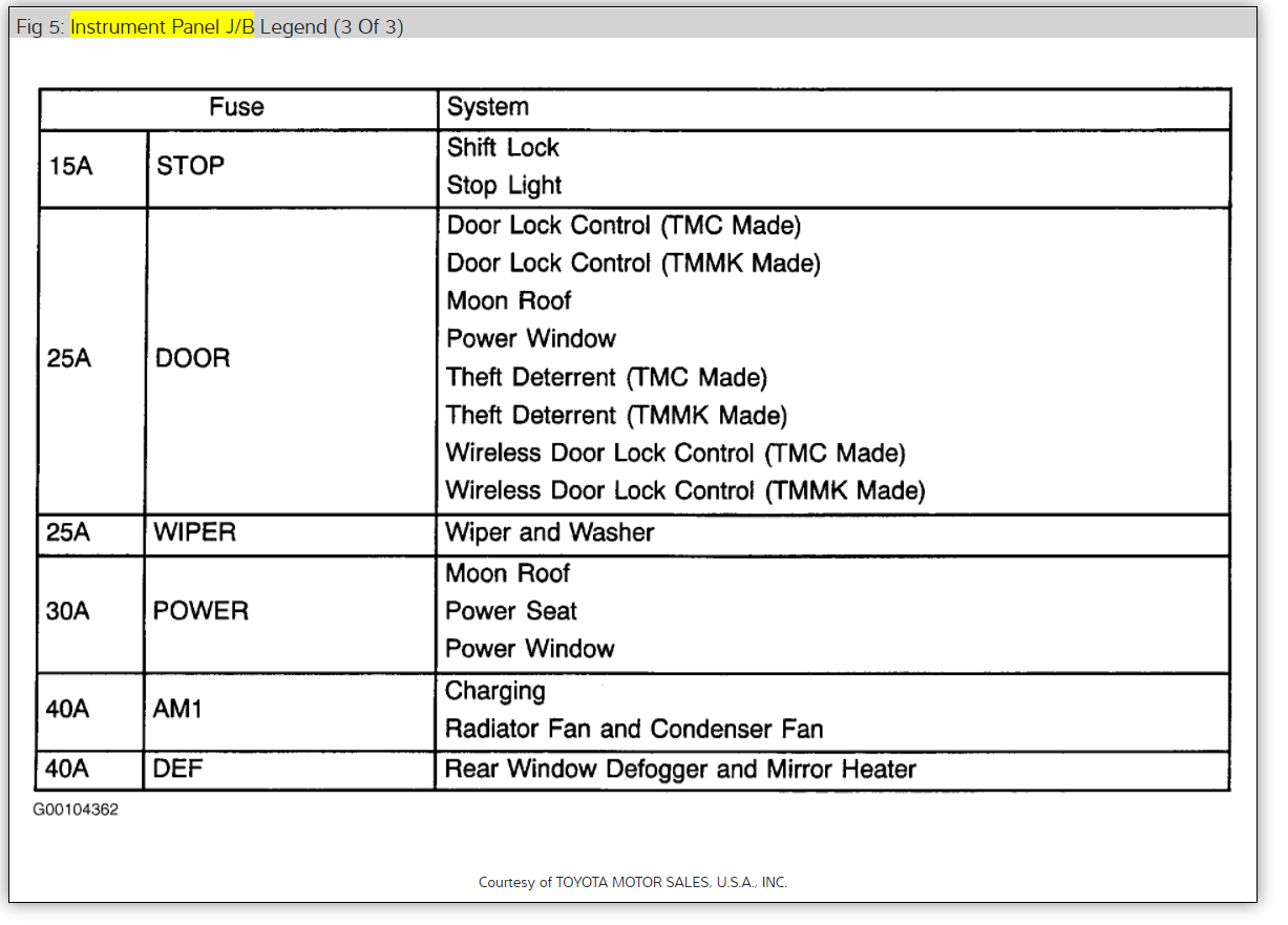

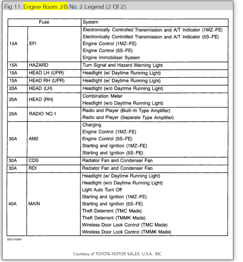

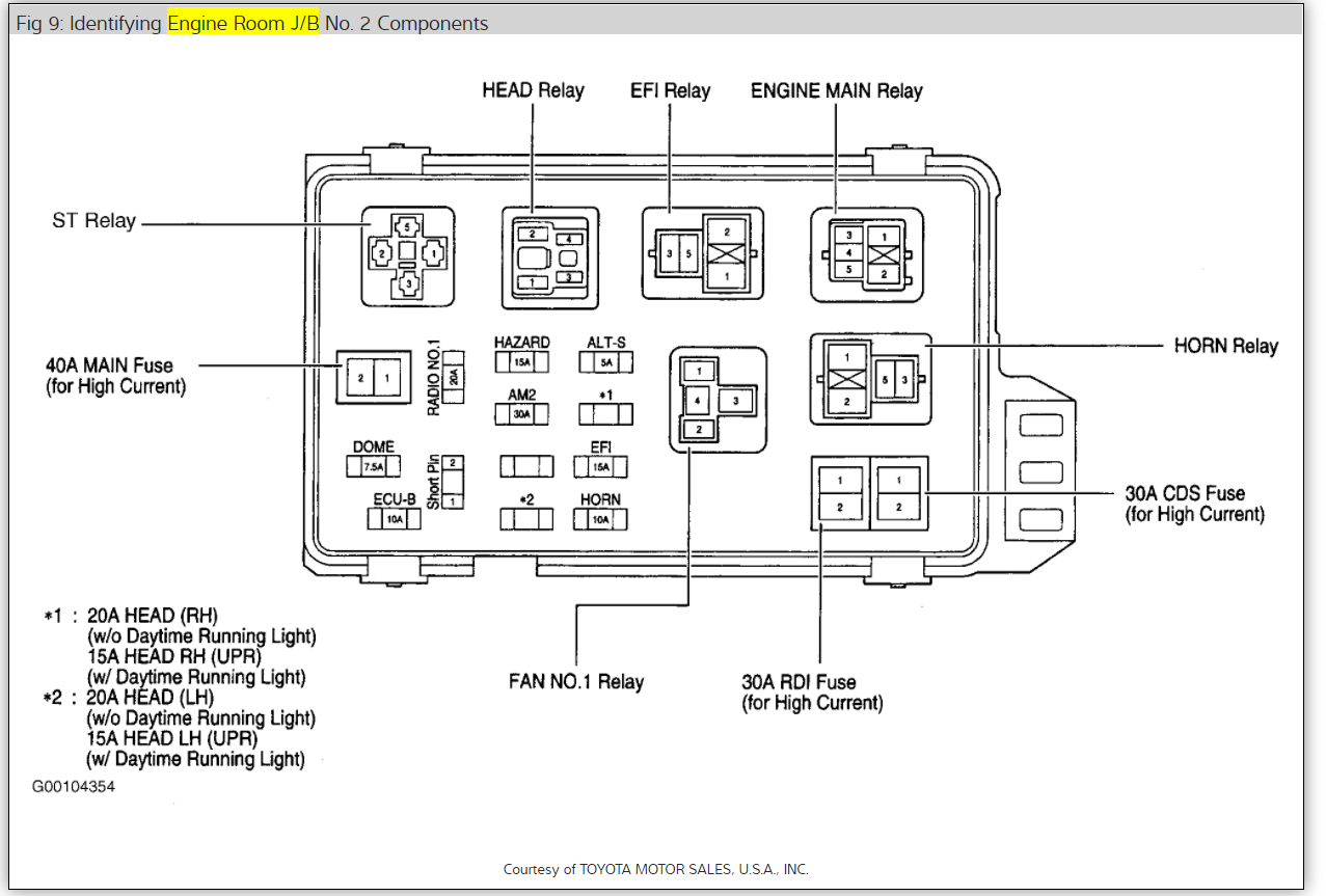

Next turn the key on and lets check all fuses. here is a guide to help with the fuse location in the diagrams below:
Mar 25, 2021 at 3:56 AM
BOBCONNORS1949
fuses are okay . As I said in the original post the speedometer IS working and has not been a problem both before and after changing the speed sensor . The only time the speedometer does not work is if I disconnect the electrical connector on the VSS on purpose just to test. It is the cruise control and transmission shifting that is the problem. So I suspect the signal is getting to the speedometer but not any further. The problem is after the speedometer. My understanding is that the VSS signal goes first to the speedometer and then over to the ECM which then sends the signal to the transmission and the cruise control.
Mar 25, 2021 at 6:06 AM
  • 55,721 POSTS
yep sorry about that, so the speedometer works and you have a code saying it doesn't when this happen the ECU is not monitoring the function and should be replaced. Here are instructions on how to do so. Check out the diagrams (below). Please let us know what happens.

Before I replace the ECU what do you think about the test described below ? It is from one of the experts at your site in response to a similar problem on a 1999 Camry.

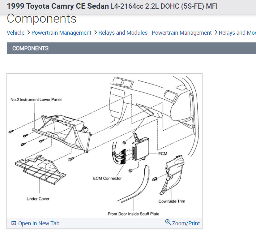

ECM harness connector E7. See Fig. 3. On models without engine
(violet/white wire) at ECM harness connector E7. See Fig. 2. On all
When I did this test there was no pulsing voltage at the specified connector . Does this mean the VSS signal is not getting to the ECM ? Thanks for your input.
Mar 26, 2021 at 2:33 AM
  • 110,248 POSTS

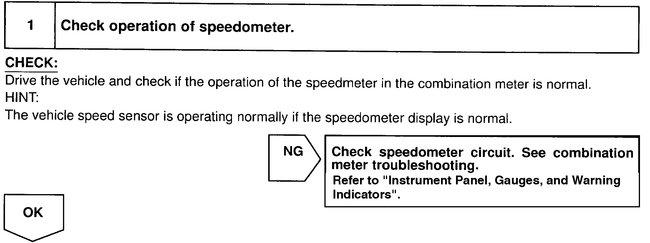

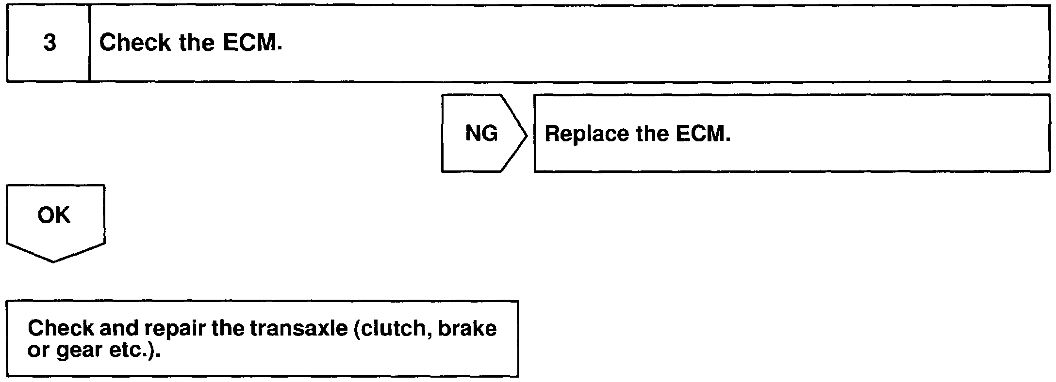

If you are not getting a signal from the VSS, either the sensor is bad (and I realize you replaced it) or there is an issue with the wiring. Have you checked for continuity between the VSS and the combination meter? Disconnect the VSS and the combination meter and check the VSS signal wire for continuity. Move it around to see if there is something broken or shorted.
If there is continuity in the wire, chances are it is the ECM. If you look at the attached pics, it shows a general diagnostic for the code you have.
Also, you are correct that the signal goes to the combination meter first and then to the ECM. Thus, what Ken expressed is likely accurate.
Let us know.
