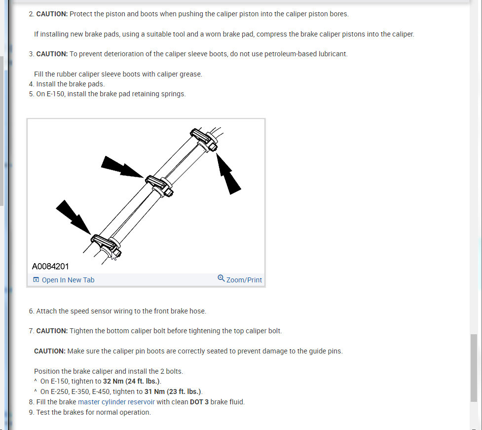

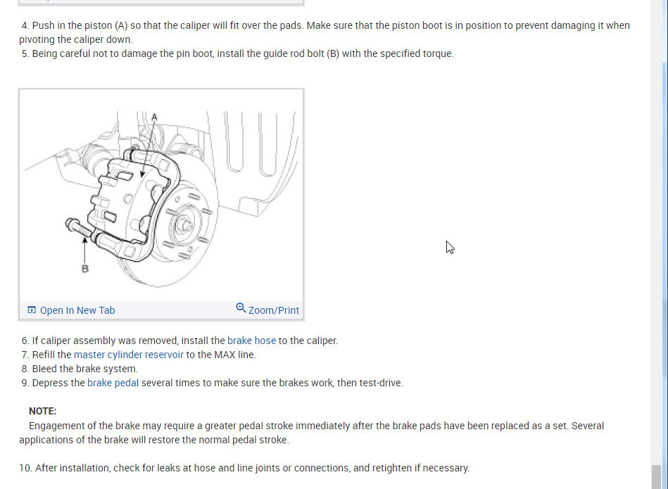

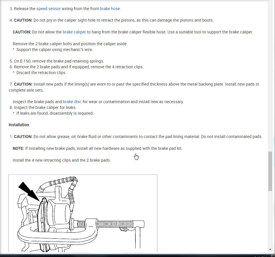

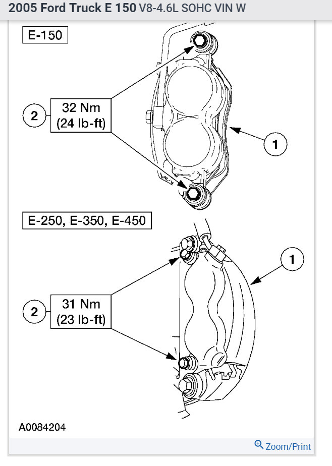

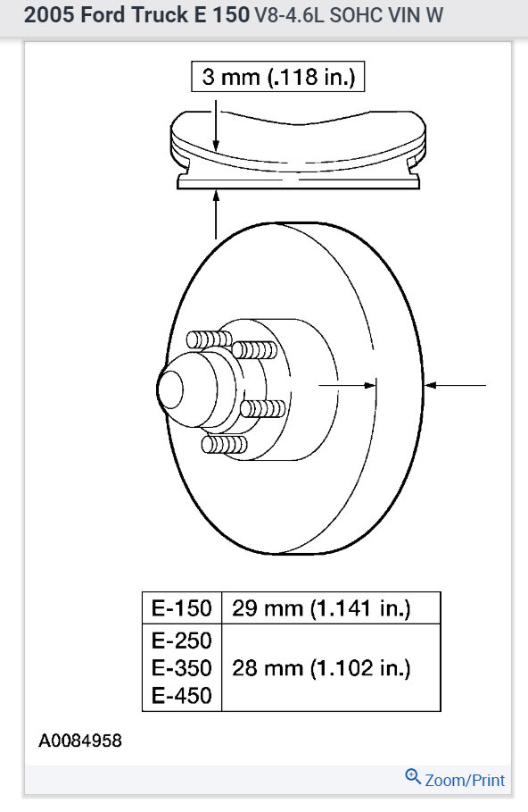

was told I need brakes
Jun 15, 2017 at 2:50 AM
Here are a couple guides that will help with this:
https://www.2carpros.com/articles/how-to-replace-rear-brake-pads-and-rotors
Plus here is a video on an F-150 that will be similar with the exception of backing the wheel bearings:
https://www.youtube.com/watch?v=Iv9mWLv9QLM

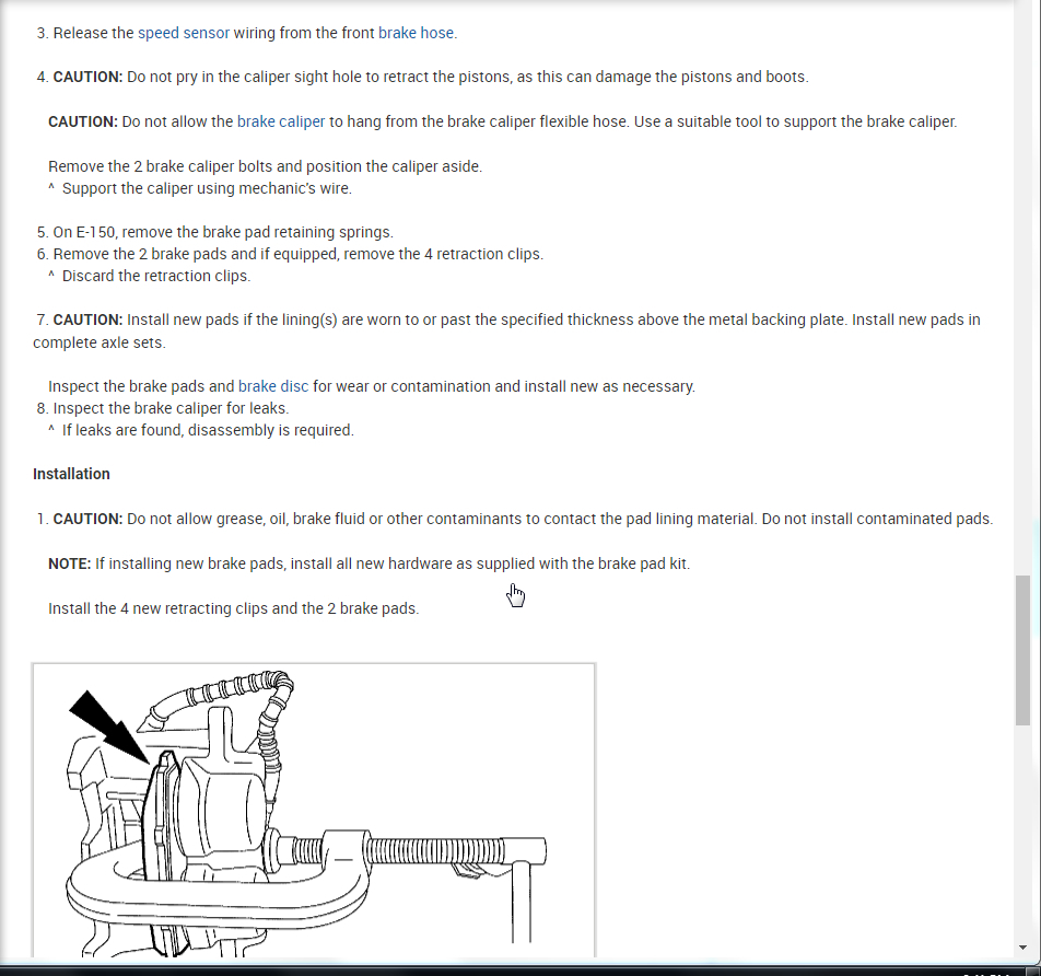

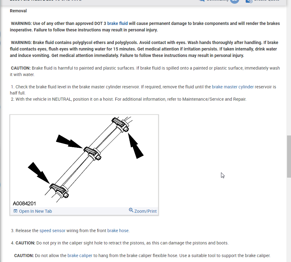

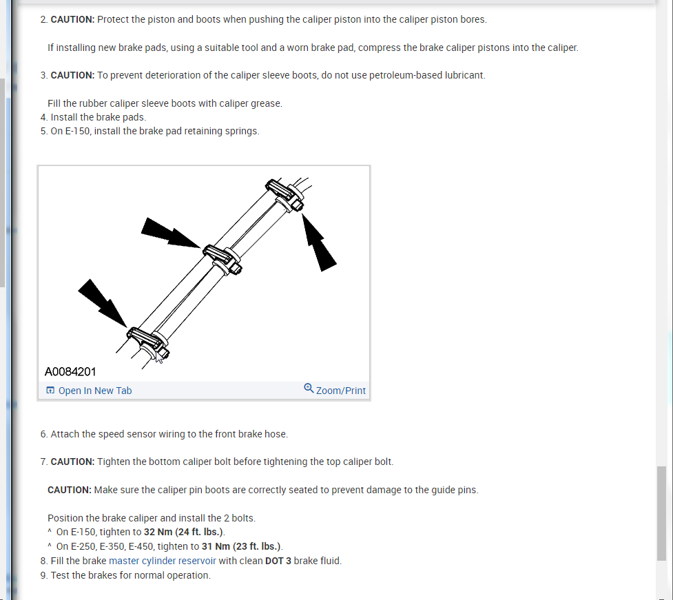

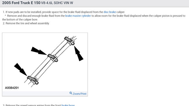

Lastly you will find the process from the manual below on how to do this on your van.
Let us know if you have questions. Thanks

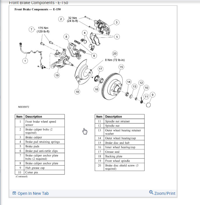

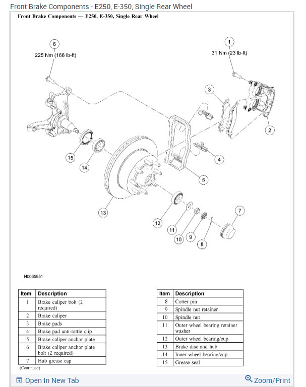

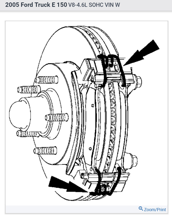

Here is a guide that will give you an idea of how to do the job with diagrams below to show you what it will be like on your car:
Cheers

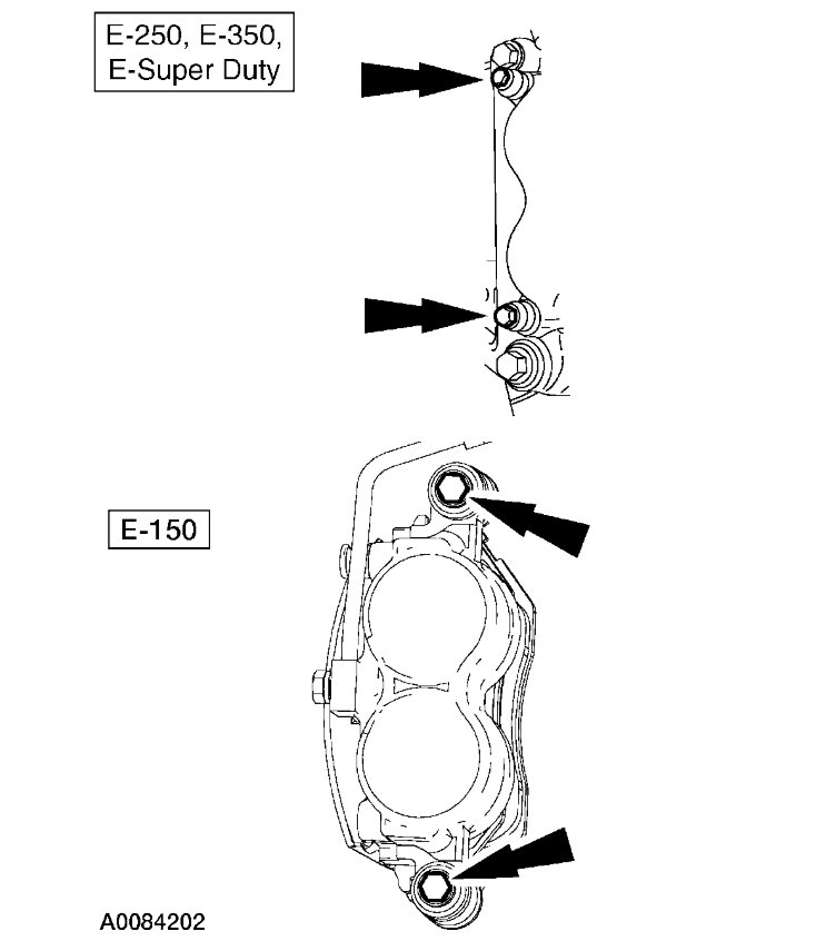

trying to get front brake pads off of 2000 ford e250 v8 tritoni already slid the caliper away from rotor looks like there is just a slide holding pads in i dont know how to get the slide off
Feb 8, 2021 at 5:18 PM (Merged)
WRENCHTECH
  • 20,761 POSTS
Just remove the 2 slide bolts and it should lift right off. https://www.2carpros.com/images/external/84838146.gif

DROLDS
Ford switched to torx head bolts maybe that's what threw him off.
