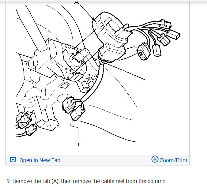

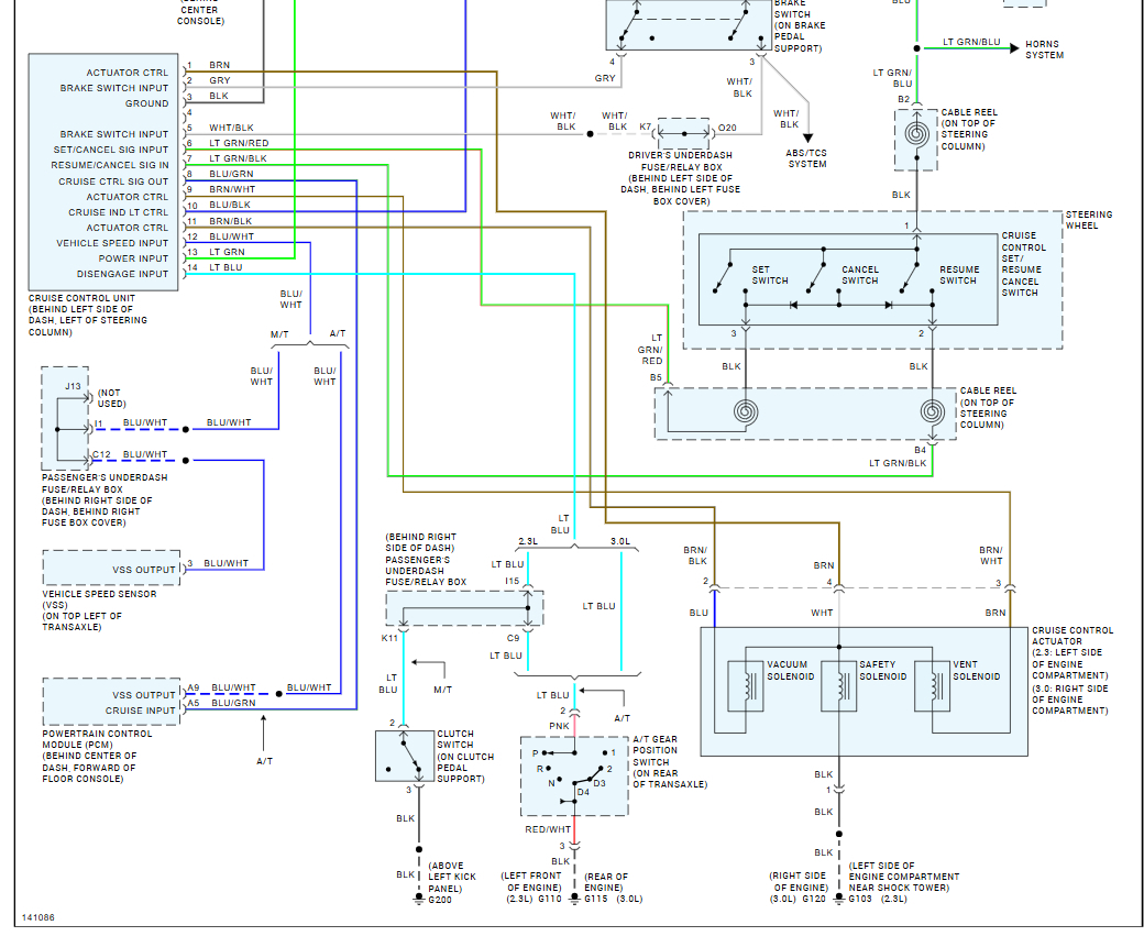

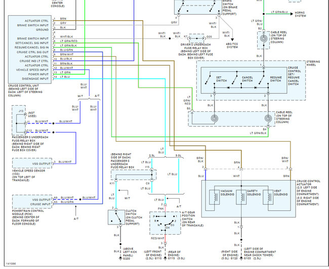

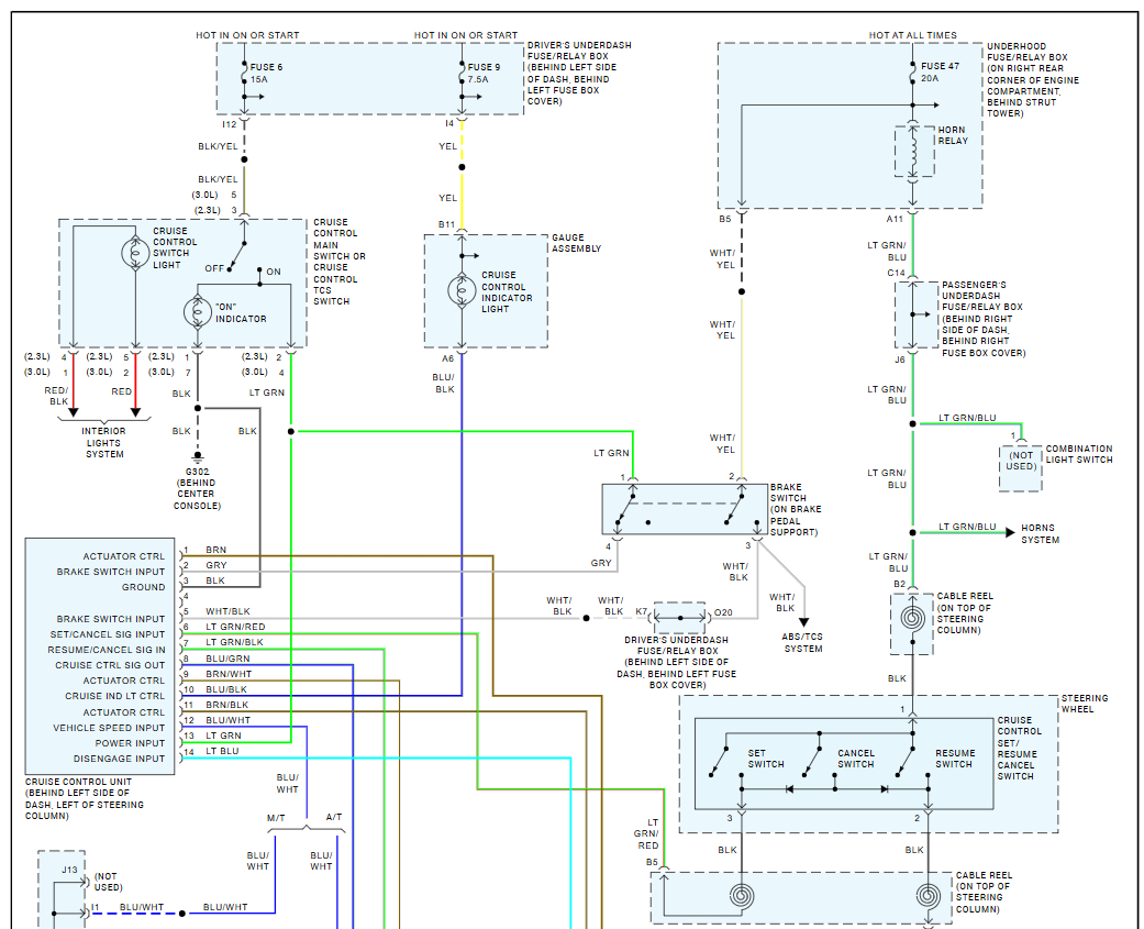

I have the car listed above coupe 2.3 L VTEC, and I have done the normal diagnosis for cruise control. The brake switch has been replaced. The fuses have been checked the main on off switch works. There’s vacuum going to the cruise control module under the hood, but I still cannot get cruise control to engage on my car and I am stumped at this point.
Nov 3, 2024 at 7:47 AM
  • 55,746 POSTS

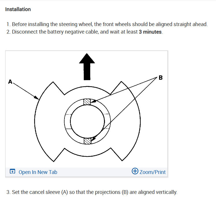

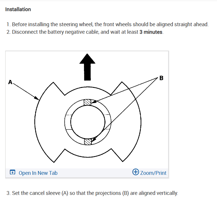

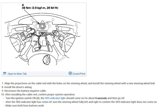

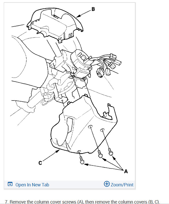

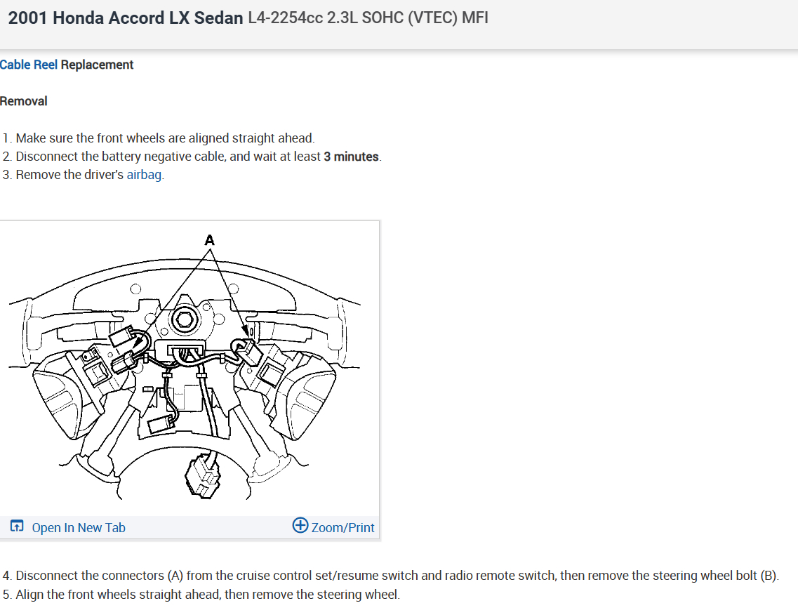

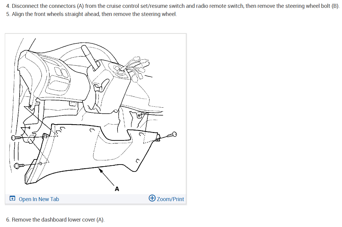

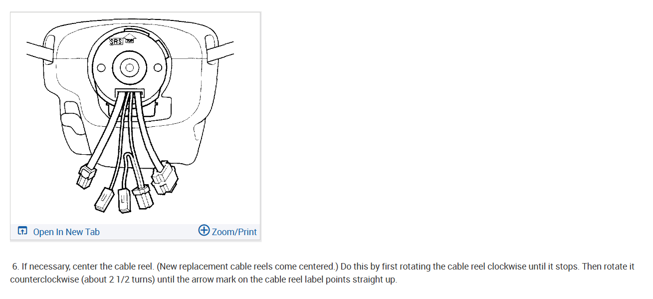

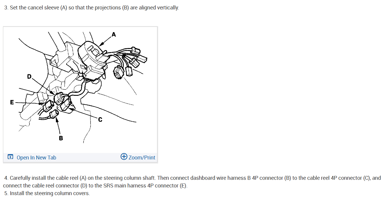

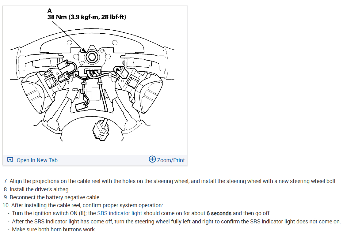

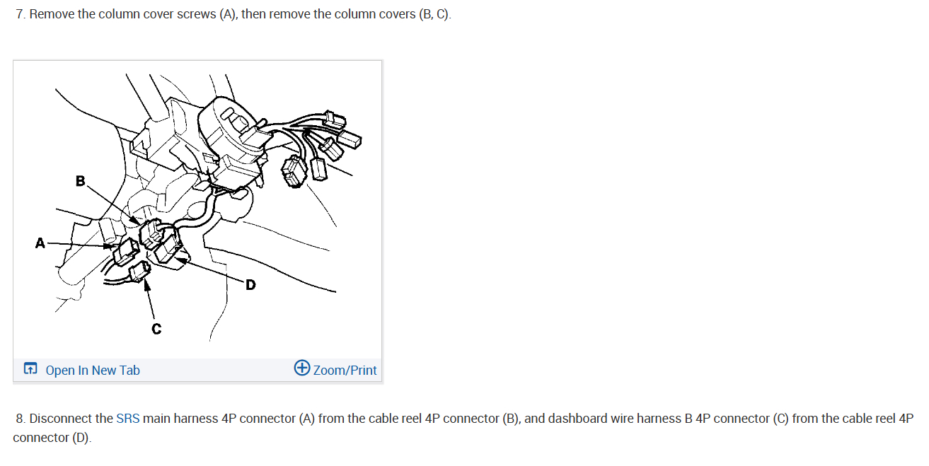

If the fuses are good and the ground to the cruise control module is good 9 times out of 10 it will be the clock spring under the steering wheel that has failed. Here are the wiring diagrams so you can see how the system works and which wires to test for power and ground. This guide can help, and I have included instructions on how to change the clock spring out which should fix the problem.
Nov 4, 2024 at 2:31 AM
JBURGESS88
  • 7 POSTS
Okay, I did follow that it did fix it. The clock spring needed replacing, but after fixing that a new issue has popped up the left turn signal does not always want to work when the headlights and parking lights are on but the moment I turn them off it works. I’m kind of thinking that falls back down to a relay because the multifunction switch or the multifunction stock for the headlights and turn signals, got replaced because I accidentally dropped something on it and broke it.
