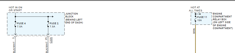

There are three fuses (4 and 2 dash fuse panel and 11 under hood fuse panel) that run the system which I have provided in the images below. This guide can help you test them for power as well:

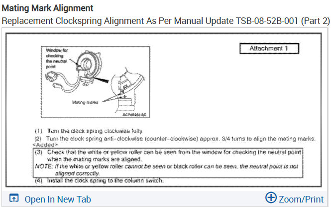

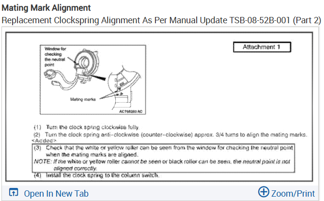

If the fuses are okay, I have seen the clock spring go out behind the steering wheel which will make the cruise control to stop working. Here is the part so you know what I am talking about. Check out the images (below). Let us know how it goes.
