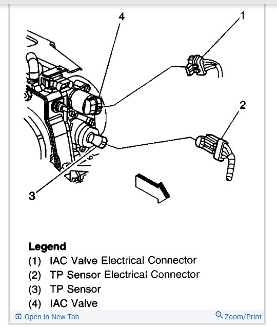

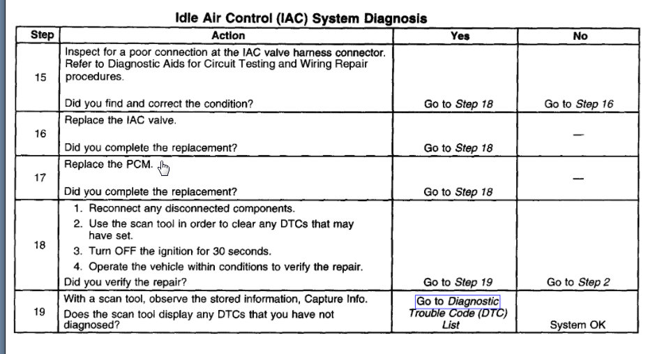

My car has developed an idle speed problem, before it was doing it only occasionally, where it would shut off if I took my foot completely away from the brake. Now it does it constantly, with an added problem: The Cruise Control will no longer engage. The light on the "on/off" switch turns on to show that it is at least active, but when I try to set my speed, the car ignores it. Are the two problems related? Losing my cruise control isn't a deal breaker per se, but the idle speed is an issue I have yet to get taken care of (other things have gone out on the car that required more immediate attention, like an alternator I recently replaced and a cracked wheel that failed and took the tire with it).
What are my possibilities?

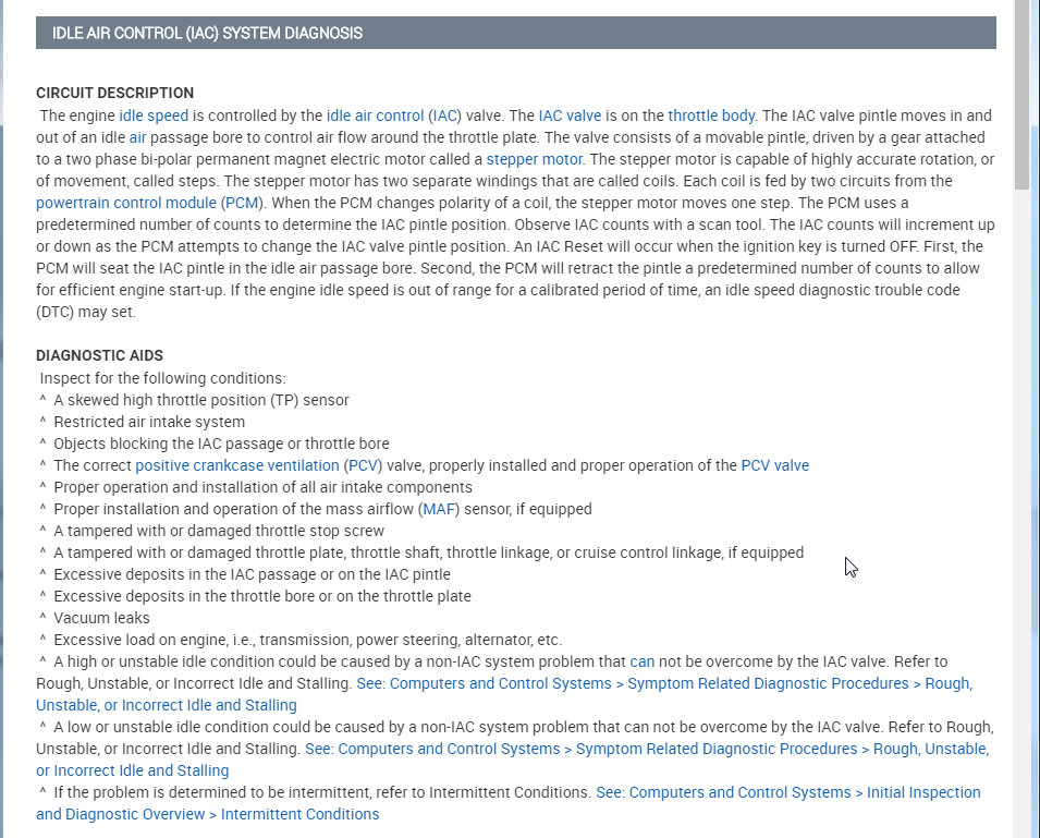

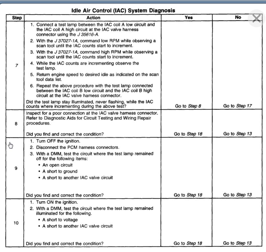

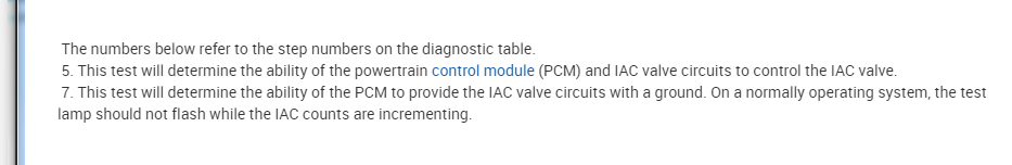

Lets address the idle issue and go from there.
This sounds very much like an IAC issue. Here is a guide how to clean it:
https://www.2carpros.com/articles/idle-air-control-valve-service

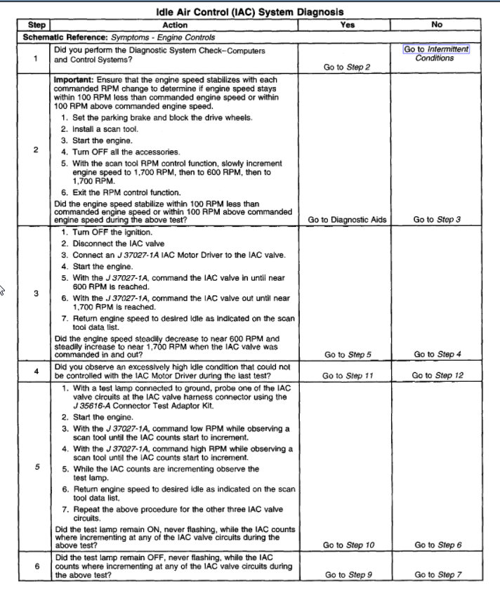

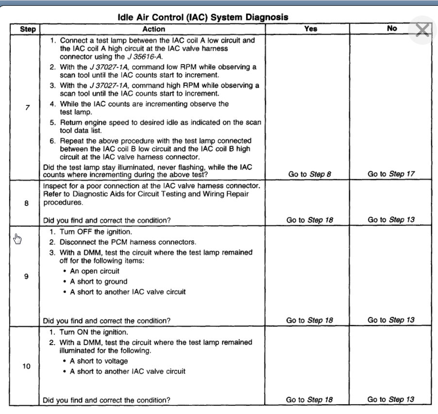

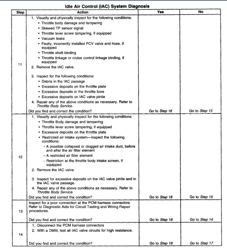

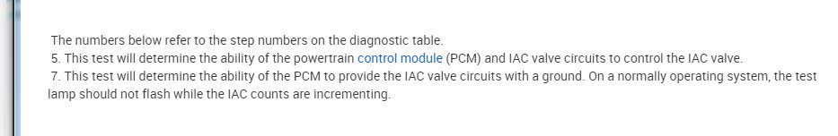

However, I would recommend running through this test just to confirm this is the issue but I am pretty sure it is .
Let us know what you find and we can go from there. Thanks
