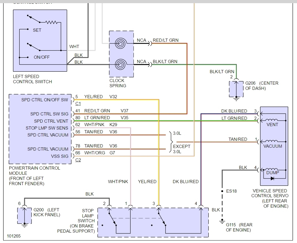

Cruise control stop working. green light will only come on when ignition switch to start. all brake lights work. green light will not come on while moving.

HMAC300
  • 48,601 POSTS
check brake switch yellow wire to see if it sending a signal to PCM if it does the switch should only work when brake is applied then check for a bad clock spring in steering column.

WILLYIMAC
How do you test clock spring or do you just replace mine/ started making rubbing noise I think there is still factory recall.

HMAC300
  • 48,601 POSTS
the recall is for only certain cars you have to check with a dealer on clock spring. also, if over 70,000 miles it is a limited lifetime warranty.

WILLYIMAC
I have 1998. I will change if it is dysfunctional will not repair if working and no airbag lights on. on to checking yellow brake wire.

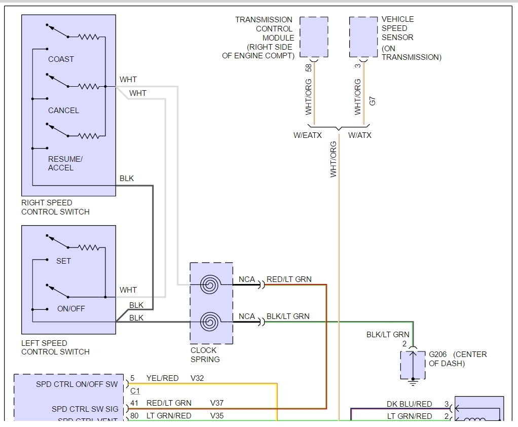

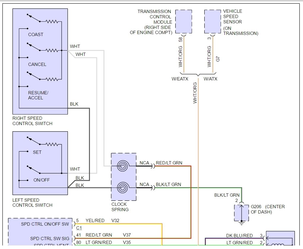

  • 55,423 POSTS
Hey WILLYIMAC,
I found this wiring for ya to assist in the troubleshooting with Hmac, hope it helps.
Please let us know what you find so it will help others.
Best, Ken
