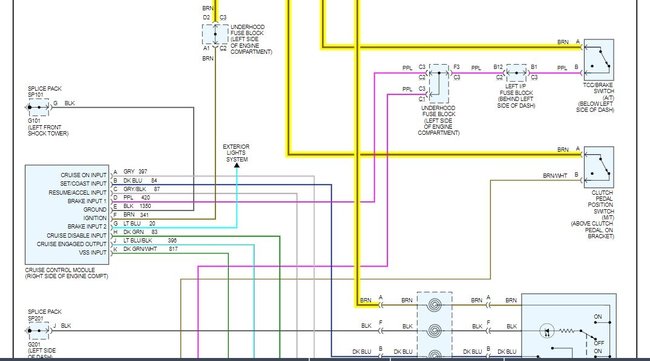

Cruise doesn't come on when I push the set button below airbag to set speed from 35 and up. Checked relay and fuses are good. Could it be brake light/cruise switch? How would I check that switch without scan tool and how would I adjust it. Thanks

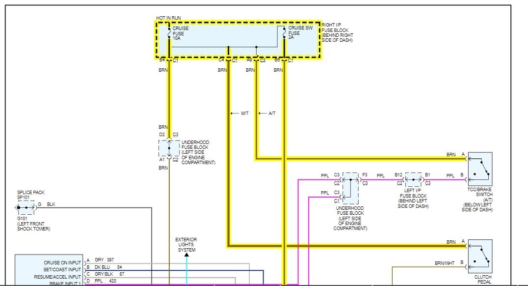

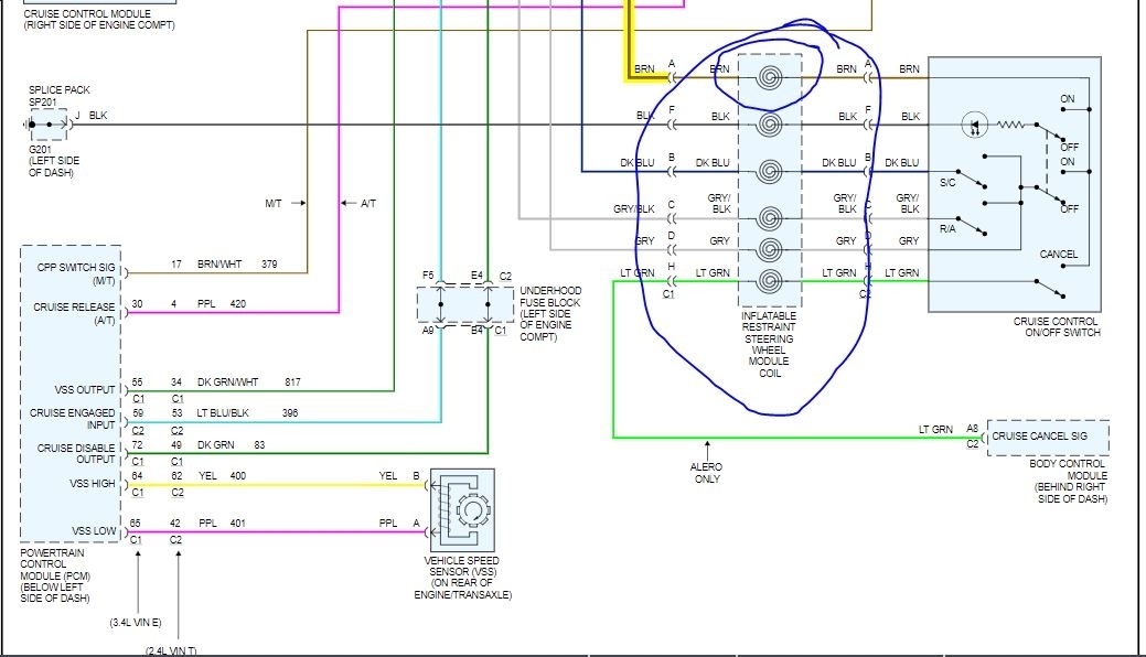

I attached a wiring diagram for you to view. check the fuses for power on both side with the key on.
Also, check the brown wire for power at the clock spring to be sure the switches have power to the steering wheel.

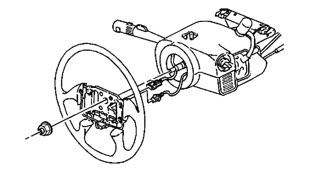

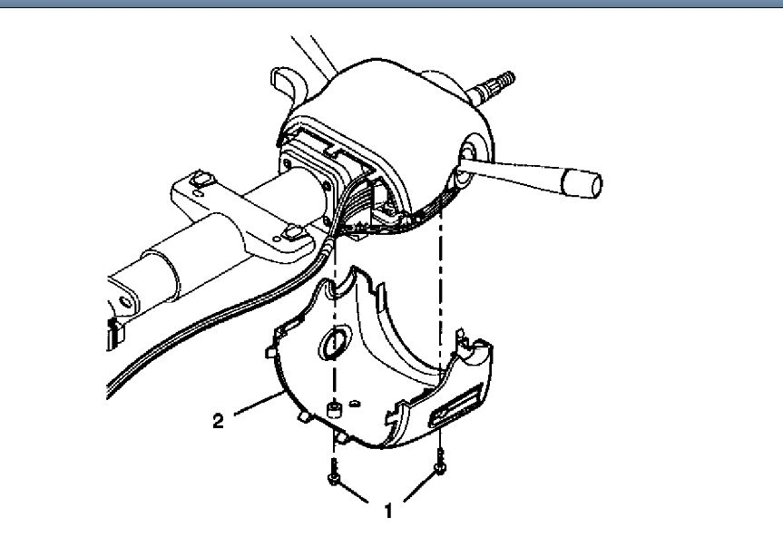

REMOVAL PROCEDURE
1. Disable the SIR System. Refer to SIR Disabling and Enabling Zone 3.
CAUTION: Refer to SIR Caution in Service Precautions.
2. Remove the inflatable restraint steering wheel module.
3. Remove the steering wheel nut.
4. Note the mark on the steering shaft and the steering wheel to ensure proper alignment during installation.
5. Remove the steering wheel from the steering shaft.

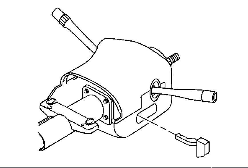

6. On vehicles with a tilt column, pull the tilt lever straight out from the steering column.
7. Remove the tilt lever assembly.

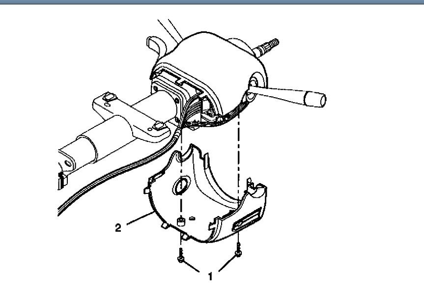

8. Remove 2 TORX(R) head screws (1) from the lower shroud (2).
9. Remove the lower shroud (2).

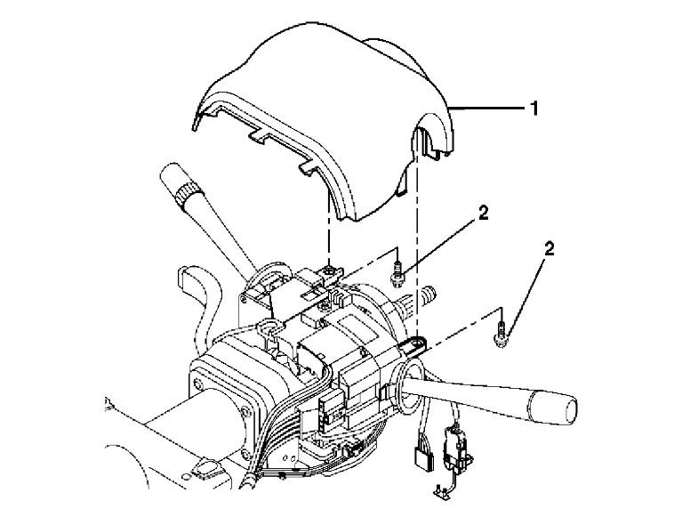

10. Remove 2 TORX(R) head screws (2) from the upper shroud (1).
11. Remove the upper shroud (1).
12. Remove the wire harness straps from the steering wheel column wire harness.

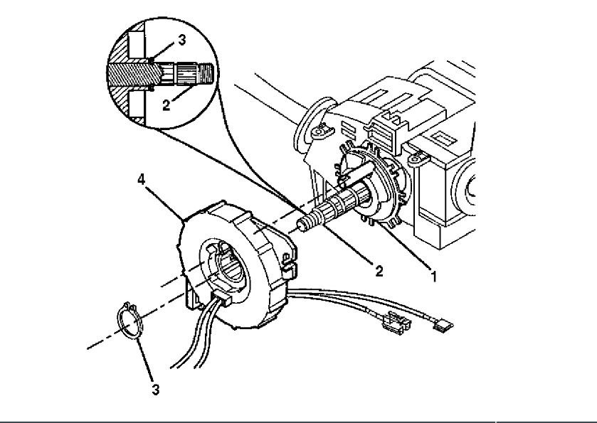

13. Remove the retaining ring (3).
14. Remove the SIR coil (4) from the steering shaft.
15. If replacing, discard the SIR coil.

I replaced clock-spring before thinking that was issue turned out it wasn't. Cruise worked when it wanted. Now doesn't at all. Fuses good and relay. My car doesn't have a clutch it's automatic. It has cruise switch and the other is the brake switch. How do I test the cruise switch without scan tool and how would I go about adjusting it.
May 14, 2020 at 10:23 AM (Merged)
Good morning again.
Did you check the fuses for power and check for power to the clock spring as in the diagram I sent you?
