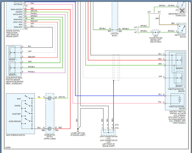

The cruise control light has started staying on even when it's not actually "on" and the "set" light has started blinking. I have absolutely no idea what this means.
Oct 6, 2021 at 2:47 PM

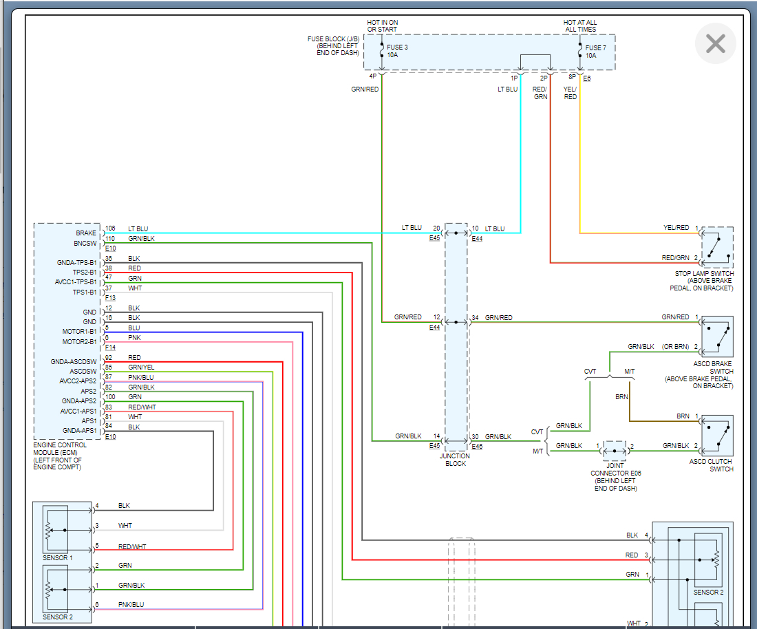

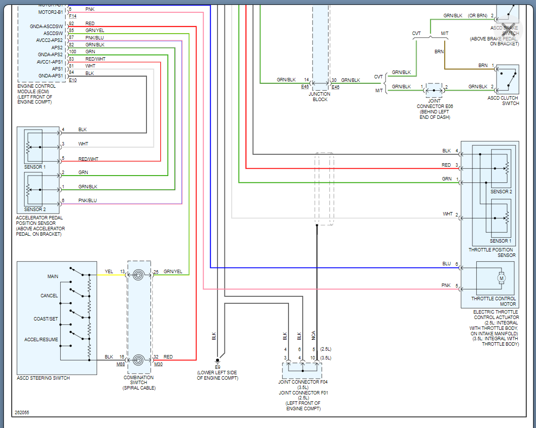

This means there is an issue with the system, and we need to start with checking for codes.
This could be as simple as a switch issue, but it could also be an open circuit in some of the wiring.
Once we know what codes are there, then we can figure out the next steps, but I am including the wiring diagram which includes all the components for us to start checking.
The most likely cause of this is an ECM or actuator issue but again, we need to start with codes to find out the correct testing to start with.
Let me know what you find, and we can go from there. Thanks
